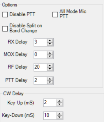

Rich,
Don't the following software options currently control the RCA jack?
Posted: Mon Sep 27, 2021 3:56 pm
by NC3Z
Mark, that only disables the PTT in line on the Mic connector. TUN and MOX and 2TON still drive the RCA jack if this is checked.
Best bet is to use the new OC pins feature.
Posted: Mon Sep 27, 2021 3:58 pm
They insert delays and stuff into TX/RX switching, but do not de-couple the PTT Out RCA from TX.

Got it, thanks for clarifying.

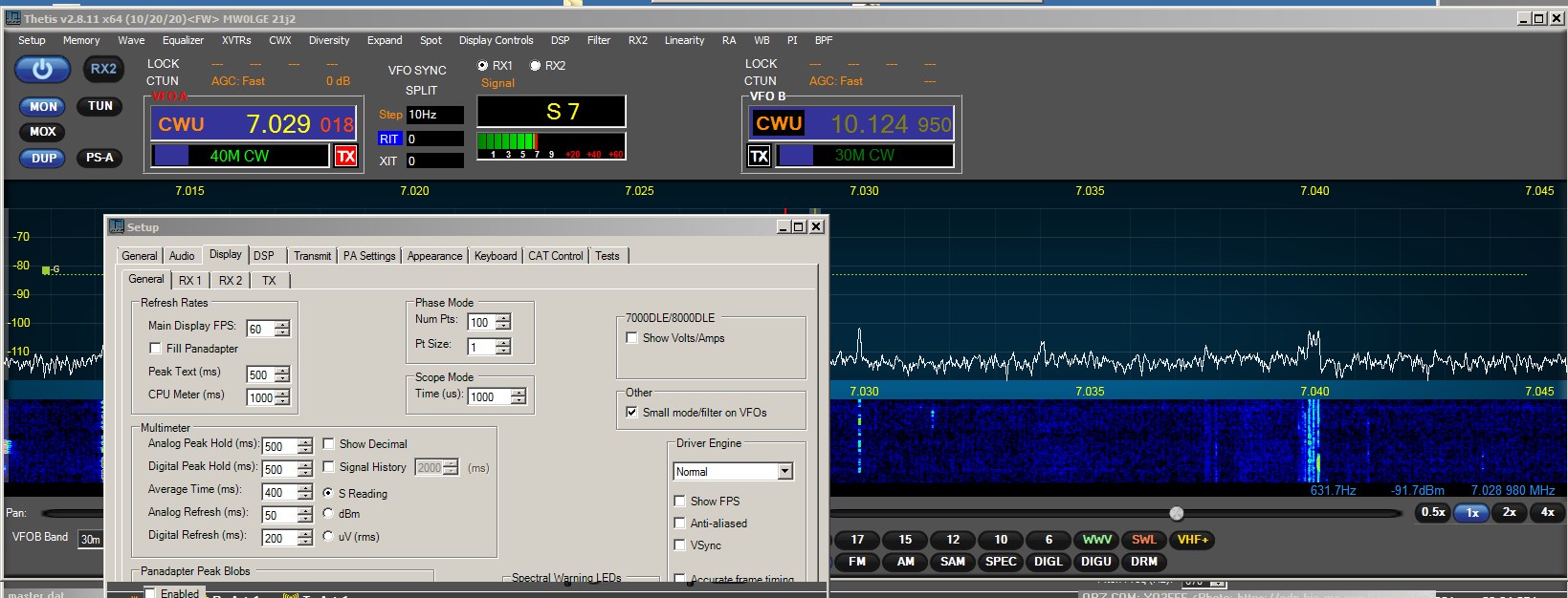

Hello.
I use "Andromeda Top Controls" screen with midi console. All is perfect. I'm missing only the filter value in this window.
Gintas

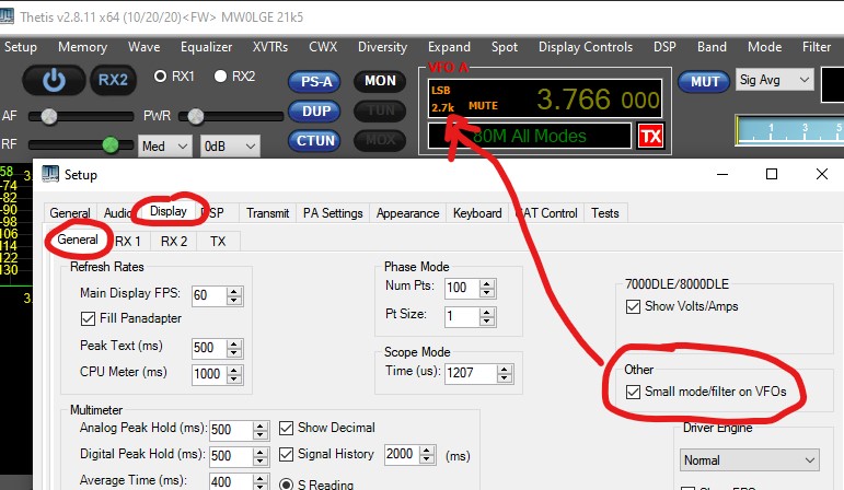

LY3G wrote:Hello.
Gintas

ah sorry, they do not display with the adromeda top controls. I had top controls turned on, which is different to adromeda top controls.

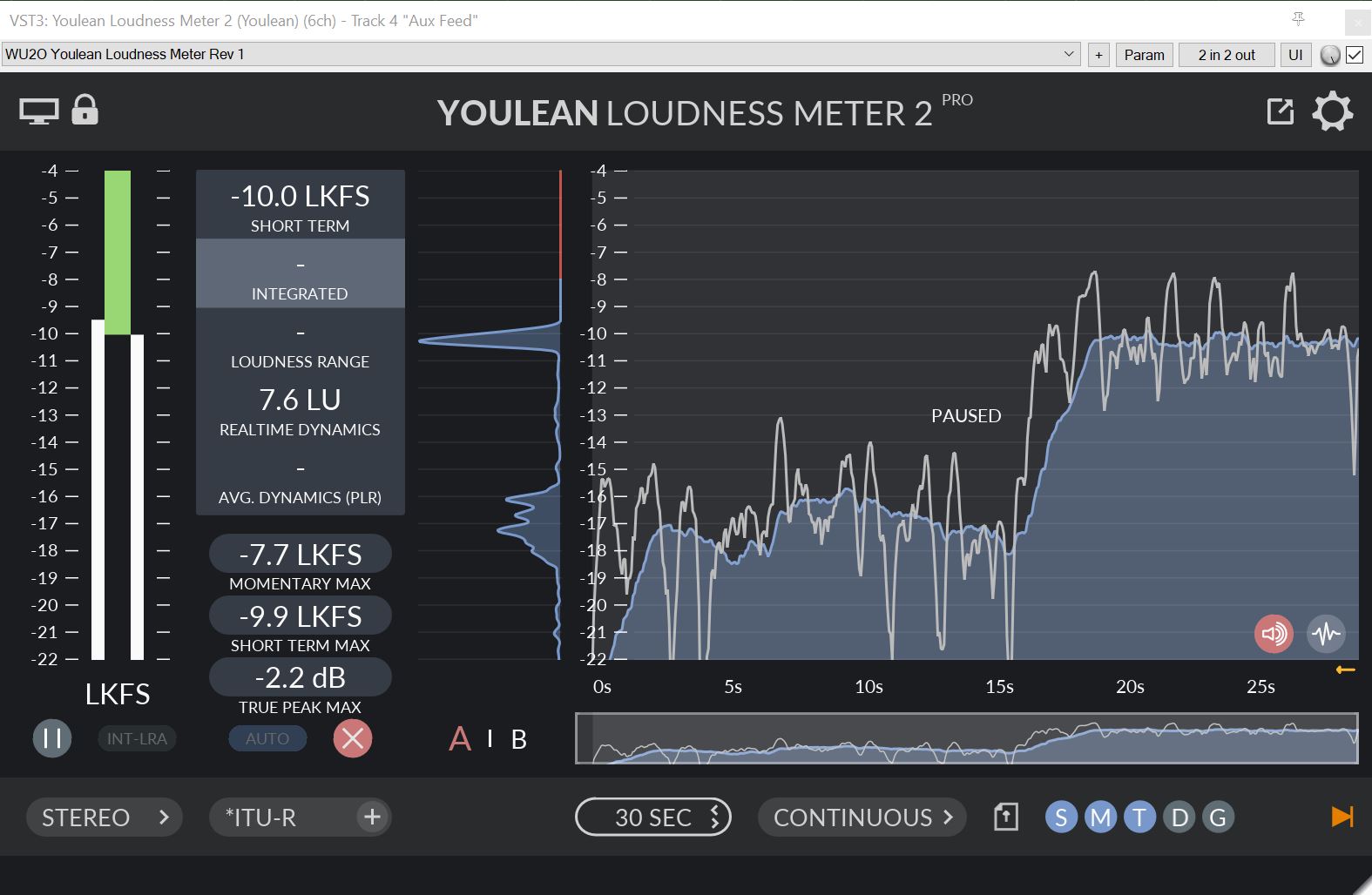

Posted: Tue Sep 28, 2021 7:25 pm
Interesting! I had noticed this before but never paid it much attention. Like Mark, I leave NR2 engaged 100% of the time. I know that some AM purists don't like to do this because they feel the NR2 artifacts change the character of the sound, and they do. But like Mark, I much prefer the sound of NR2, even on high SNR signals. For me it is far less fatiguing.
However, to Chris' point, this is a real thing. I tried the DC block option to see if it would cause a difference but it does not. Turning off NR2 and all other processing, it can be seen that the difference is essentially 6dB. In this example, I tuned an AM broadcast station, zero beat, 10KHz passband on AM/SAM, and 5KHz passband (40 to 5100Hz, actually), stock Medium AGC setting, and made the following graph. The first 15 seconds are in SAM (and AM appears the same), the latter 15 seconds in LSB.
The question, of course, is does this really matter? Surely you would want AGC to account for the energy in the AM carrier, no?

Nice measurement, Scott. I would have guessed the difference was more like 3dB. Interesting.
