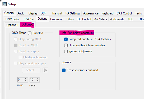

The colours? the Feedback? my dev environment database.xml gets changed hourlyW4WMT wrote:Hi Richie,
In your video above, it appears the PureSignal indicators in the info-bar have reverted back to the old way of doing things?
Bryan
