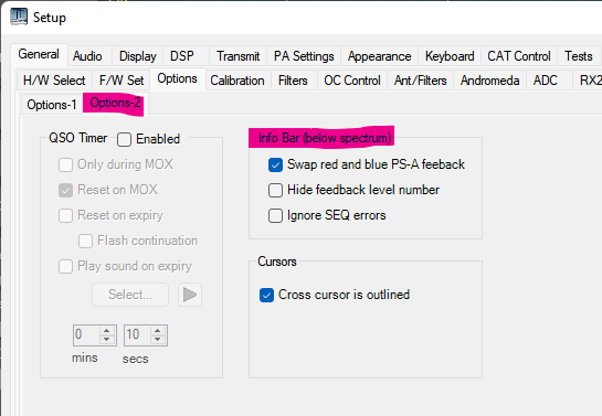

In your video above, it appears the PureSignal indicators in the info-bar have reverted back to the old way of doing things?
Bryan
Posted: Sat Apr 09, 2022 4:15 pm
W4WMT wrote:Hi Richie,
Bryan
The colours? the Feedback? my dev environment database.xml gets changed hourly :D I didn't check whole vid, but PS-A is off, and they are greyed out. Oh, and you can expand/shrink by dragging that vertical white bar left-right, up to 30% of infobar width.
