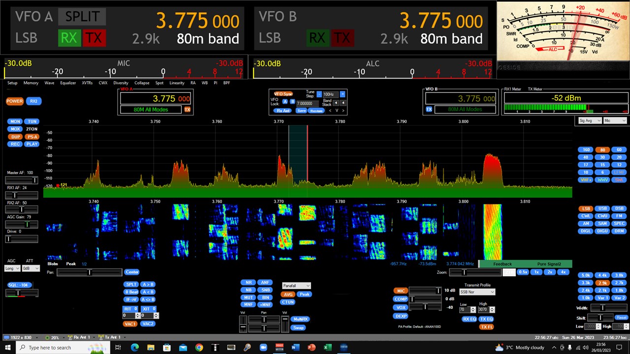

Here is my attempt

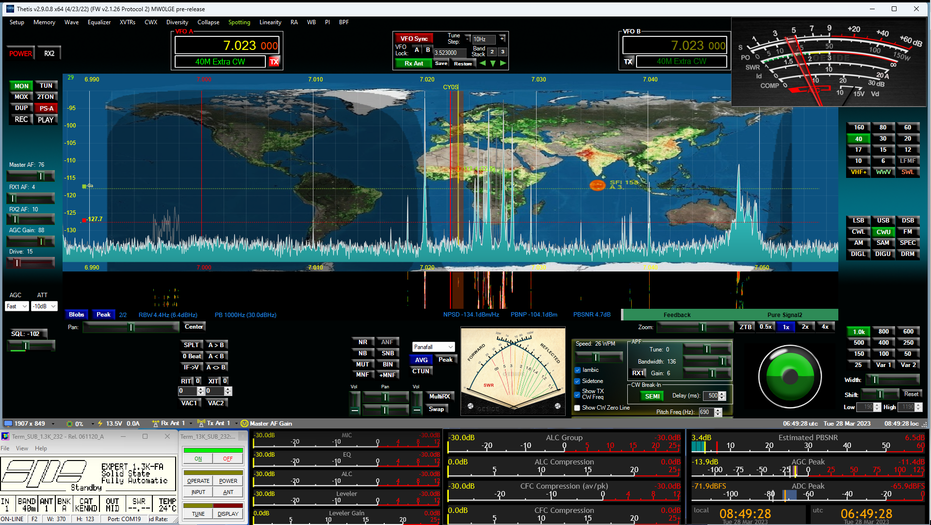

Here is my layout. Its a joy everyday when Thetis comes alive.
- Thetis-v2.9.0.8.x64.png (1.37 MiB) Viewed 26989 times

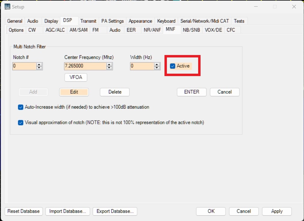

Erik,
Do you have the Active box checked?

Hi Mark,
Yes, the notch appears to be active - visually, but no affect on the audio. Also, I can drag it on the panafall.
The width is set to 200Hz, so it should be easy to cover the carrier, especially at 4x magnification.
73 de va7qi, ....Erik.

I'm a little confused by your answer. I asked if you had the Active box checked but you didn't exactly answer that question, you simply said "the notch appears to be active".
Please verify that the Active box is checked for the specific notch filter you're testing:

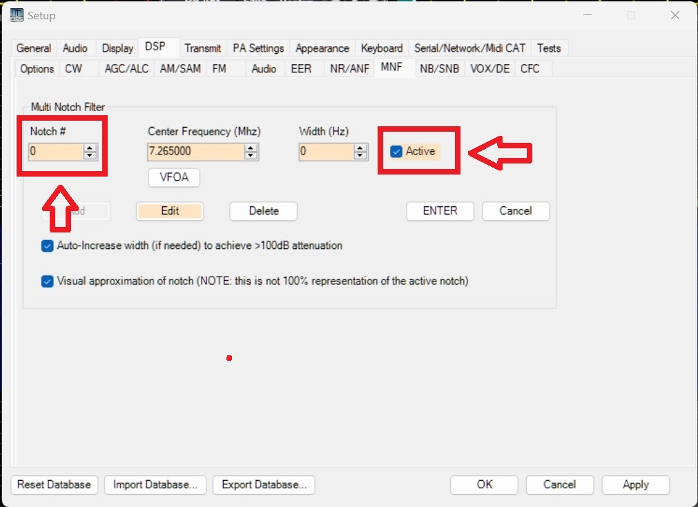

Hi Mark,
Well, the "Active" box is checked as is the "Notch #" (=0), so I guess that means the MNF is active. If the Active was not checked the notch would not show on the panadaptor.

Well wonders do happen, MNF is now working!
Keep in mind that I use Andromeda and therefore normally use the collapsed display. The quick menu at the bottom has an "Add MNF Notch" button. When tapping that, the MNF display does indeed show up on the display, but the notch is not actually started. I had to dig out another button "MNF" to actually start the notch function.
Perhaps I am the only one confused about how this is supposed to work, but I will start working on an addendum to the Andromeda user guide in order to collect some of those little - perhaps less intuitive - aspects of Andromeda.
