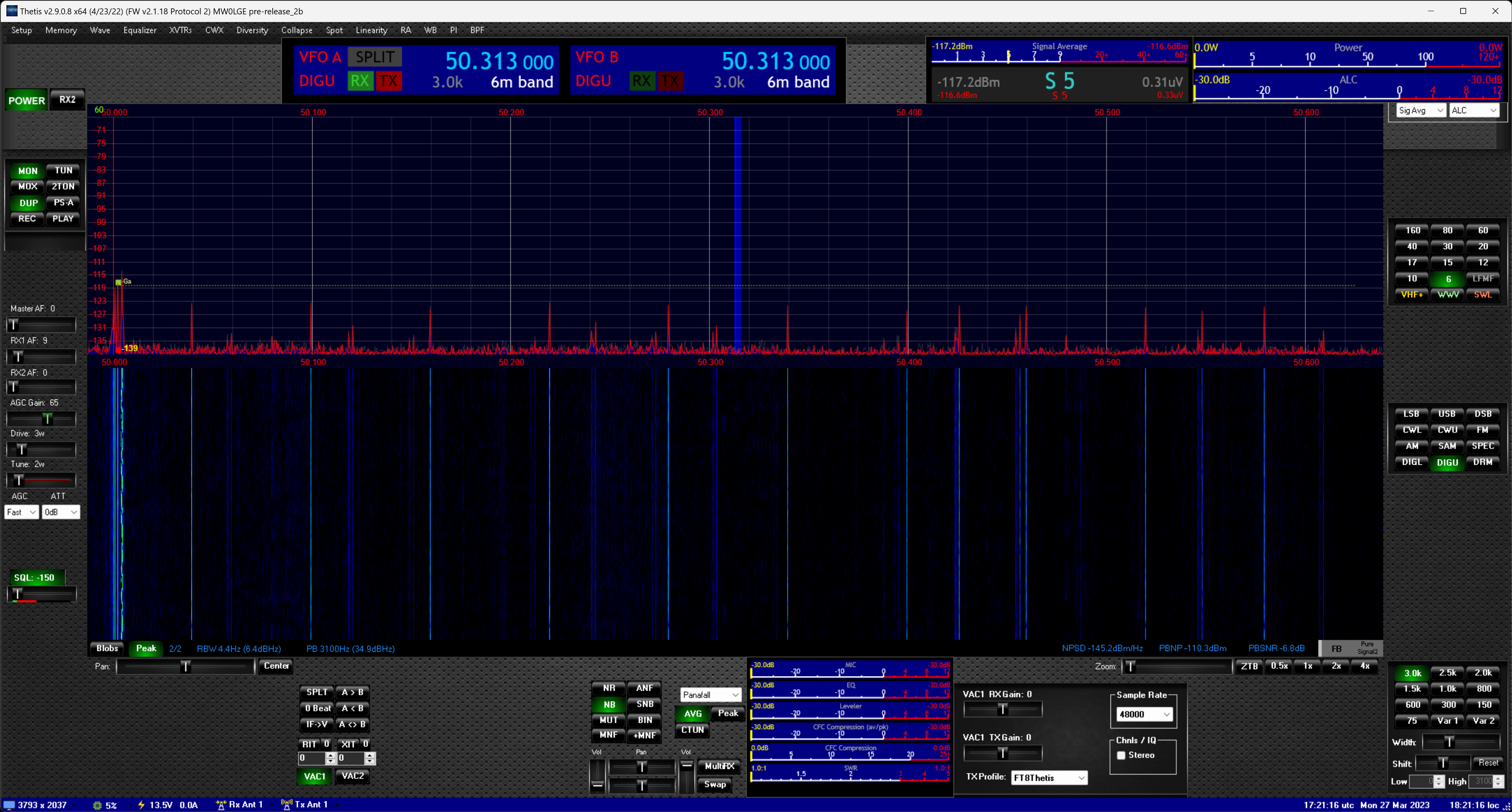

Here is my attempt
Thetis meters.png (4.39 MiB) Viewed 26926 times

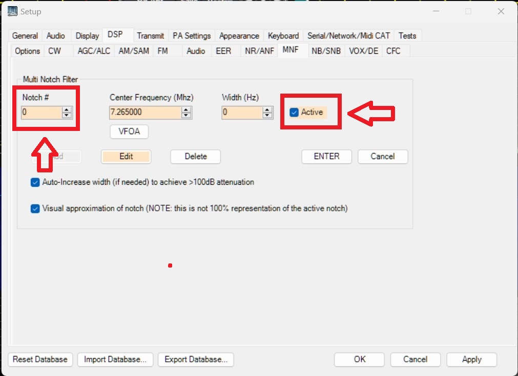

Back to the Manual Notch.
I had it working around the end of March. Then the carrier disappeared, but now it is back and the MANUAL NOTCH DOES NOT WORK. It displays OK, but does not do anything to the carrier.
I have re-loaded the firmware (V2.1.26 Protocol 2) and re-installed Thetis (2.9.0.8). I also tried to reset the database.
Running on a stock Andromeda (other than the updated firmware) with Windows 10.
I am tearing the last bit of my hair out, but to no avail. Everything else seems to be working. The auto notch works, but of course the S-meter now shows the level of the unwanted carrier, so I would really like to have the manual notch working again. What should I look for next?
73 de va7qi, ....Erik.
Re: Thetis v2.9.0.8 - meters and then some more
Posted: Sat Apr 08, 2023 2:36 pm
Erik,
Do you have the Active box checked?

Hi Mark,
Yes, the notch appears to be active - visually, but no affect on the audio. Also, I can drag it on the panafall.
The width is set to 200Hz, so it should be easy to cover the carrier, especially at 4x magnification.
Posted: Sun Apr 09, 2023 12:03 am
va7qi wrote:Hi Mark,
Erik,
I'm a little confused by your answer. I asked if you had the Active box checked but you didn't exactly answer that question, you simply said "the notch appears to be active".
Please verify that the Active box is checked for the specific notch filter you're testing:

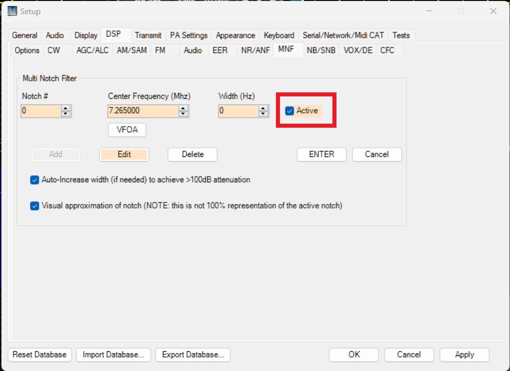

Posted: Sun Apr 09, 2023 11:56 pm
by va7qi
Hi Mark,
Well, the "Active" box is checked as is the "Notch #" (=0), so I guess that means the MNF is active. If the Active was not checked the notch would not show on the panadaptor.
I am going to try going back for P1 firmware.
Posted: Mon Apr 10, 2023 12:04 am
Firmware has nothing to do with MNF operation. All filtering is done in Thetis.
