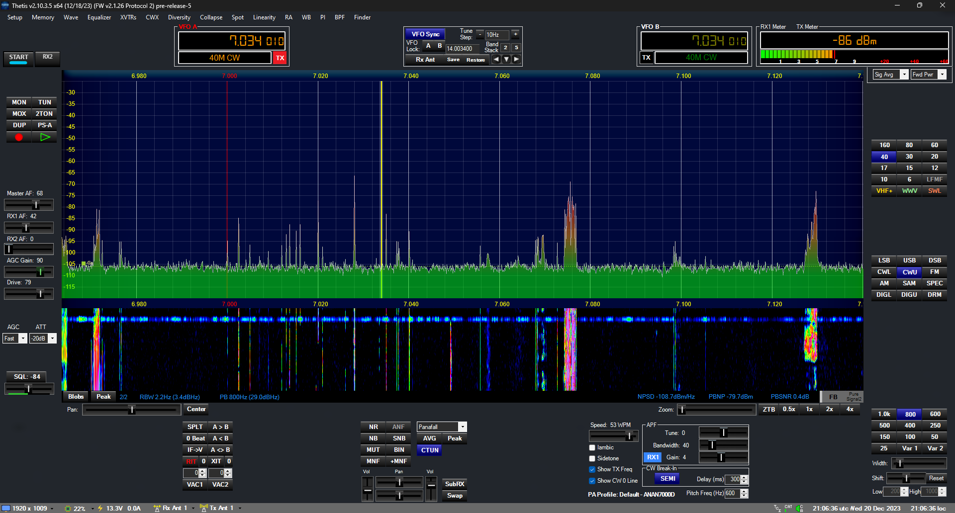

I am not seeing this. cmASIO seems to be working. I have it set up to deliver Thetis sound directly to the sound card via cmASIO. I am also using pre-release 5.
It's on the right side between CAT-Status icon and utc-clock.

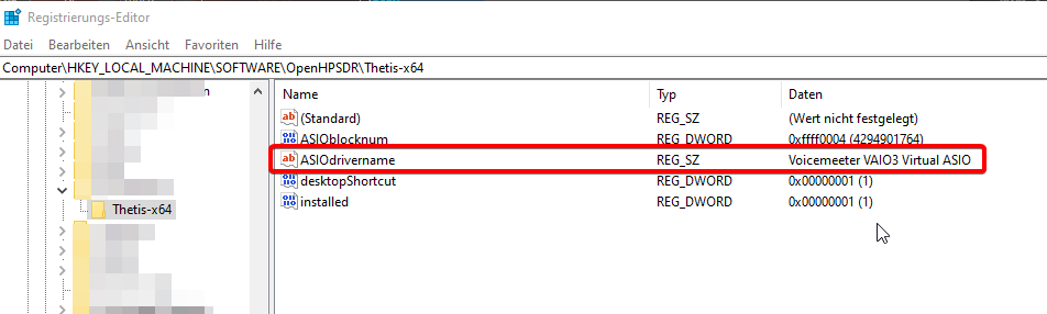

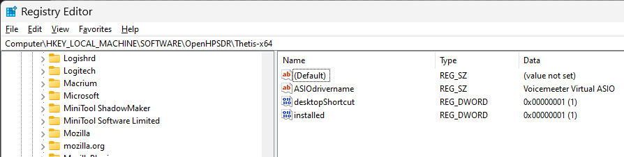

OK, maybe I have something configured incorrectly. Hare are a couple of captures that might tell a story. My intention with the cmASIO feature is to send Thetis sound directly to the sound card which it seems to be doing. capture.pngcapture2.png
You want to correct your registry entry ;-)
The key has to be "ASIOdrivername"....
O my I'm embarrassed. :oops: That was so obvious. I knew that. I'll blame it on age. Yea. I'll blame it on age. That did the trick :D
Thanks Ernst!

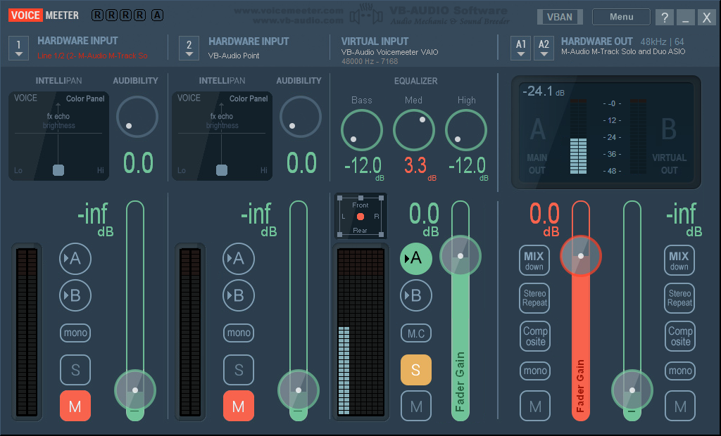

Well I dont believe it, I have it working,
So I've set the output of VoiceMeeter to the M-Audio M-Track Solo ASIO 48khz 64
Changed the Registry entry to Voicemeeter Virtual ASIO
Started Thetis and I got a green cm speaker !!
Audio is now routed via Voicemeeter to the M-Audio and the internal sound card !!
Wicked!!!
Would still like to see if Bryan can make the M-Audio ASIO work directlyu without the need for Voicemeeter.
Jim M0CKE

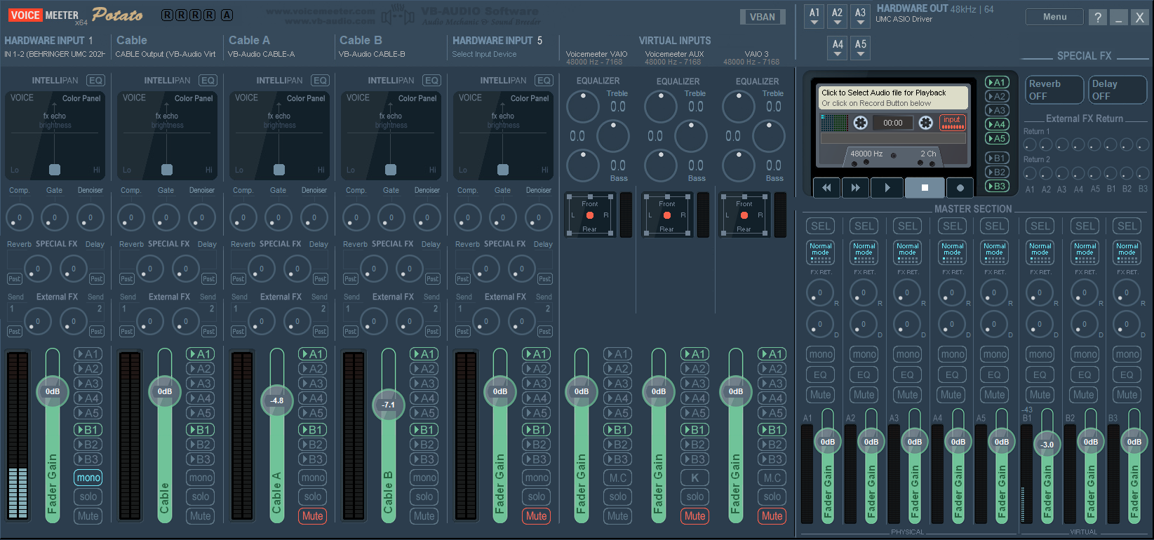

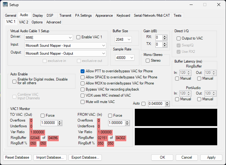

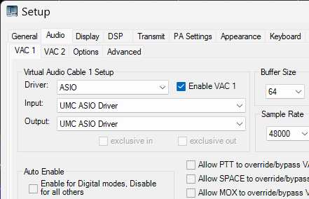

Jim, are you having to enable VAC1 to get audio?
I ask the question because I have mine set up similar. I have a green cmASIO indicator. I have the registry entry of "(Voicemeeter Virtual ASIO".
I have Thetis Setup>Vac 1 input and output set to "UMC ASIO Driver" and Voicemeeter Hardware output at A1 set to "UMC ASIO Driver".
I have audio but only if I enable VAC1. Someone said in an earlier thread that this should bypass Voicemeeter thus nulling the need to Activate VAC1. Maybe the earlier note was talking about something different. Are you having to activate VAC1 to obtain audio?
You should not need VAC activated to get sound . Is the master AF turned up in Thetis ?

Tony EI7BMB wrote:You should not need VAC activated to get sound . Is the master AF turned up in Thetis ?
Yes.
Maybe this helps?

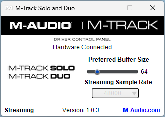

I'm using VoiceMeeter, the most basic of them, I only got it to work once I set the output of Voicemeeter to a hardware ASIO device driver with the output set to 48kHz and Buffer of 64
M-Audio Streaming.png (26.08 KiB) Viewed 32184 times
Yes.
Maybe this helps?
Shutdown Voicemeeter (Menu=>Shutdown Voicemeeter) and restart Thetis (disable VAC)

I shut down Voicemeeter as described. I closed Thetis thus shutting it down.
When I restart Thetis I hear sound with only VAC1 enabled. I checked Task Manager to verify Voicemeeter was closed. I agree I should be hearing sound without VAC1 enabled which has me scratching my head. I've checked spelling and blank spaces. I also have a red CM speaker indication"
I don't quite understand how having the registry string "ASIOdrivername" set to "Voicemeeter Virtual ASIO" is directing the audio to "UMC ASIO DRIVER." ?? :roll:

Ruben--you show VAC turned on and running direct to the sound interface. That means you are not using cmASIO exclusively and are effectively bypassing Voicemeeter. If you want to test cmASIO, disable VAC.

I can't get the M-Audio M-Track Solo to work either, so it's not just you :-)
The M-Audio's ASIO driver will not let cmASIO load it. No ideas yet as to why.
This is the first driver I've run into that behaves like this. I will try to find out why though.
In the meantime, other users might well be advised to steer clear of the M-Audio device.
Bryan
UPDATE: The workaround for this driver (which has an illegal driver name for some crazy reason) is to enter the following in the ASIOdrivername registry key value:
M-Audio M-Track Solo and Duo...
Note the trailing ellipsis after the word "Duo", that must be included!
Hi Jim,
Glad you got it working!
Bryan
Hi Bryan
Great work !!
Intersting this name doesn't show up in the hostsample output!
Changed to your findings and working FB here
Jim M0CKE

I use the UMC202HD and it works fine with cmASIO on input channel 1. Is there anyway to switch to channel 2 on he 202HD using cmASIO in order to select a different microphone without having to use VoiceMeter?
Joe, W4WT

Hi Joe,
Yes, cmASIO picks up both input channels on the 202, just plug in the mic and turn up the gain.
Just make sure to have the line/inst button and the pad button on input-2 set the same as input-1.
Bryan

Thanks Bryan. Just tried it and it indeed picks up both channels. Minor issue in having to turn down the gain or unplug the channel not in use. Turning down the gain means having to reset it with the Mic meter when switching back unless you unplug it but better than nothing!
Would be really nice to have a toggle maybe on the cmAsio Icon or a right click menu to pop up on the Icon to select a particular channel and not have to change settings or unplug anything. Perhaps something for the future?
Thanks again for this nice new feature to our software! Great work.

Yes, that's a valid entry for the registry key value. You might want to first try ffff0006 just to get your feet wet using blockMode. That way, you're not being too ambitious with the receive audio stream at the same time that you're trying to push the transmit audio stream. Once you see that your computer can handle blockMode, and your transmit audio is fine, then you can push the envelope on the receive audio stream too.
BTW, the anomaly you were having with your driver name and the hostsample utility may have happened because I had uploaded an x86 (32-bit) version of hostsample, which pulls from the 'WOW6432' part of the registry. That was an unforced error on me. I have since uploaded the x64 version of hostsample (to the same link as before) which should give you more accurate info for your ASIO driver of choice.
Bryan

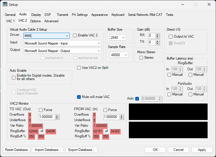

VAC problem here with this new version on my 200D. I cannot access VAC with Thetis v2.10.3.5 but VAC works fine with the previous versions of Thetis (including 2.10.3.3). I can't use the cmASIO upgrade in 2.10.3.5 (no audio devices here). I use VAC for Phone operation and digimodes using Voicemeeter. Also tried Muzychenko VAC and this did not work either. I need VAC here for my 200D to function.
I'm no audio expert so I suspect a wrong setting has got into my audio chain accidently as a result of the cmASIO changes in Thetis. I have made sure that the cmASIO Registry changes have been disabled by putting in a false ASIO name. I have tried the usual re-boot of PC but no improvement.
I'd be interested to hear if others with older rigs (100D, 200D) also have a VAC problem with the latest Thetis or whether it is just me. Returned to Thetis v2.10.3.3 until this is resolved.
73 Dave G3ZQH

G3ZQH wrote:I'm no audio expert so I suspect a wrong setting has got into my audio chain accidently as a result of the cmASIO changes in Thetis. I have made sure that the cmASIO Registry changes have been disabled by putting in a false ASIO name.
Hi Dave,
Just out of curiosity: please help me understand why you added the registry key value for cmASIO (ASIOdrivername) if you knew that you weren't going to be using cmASIO.
Thanks & 73,
Bryan
G3ZQH
Posts: 111
Re: Thetis v2.10.3.5 final release
Post by G3ZQH »
Hi Bryan
Initially I didn't understand that cmASIO was intended for a specific audio device. I was hopeful that I could use it to bypass the intermittent VAC instability that I have here with my set up. I have Realtek ASIO drivers on my PC which can be linked in through Voicemeeter and VAC (this works fine).
I did try cmASIO using either Voicemeeter Virtual ASIO or Realtek ASIO (these both appeared in the ASIO driver list) but just received the "Issue starting cmASIO. Check driver name in registry". The names were correct in registry. I also made appropriate adjustments in Voicemeeter settings for buffering and using the Lnt32LSB ASIO. But still no action from cmASIO.
The cmASIO functionality is an excellent addition and I wish I could access it but probably not prepared to buy a new audio interface just for this. Basically, I just want something that works and provides stable audio for SSB and digimodes. I use key direct to rig for CW and would also use analogue for audio except that the input audio on my 200D has a problem with background noise (but that is another story...).
So, essentially I gave cmASIO a go then disabled it in case the registry setting was interfering with VAC to/from the radio.
73 Dave G3ZQH
