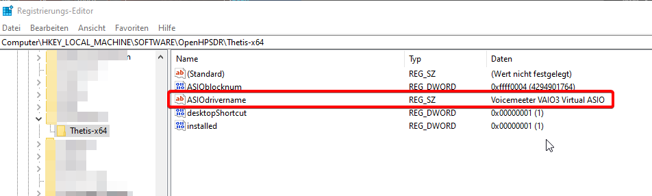

OK, maybe I have something configured incorrectly. Hare are a couple of captures that might tell a story. My intention with the cmASIO feature is to send Thetis sound directly to the sound card which it seems to be doing. capture.pngcapture2.png
You want to correct your registry entry ;-)
The key has to be "ASIOdrivername"....

oe3ide wrote:
rbduck wrote:
oe3ide wrote:
It's on the right side between CAT-Status icon and utc-clock.
O my I'm embarrassed. :oops: That was so obvious. I knew that. I'll blame it on age. Yea. I'll blame it on age. That did the trick :D
Thanks Ernst!

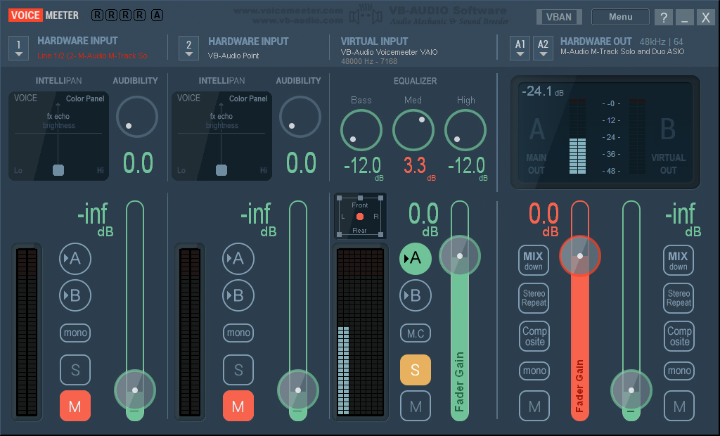

Well I dont believe it, I have it working,
So I've set the output of VoiceMeeter to the M-Audio M-Track Solo ASIO 48khz 64
Changed the Registry entry to Voicemeeter Virtual ASIO
Started Thetis and I got a green cm speaker !!
Audio is now routed via Voicemeeter to the M-Audio and the internal sound card !!
Wicked!!!
Would still like to see if Bryan can make the M-Audio ASIO work directlyu without the need for Voicemeeter.
Jim M0CKE

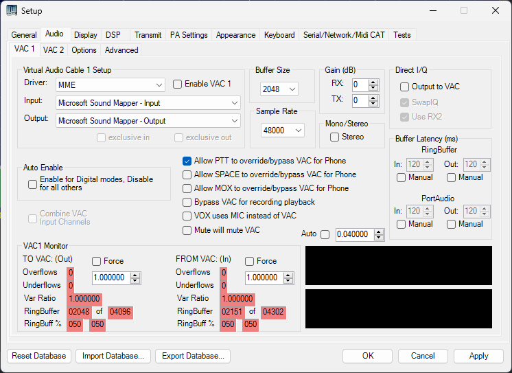

Maybe this helps?
Posted: Wed Dec 20, 2023 9:08 pm

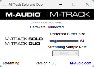

Hi, No both VAC are off and not needed
I'm using VoiceMeeter, the most basic of them, I only got it to work once I set the output of Voicemeeter to a hardware ASIO device driver with the output set to 48kHz and Buffer of 64
M-Audio Streaming.png (26.08 KiB) Viewed 32440 times
thetis 3.png (330.19 KiB) Viewed 32440 times
Posted: Wed Dec 20, 2023 9:11 pm
by oe3ide
rbduck wrote:
Tony EI7BMB wrote:You should not need VAC activated to get sound . Is the master AF turned up in Thetis ?
Yes.
Maybe this helps?
Shutdown Voicemeeter (Menu=>Shutdown Voicemeeter) and restart Thetis (disable VAC)

Posted: Wed Dec 20, 2023 9:49 pm
by rbduck
oe3ide wrote:
Yes.
Maybe this helps?
I shut down Voicemeeter as described. I closed Thetis thus shutting it down.
When I restart Thetis I hear sound with only VAC1 enabled. I checked Task Manager to verify Voicemeeter was closed. I agree I should be hearing sound without VAC1 enabled which has me scratching my head. I've checked spelling and blank spaces. I also have a red CM speaker indication"
I don't quite understand how having the registry string "ASIOdrivername" set to "Voicemeeter Virtual ASIO" is directing the audio to "UMC ASIO DRIVER." ?? :roll:
Hi Jim,
Glad you got it working!
I can't get the M-Audio M-Track Solo to work either, so it's not just you :-)
The M-Audio's ASIO driver will not let cmASIO load it. No ideas yet as to why.
This is the first driver I've run into that behaves like this. I will try to find out why though.
In the meantime, other users might well be advised to steer clear of the M-Audio device.
Bryan
UPDATE: The workaround for this driver (which has an illegal driver name for some crazy reason) is to enter the following in the ASIOdrivername registry key value:
M-Audio M-Track Solo and Duo...
Note the trailing ellipsis after the word "Duo", that must be included!
Hi Bryan
Great work !!
Intersting this name doesn't show up in the hostsample output!
Changed to your findings and working FB here
Jim M0CKE
