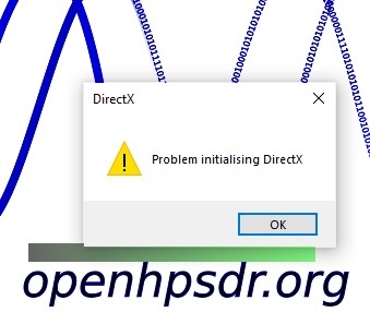

An error "Problem initialising DirectX" occurs when upgraded to 21k5 / 21k6 with no display. However, reverting to 21k3 version works fine. I wonder what the solution is. Did anyone else faced this issue?
Thetis 21K5-DirectX Issue.jpg (28.7 KiB) Viewed 32170 times
Sid VU3NXI

vu3nxi wrote:An error "Problem initialising DirectX" occurs when upgraded to 21k5 / 21k6 with no display. However, reverting to 21k3 version works fine. I wonder what the solution is. Did anyone else faced this issue?
Sid VU3NXI
Seeing the same issue here on two computers now. Thetis x64.
Mike, N1JEZ

UPDATE 21k7
Just a small update with a couple of changes. The directX startup issue should be resolved for those having it (I will need to add feature level option eventually).
