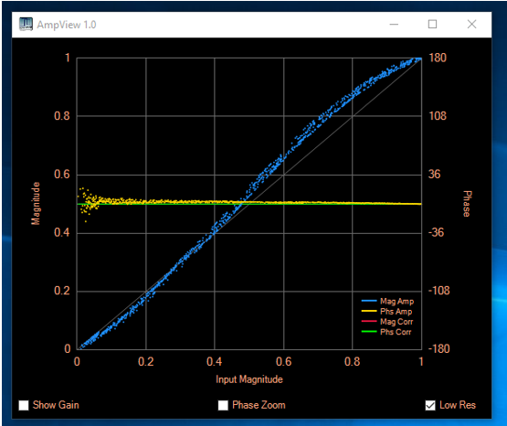

I would like to report the comparison between Thetis original 2.8.11 and the updates on Pure signal and TX/RX sound.
First of all, PS Amp View is strange between them. Please look at the screenshot. In 2.8.11, Mag. Corr. curve (red line) is displayed always, however in 21j this red curve is not consistent when I speak. Most of time, it disappear. 2-Tone test is quite OK. But speaking not. The amplifier setting, and others are the same. Since this test is done within 10 minutes.
As for TX sound quality, my local ham reported Thetis 2.8.11 is much better than 21j this morning.
Concerning RX sound, the sound is the same between 21j and 2.8.11, however RX sound changes between21k and 2.8.11. I prefer the RX sound of 2.8.11.
My RX sound is from Orion MKII, not through VAC. But I use VAC for TX.

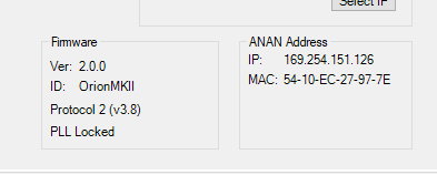

My PC and the firmware of Orion are shown in the attached pictures. The setting of Thetis for 21j/21k remains unchanged except enabling TUNE STEP by mode, which is not in Thetis 2.8.11.

From yesterday I started to use the update version here.

- cpu.PNG (3.18 KiB) Viewed 28880 times
- PS amp view.PNG (76.51 KiB) Viewed 28880 times
For the the amp view issue I would suggest unchecking low res bottom right in your screenshot and see if that helps.

Hi nubbyless,
Thank you for your comment on my posting.
Low Res on PS Amp View panel is for resolution. It doesn't affect the issue I posted.
I suppose the problem would be related to the baseband (audio) processing modification in Richie's development.
In addition, in 21j PS improvement is lower than Thetis original's HERE.

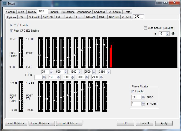

On 160 meters tonight three of us running Thetis 2.8.11 v21k7 compared notes on the CFC Visualizer and we found it was not working correctly for any of us. Two of us were running VAC and we thought that might be the issue but the third user was not running VAC and his description sounded like what I see in my screenshot with everything squeezed into the left side of the display. Have we mis-configured something or do others see the same thing we see?
Thanks and 73, Rob W1AEX

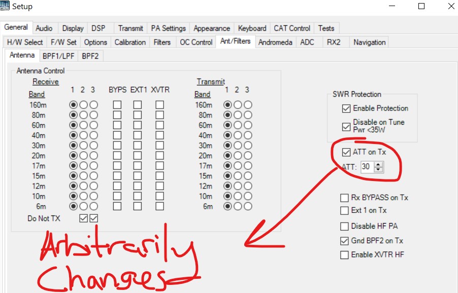

I discovered a bug with the "attenuation during tuning". I set mine to be 30db attenuation. Save profile and all that. Close thetis. Open it back up, and it arbitrarily gets set back to default, or random numbers. In some cases it gets changed to 0 ! This caused me to get a ADC overload message which was my only clue something changed. What the h is going on with the tuning/transmit attenuation values? 21k7 version
UPDATE 1:
It appears the tune power variable is tied to what band is selected. OK, so I went through each band and set it to 30db atten. Saved profile. Exported. Closed thetis, reopened, and it 20 meters changed back to 17db atten, the heck? So random. I believe this variable is either being modified from something else, or it has a goal to always reset to default value.
UPDATE 1:

I don't use the CFC function but I checked it out and I am seeing the same thing as W1AEX.

If you use PS it will be adjusted. There are also times when it is reset to 31.dynamicfusion wrote:I discovered a bug with the "attenuation during tuning". I set mine to be 30db attenuation. Save profile and all that. Close thetis. Open it back up, and it arbitrarily gets set back to default, or random numbers. In some cases it gets changed to 0 ! This caused me to get a ADC overload message which was my only clue something changed. What the h is going on with the tuning/transmit attenuation values? 21k7 version
UPDATE 1:
Rob, it does not work for me either, but not sure what it would even show me that would help improve the audio over what it is now.W1AEX wrote: Have we mis-configured something or do others see the same thing we see?
I was one who requested it. The idea is to show how much impact or reduction each band of the CFC is engaging. It’s useful to understand the spectral distribution where without it you are just going by ear but may not realize just how hot a hot spot is or that your overall gain staging is not in balance. I.e. lets say you are just hammering 63 Hz into the CFC, it would be better, cleaner, to attenuate 63 Hz before it even gets to that stage of processing rather than pounding into a limiter.NC3Z wrote:Rob, it does not work for me either, but not sure what it would even show me that would help improve the audio over what it is now.W1AEX wrote: Have we mis-configured something or do others see the same thing we see?
It’s too fast to see on my system, didn’t seem to register in VAC mode but I went over to analog wired mode and it works but it’s so fast it’s hard to make any sense of currently.
It is a snapshot of the compression, and does not have any history/hang time. Also, it is only queried around 20 times a second so it is no doubt missing lots of information. It needs more work, and will require some adjustments in the cfc dsp code. We may have to keep peak values in the snapshot buffer, and then reset them after the the query is made. I will talk to Warren to see if we can improve it.kc2rgw wrote:I was one who requested it. The idea is to show how much impact or reduction each band of the CFC is engaging. It’s useful to understand the spectral distribution where without it you are just going by ear but may not realize just how hot a hot spot is or that your overall gain staging is not in balance. I.e. lets say you are just hammering 63 Hz into the CFC, it would be better, cleaner, to attenuate 63 Hz before it even gets to that stage of processing rather than pounding into a limiter.NC3Z wrote:Rob, it does not work for me either, but not sure what it would even show me that would help improve the audio over what it is now.W1AEX wrote: Have we mis-configured something or do others see the same thing we see?

A quick look at the issue : https://youtu.be/9OlfLs-h5pk

Thanks for the reply. I am not quite understanding why in some cases it goes all the way up to zero attenuation? Won't this blow out some receiver module? Shouldn't it be hardlocked to at least 15db attenuation? Furthermore why is Pure Signal related to tuning tone output in the first place? I reckon we dont need to be correcting a single tone being sent out for tuning purposes, but that's only me. Thanks.ramdor wrote:dynamicfusion wrote:
Thank you for putting together the CFC video to show what's happening. I was able to duplicate your setup and observed perfect sweeps across the CFC visual display and the "Auto-Scale" set up the vertical range perfectly. I was mostly curious if I had missed a setting somewhere when I tried to observe my transmitted audio in the CFC display and only saw the deflection squeezed into the left part of the horizontal range. Normally, after setting all my levels in the software audio chain from front to back I usually close my eyes and listen to the monitor while running a recording of my voice played through the Thetis voice processing software. Then I make my geeky compression adjustments to add punch and clarity and run with that. I guess the visual representation is not a necessity for me but understand that it might be helpful to someone else. Thanks for all the progress you have made with advancing Thetis!

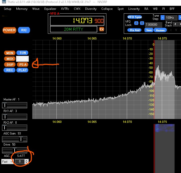

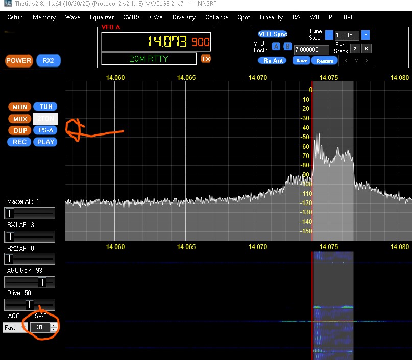

I recently updated to 21k7 and I am having the same issue...the ATT on Tx I set it to 31 as I always have...then when TX it immediately reverts to 0 (zero). I does not matter if saving the TX profile with ATT set to 31..... A curious / Interesting finding: If I disable PS-A, the S-ATT shows 31!!! Even if the ATT on TX is set to Zero, disabling the PS-A changes it back to 31!!! Pure signal is not showing as working, of course, under Liniearity / Amp View.... I do not think that, when PS-A is enabled, as setting of zero is helping with the signal.
This not use to be like this.

These attenuator issues do not seem like a bug at this time. People are not reporting a lot of problems in this area, and these issues can't be duplicated here.
When PureSignal is active (PS-A button illuminated), the PureSignal Auto Attenuate feature is also active by default. Auto Attenuate will set the step attenuator in accordance with the feedback level it sees either from the internal or external coupler. Coupler selection is manual via rear panel jumper on 8000's, or via software selection on other models that support PureSignal. Improper coupler input selection will result in bad attenuator settings. Improper external coupler connections will also result in bad attenuator settings. Broken or intermittent coupler or cable connections will also result in bad attenuator settings.
Auto Attenuate will only kick-off a reading if ALC is at 0dB. If audio or other adjustments are not driving to 0dB ALC then the step attenuator will not be set properly (and PureSignal corrections will also not be updated). When using speech as the source of audio, this can sometimes be problematic. For testing this can be overcome by using the two tone output feature with the "Use Drive Power" option enabled.
Finally, when using an external coupler, if proper feedback levels are not obtained as described here, this can also cause the step attenuator to be driven to either 0dB or 31dB depending on if the feedback levels are too high or too low.
Internal feedback levels are unambiguously safe at all step attenuator values. External feedback levels should never exceed +13dBm in order to be unambiguously safe at all step attenuator values.
If for some reason PureSignal operation is desired but without Auto Attenuate functionality, this can be disabled in Linearity > Advanced and the TX atten value set manually.
If you feel that there is some problem with your PureSignal setup or operation, please post in the PureSignal section of the forum.

Thanks, Scott.
After reading your post, and knowing that I don't have any coupler / cable / ALC settings in the wrong direction, I added a new default TX profile to my arsenal. While using this added one everything is working as expected.
So I conclude that my TX profile had some corruption somewhere that is not easy to fix....
Thanks to all you amigos who make this software better every day....now back to my spinning wheel.

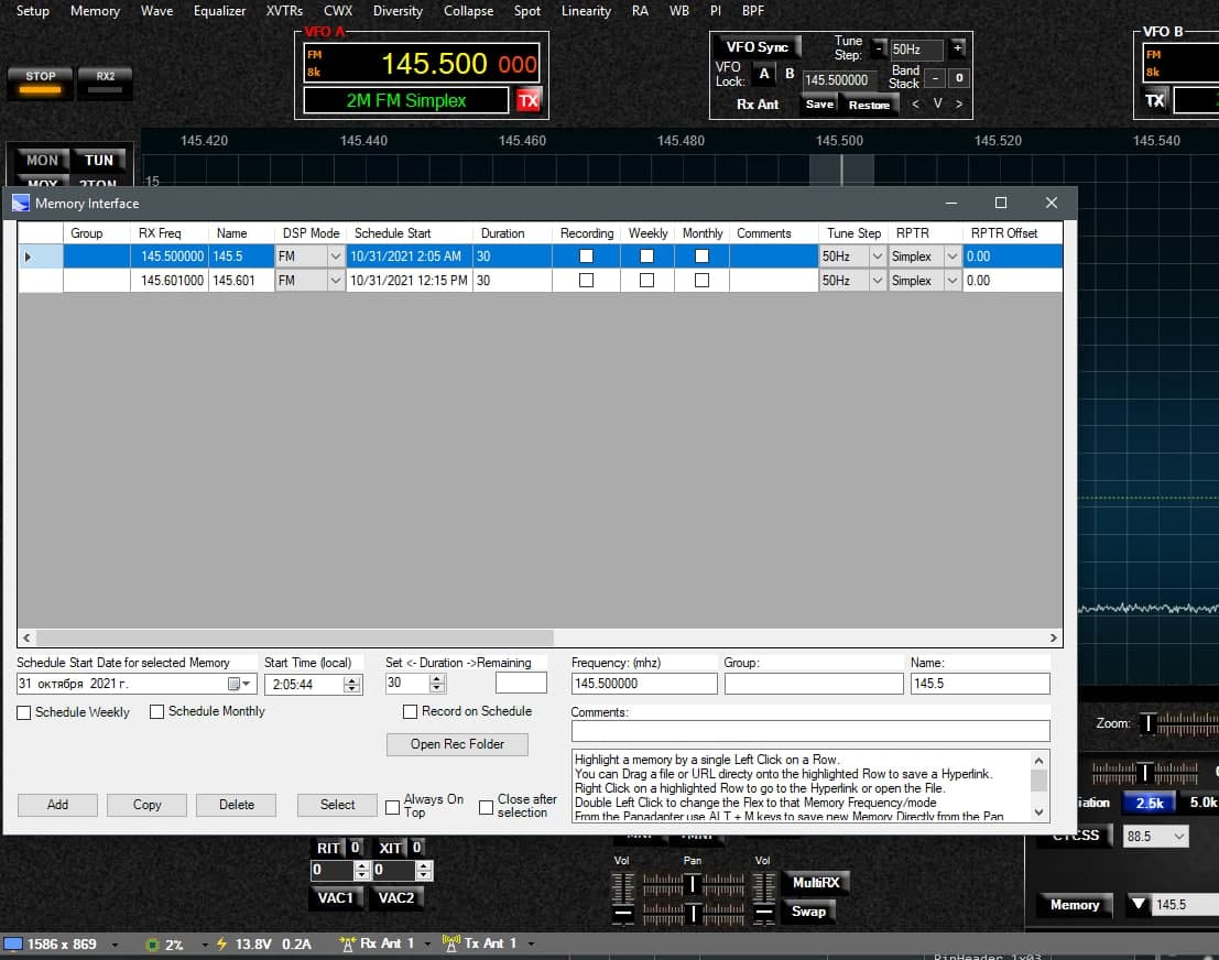

One my friend ask
He complain, split frequency doesn't store in transverter mode. I hope I understand him in right way.
- photo_2021-11-08_22-18-38.jpg (100.46 KiB) Viewed 27700 times
YL2GVC 73!
