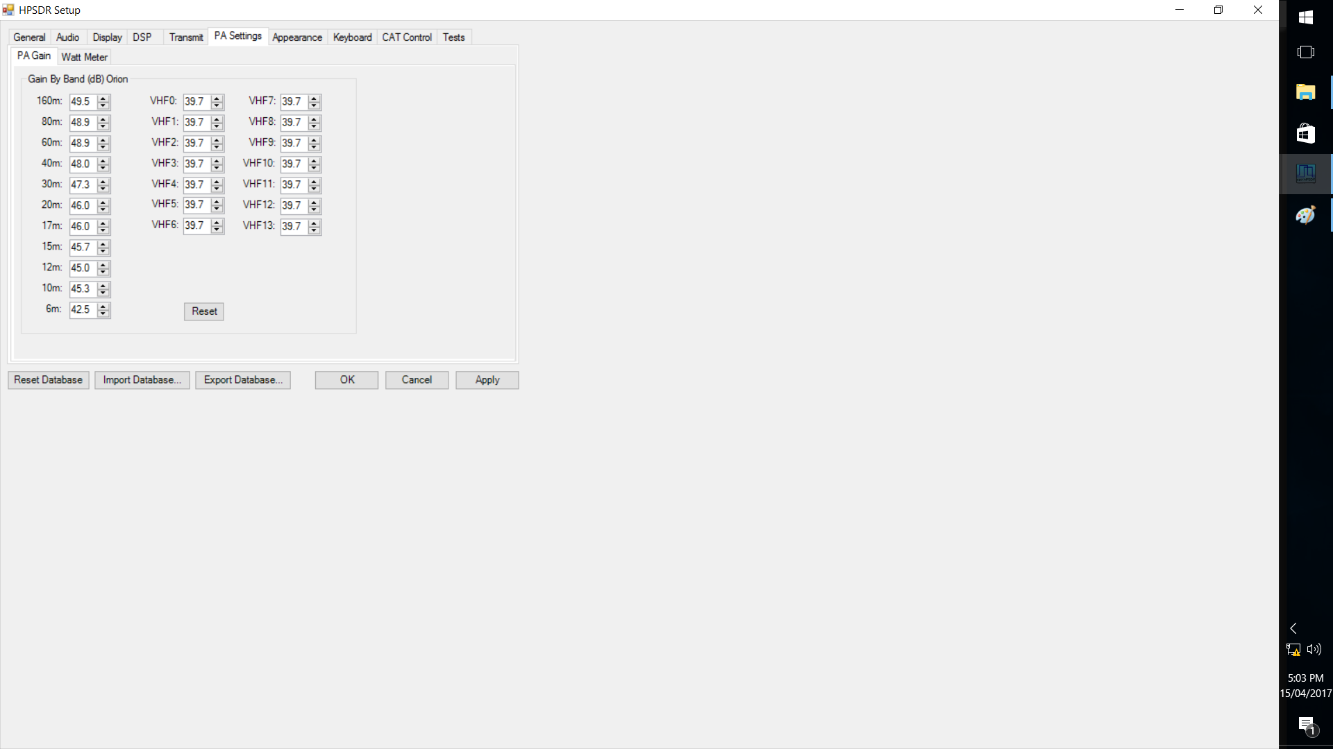

Further to my previous post, I have been experimenting with the front panel Drive Slider. With the PA Gain set to max (38.8dB) on VHF bands (PA disabled) and the Drive Slider also set to max, I can get 25mW out of the 200D "XVTR Out" port on "Tune". The Drive Slider controls the output from 25mW right down to zero. With my "normal" setting of PA Gain 39.7, the Drive Slider can control XVTR port output from zero to about 21mW, so setting the PA Gain on VHF bands to 40dB should provide 0-20mW out on the 200D XVTR port, controlled via Drive Slider on the front panel.
73, Adrian, VK4OX.
73, Adrian, VK4OX.
