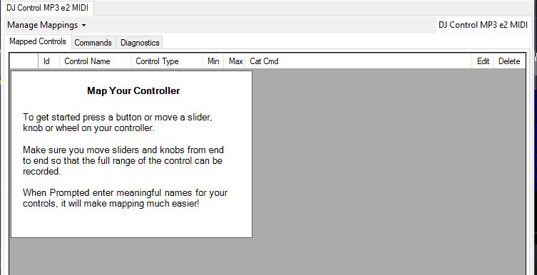

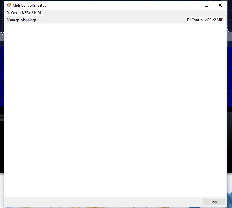

No I dont even get that. Hopefully the attachment will get through this time. Te first one is of the Configure Midi screen when it first opens, as you can see it recognises the DJ controller, the second screen is of what happens when I touch ant control, slider knob etc on the DJ controller.
I have done a database reset and tried it with the same results. I am running Win 10 Pro 64Bit with all the latest updates. I found the latest version of the DJ Controller software labelled 2018_HDJS_1 on the Hercules website which I installed.

OK I have got it to work by doing a complete uninstall of PSDR and re-installing it. Odd but Im glad its working OK now.

Good to hear, Rob. There is a separate MIDI settings file from the normal database.xml file. It may have been corrupt.
