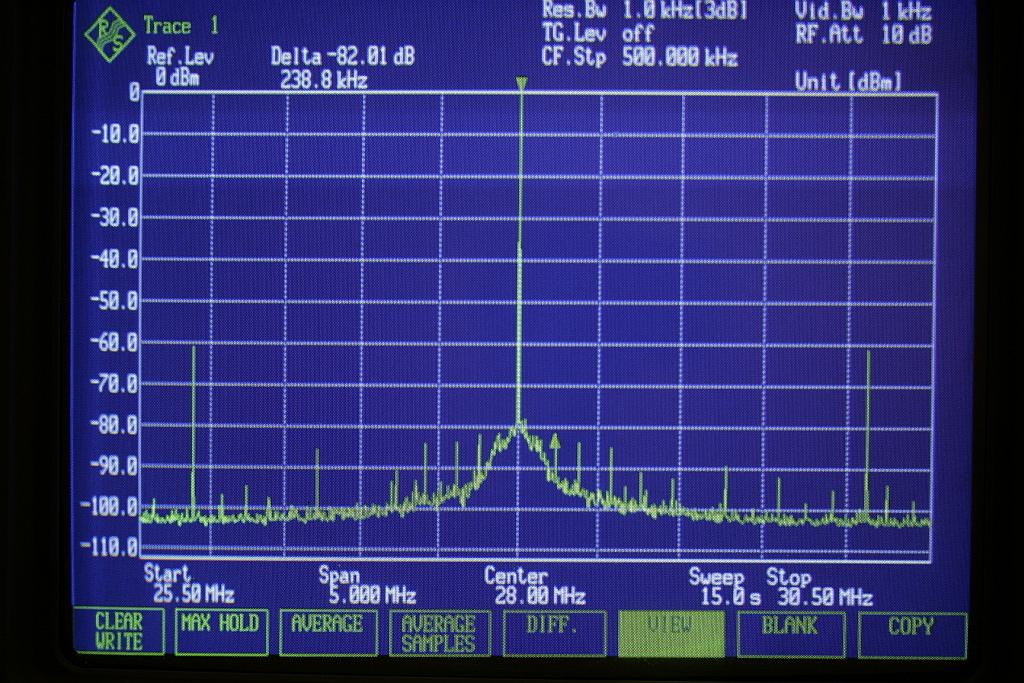

Well how embarrassed am I?
The spurs are from the HP-8562A! Here is what it looks like with a proper spectrum analyser, as I expected it to be.
I am not ashamed to admit that I am wrong.
Conrad PA5Y
Re: ANAN-10 TX spurs
Posted: Sat Sep 08, 2018 3:17 pm
by Conrad_PA5Y
That is not 11W but 13W as well.

Posted: Sun Sep 09, 2018 6:23 pm
by f6dro
Hi all ,
I saw this topic development on the forum. Should I conclude that all ANAN100are not the same? Mine is bad , generating 4 (at least) in band spurriis in the 28Mhz band and in all bands in fact.
It is not a spectrum analyser problem as , to be sure , I used an RX to confirm . These products are -60 dB down approx.
I agree it is difficult to get better than -60dBc products on a standard transceiver , because of generating and mixing several frequencies. But there , the spurriis I get are not this case , it is , for the strongest one + and - 385 Khz from the carrier , In my opinion it is not properly filtered PSU in the transceiver.
-60dBc gives quite a strong perturbation for my fellow amateurs up to 100km away and more
The measured spectrum can bee seen here:
https://www.cjoint.com/c/HIjm4wKGnyh
Dom

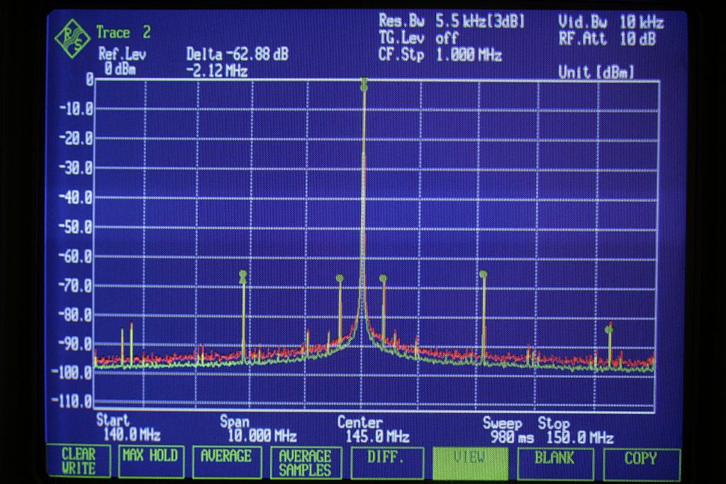

f6dro wrote:ooooops anan10 not anan 100 like mistyped
No problem, they behave exactly the same.
f6dro wrote:... for the strongest one + and - 385 Khz from the carrier...
Maybe you missed the +/- 2.112 MHz ones ?
ANAN100 attached to 2m transverter:
144mhz 1min.jpg (141.48 KiB) Viewed 48699 times
Ok, there are spurs, but they are below legal limit. What would you expect on a pure digital system?
On the other side we have world-class low IMD thanks to adaptive predistortion, nearby perfect bandpass filters and also extreme low phase noise.
Regards Walter
DL2XY
Posted: Wed Sep 12, 2018 11:03 pm
by DL2XY
f6dro wrote: The other question is : why is Conrad anan10 better than mine?
I found the Reason: He is using 384kSmp/s !
But +/- 2MHz are still there.
73 Walter
Posted: Thu Sep 20, 2018 5:48 am
by f6dro
Hi again ,
I got some time yesterday to run more measurements.
You are rigth , spur content depends on sampling. With 384K spurs are -72 (10dB better) , still not enougth and worse than Conrad anan10.
A strong signal on the band is something like -30dBm in the offended receiver , then we get 4 inband spurs at -102dBm , giving respectable jaming signals on the band.
I don't remember wether my anan is a 10 or a 10E , I'm not at home at the moment so I can't verify , maybe it could explain the difference with you and Conrad? Anyway , even -84 db down still jams.
I wonder wether DAC output filter modification could improve the situation ? -100dBc would be nice.
