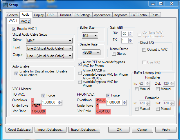

Thetis unstable with 200D/P2 v1.3
After several hours of working Thetis has now been crashing after just a few minutes of operation. The obvious problem I can see is to with the VAC audio, where there are many under/overflows. I attach screen shots. I tried ticking the VAC settings for 'manual' or 'force', but the problem was the same with either setting. I don't really understand these settings, but I can see that something is wrong.
Also, I was running WSJT-X and I noticed that the audio waterfall looked very smeared and not like it normally does. The waterfall on Thetis looks normal and the audio also sounds OK in my headphones. I also have been using SDRConsole with P2 v1.3, and this works fine and there is no problem with the VAC audio in/out.
Thetis audio.PNG (79.12 KiB) Viewed 10635 times
I hope this is useful for the development team.
73 Dave G3ZQH
