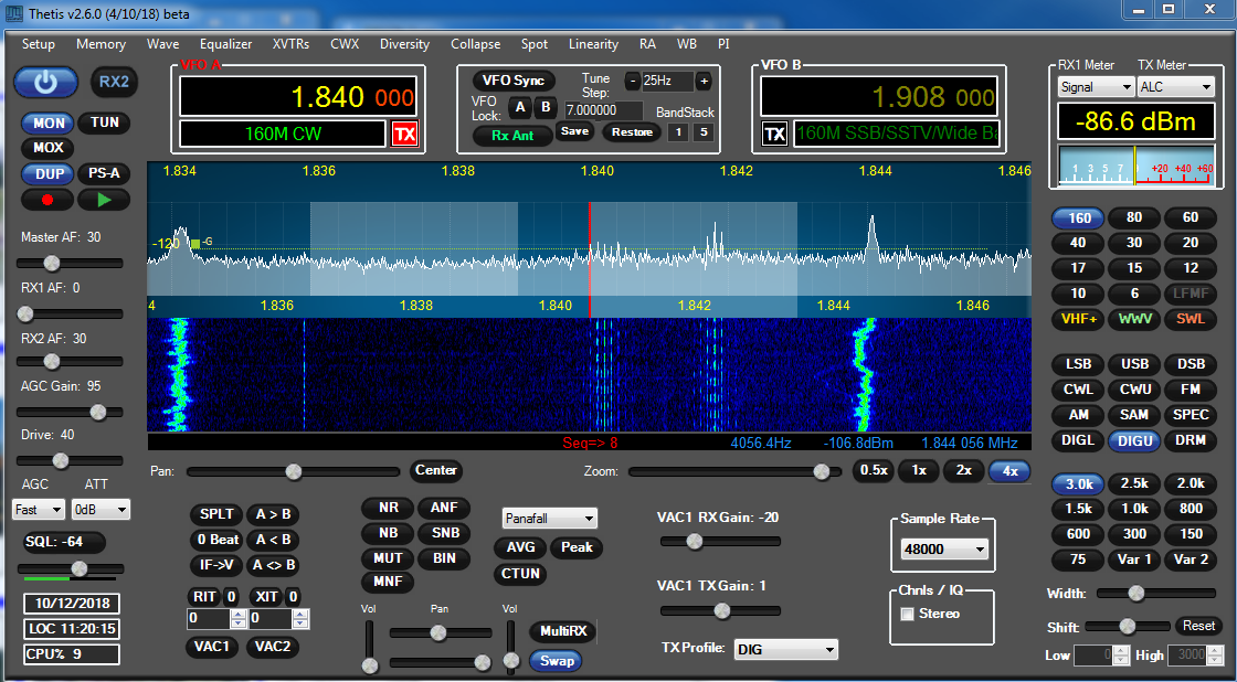

Hi Scott
I attach
Thetis ghost and frequency scale misalignment.PNG (322.06 KiB) Viewed 47911 times
a screen shot which shows the the 'ghost' image to the left of the main bandwidth area. It appears when the mouse is moved away from the main display window. The same screen shot shows the frequency scale misalignment.
73 Dave G3ZQH

Hi Norbert
Thanks, your comments were helpful. The ghost has now disappeared ! It was the Show CT Filter as you suggested. Some setting I must have transferred incorrectly from PSRDmrx.
The frequency scale problem is still there whichever mode I select. However, if I know the top scale is for RX then that does help.
I do use a mono plug for my mic (also Heil headset), so that explains the problem. For now, I can simply leave the mic unplugged until I need it. I'll wait on further updates for this problem, but I guess it might also be solved by screening off part of the mic plug barrel.
73 Dave G3ZQH

Hi Dave,
G3ZQH wrote: The frequency scale problem is still there whichever mode I select. However, if I know the top scale is for RX then that does help.
that is interesting. Please save your database first, then reset the database and restart Thetis, don't change any setting and check if the bottom frequency scale behaves different now.
In the latest PowerSDR version the bottom frequency scale is tied to the top scale, no frequency shift in any mode.

Hi Norbert
Thanks again- another problem solved. Very helpful! See below for my comments
73 Dave G3ZQH
[/i]
Resetting the database cured the alignment problem. Now it behaves as expected in CWU, CWL, LSB, USB and DIGL, DIGU. I'll monitor to see if this problem returns. Now I just need to re-enter all my settings...
