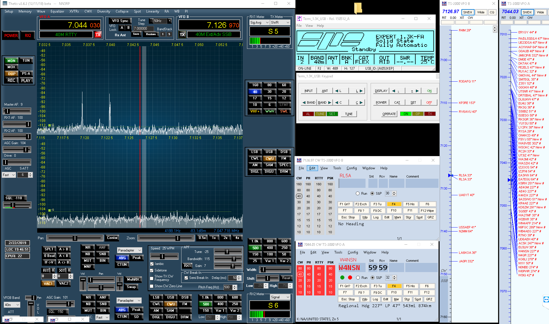

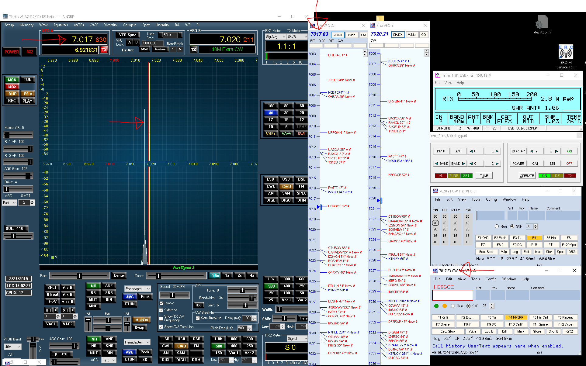

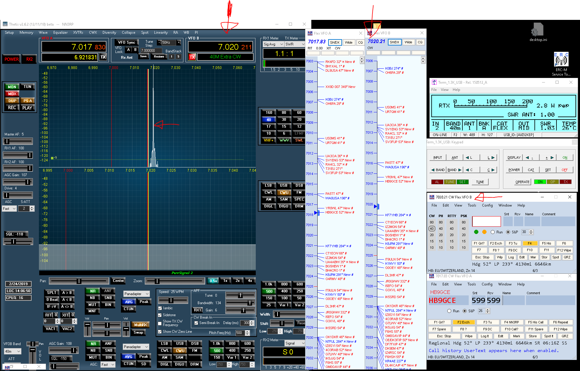

1. The \ switches from VFO A to VFO B, or viceversa. But I am only getting the RX/TX focus on VFO A! When I switch to VFO B with \, I only get RX focus but not TX (see attached pics)
2. As stated earlier, N1MM and 7000 are placed into Split when VFO-B is selected.

RX/TX
RX/TX
No TX
No TX
Split
Split

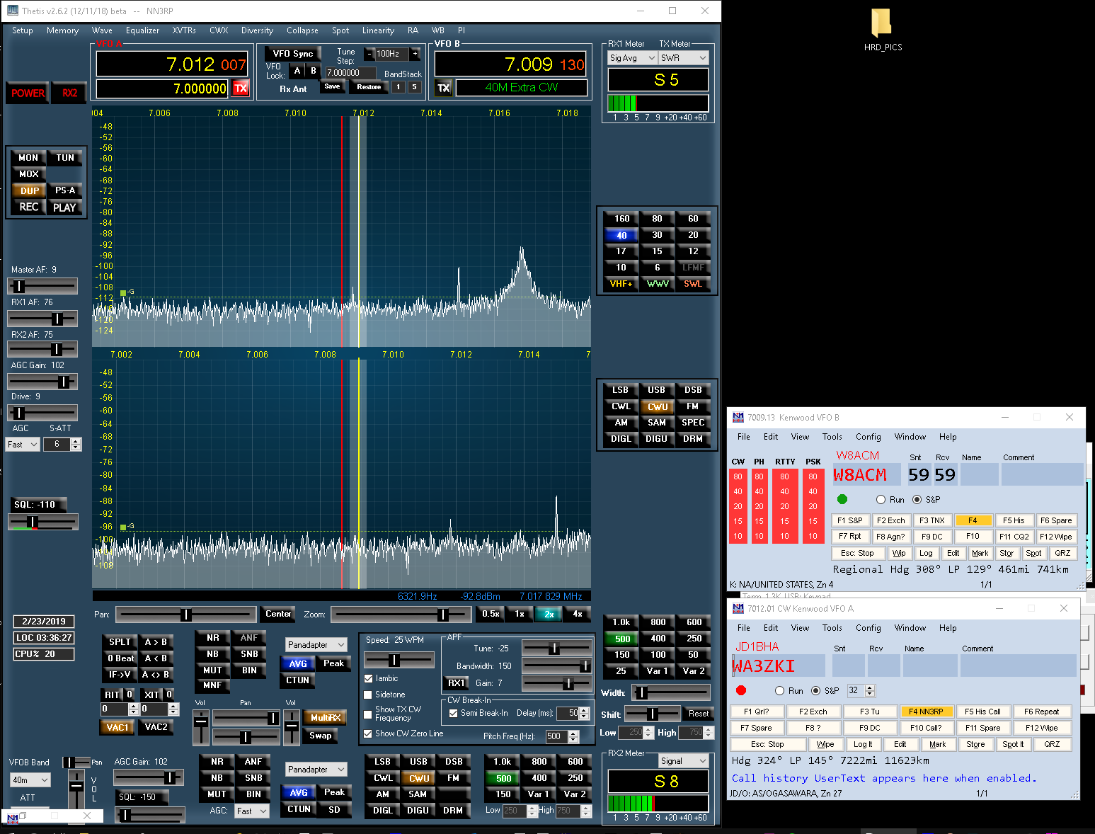

I did a couple of TX, one using VFO-A and a second using VFO-B to demonstrate the end result:
VFO-A Focus:
VFO-B Focus:

3) the main difference is the CAT setting used. to let all works in n1mm need set the radio as Flex and not ts-2000. in fact i found out this looking on the header part of the vfo and bandmap windows on your pictures. there you have the Freq/mode/cat used/VFO/Operator info.
In the first attempt that you say was not working you had ts-2000 settings like everyone. on the second attempt you had Flex. same in the youtube video.
