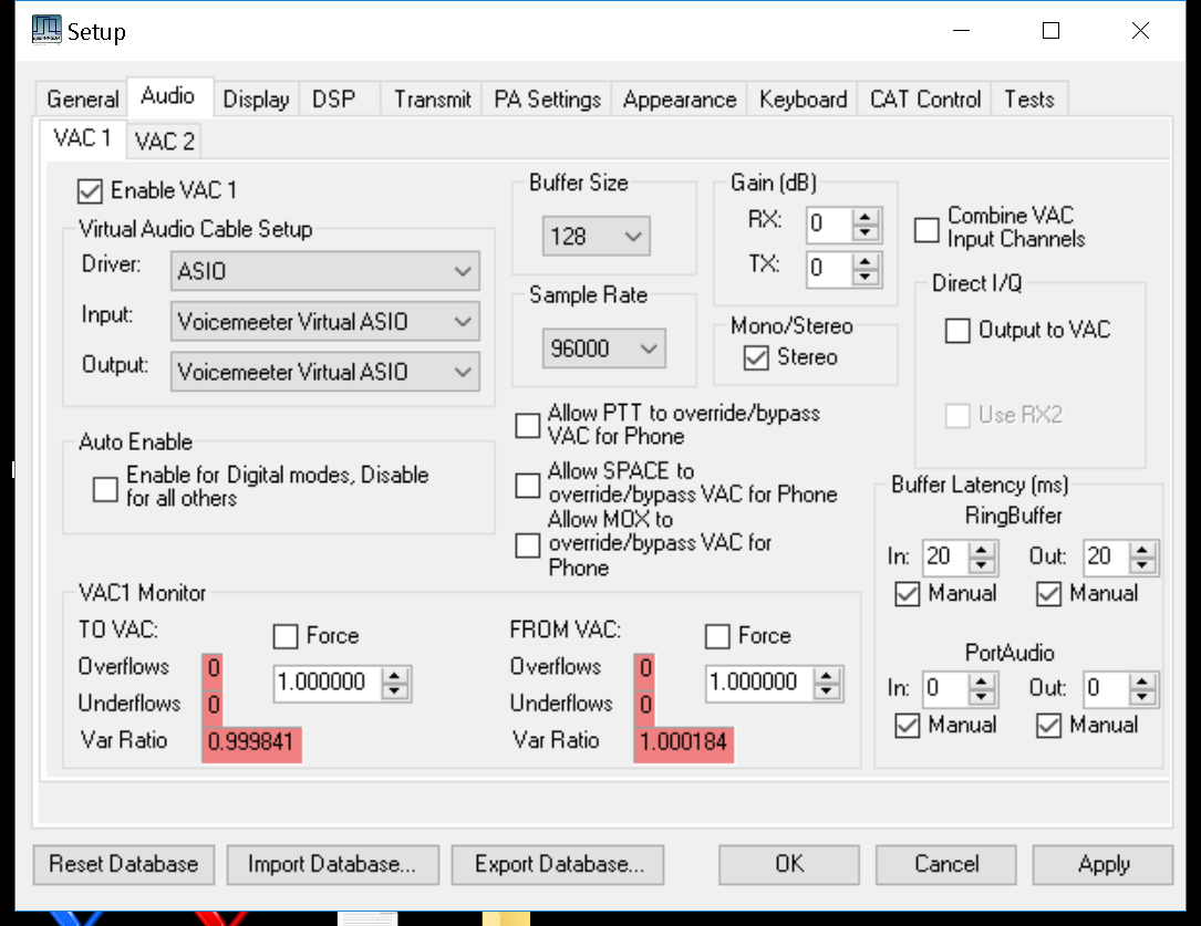

FWIW here is a screen shot of my VAC settings:
I have two, minor stability issues. Every once in a while Reaper does not start correctly and sound is messed up. I simply restart Reaper and it will remain stable for days at a time. And I get periodic instability from the resampler, which I correct by cycling one of the "manual" checkboxes in order to reset it.
P.S. Jeff: do you seek merely sidetone, or a true representation of your audio output? In either case you aren't going to get it from MON. IMHO, MON, as implemented, is useless except as a quick way to check that your VAC TX audio is not broken.

First, thank you for everything you do in support of OpenHPSDR and the Apache equipment, I hang on your every post.
My experience with Monitor appears to be very personal, and likely different from yours I expect. I find it very helpful, as it does seem to fairly represent my TX audio before it's converted to RF, and I like that. It renders my bandwidth and EQ faithfully, at least in my headphones. And as long as I can keep the latency ahead of my brain, I would rather listen to "Monitor" than a simple sidetone like Flex does.
Your VAC settings are IDENTICAL to mine, including the 96K/128 UMC, but my ringbuffers appear to be more stable at 20ms, with just a minor latency impact.
Jeff NJ2US

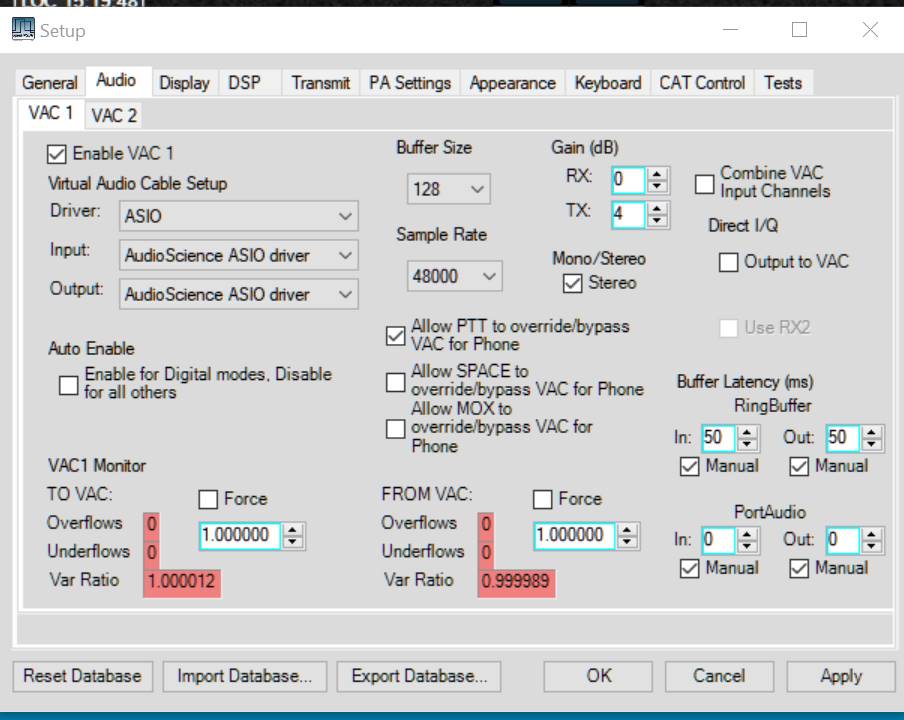

Just moved to 96K VAC and seems to be still smooth. I'll Adjust the Buffer latency over the coming days so see how low it will go. Using a Ryzen 1700 Pc windows 10 and UMC204HD interface.

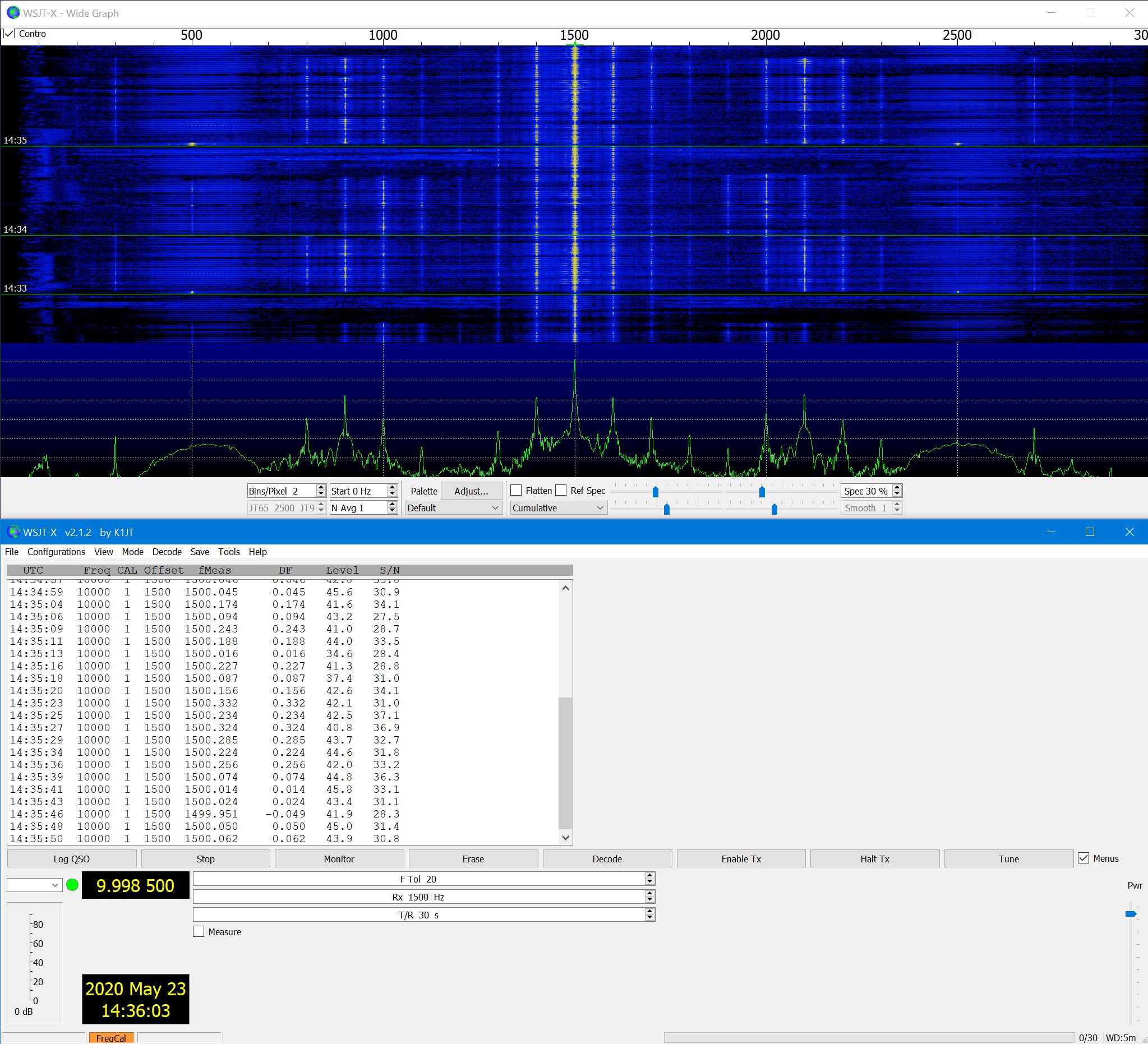

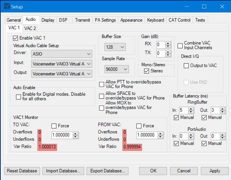

Yesterday I got the idea to use WSJT-X’s FreqCal mode to do the frequency calibration on my 200D. WSJT’s FreqCal process is complex and goes through a variety of standard frequency stations to make a curve of needed offset vs. frequency. I wanted to just perform a simple cal at one frequency, so I deleted all the cal frequencies in its list except 15.000 MHz (WSJT-X: Settings > Frequencies > mode=FreqCal). Then I was able to run the frequency calibration continuously and observe the effect of adjusting in Thetis (General > Calibration > Freq Cal).
I was going to start tweaking the Thetis cal setting, but first I noticed something strange. The frequency error amount was continuously varying, by itself, up and down about +/- 2 Hz. The variation period also varied, but it was about 30 seconds on average. (2 Hz of variation is too small for me to identify clearly in the WSJT-X wide graph, even on the WWV carrier, but it’s easy to measure in the WSJT FreqCal mode.)
The WSJT-X measurement uses VAC, so one of my first thoughts led me to the VAC resampler in Thetis. It was turned on and seemed to be operating normally. On a lark, I disabled the resampler by checking both Force checkboxes. The frequency variation immediately became about +/- 0.2 Hz – a 10x improvement in frequency stability. I repeated this several times and confirmed the checkboxes were having this effect every time.
I have operated with both Force checkboxes checked for several hours on FT8 since making this discovery about freq. stability. There is so much randomness associated with FT8 operating (band conditions, number of station in the band segments), that I am hesitant to state this report: My success rate with making FT8 QSOs is greatly improved.
(By the way, I monitored for under- and underflows with the Force checkboxes checked. The Var Ratio numbers stayed very close to 1; i.e., >0.99 and < 1.01. Under and overflow numbers stayed at 0. No audible glitches on RX or TX.)
I Googled to try to learn what the frequency stability requirement is for FT modes. The first useful link I found was http://www.w0wtn.org/downloads/n0dl/Int ... %20FT8.pdf which contains "To decode an FT8 signal we need to determine its frequency within ~1 Hz...", written by K1JT. Later I found http://laarc.weebly.com/uploads/7/3/2/9 ... syncv8.pdf, which says "FT8 requires that transmitting stations and receiver be synchronized to better than 20 ms in time and 1 Hz in frequency. Such precision is generally not possible with amateur radio equipment using external reference locks, so the protocol must supply its own synchronization signal. The different WSJT-X modes accomplish this in a variety of ways, depending on the design requirements. FT8 uses a 7x7 Costas Array."
Hmm… so FT8 should be able to self-correct some frequency errors. Perhaps the +/- 2 Hz wobbulation caused by the resampler disrupts the FT decoder’s ability to perform its internal synchronization.
73, John

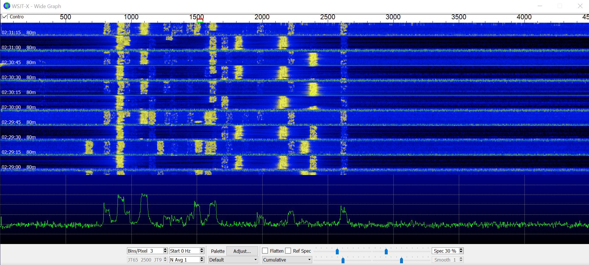

JT is of course correct - but I don't believe John (W1JA) was asserting that the WSJT-X cal function improves things (we have discussed it). He used WSJT-X cal only to observe frequency instability in Thetis as a function of the Thetis resampler setup, and saw a 10x difference in frequency stability between the two settings. All adjustments he's talking about are in Thetis, not WSJT-X. What he observed caught my interest.
The absolute variance in frequency was merely 2Hz (worst case) or less. While that small amount may have an effect on encode/decode effectiveness, what might have more pronounced effect is its rate of change during a single 15-second FT8 cycle. Maybe I'm misunderstanding something but it seems to me that this wobble rate might have a greater effect than the drift magnitude, since FTx modes use phase modulation.
At any rate, I tried it myself, checking the "force" boxes in the Thetis resampler and noticed a similar improvement. In totally unscientific, subjective observations while operating I found a noticeable increase in my ability to get responses. Interestingly, I also noticed that the lopsidedness of signal reports evened out. By this I mean I have consistently noticed that I receive lower reports than I send, many more times than the other way around (i.e. when I receive a higher report than I send). On making the change this evened out dramatically. This is as close to a measurable thing I've come across so far.
Will continue to experiment.

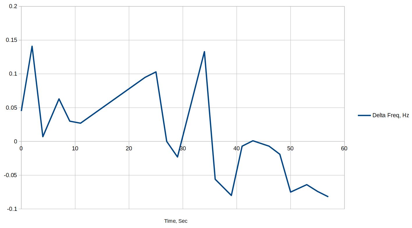

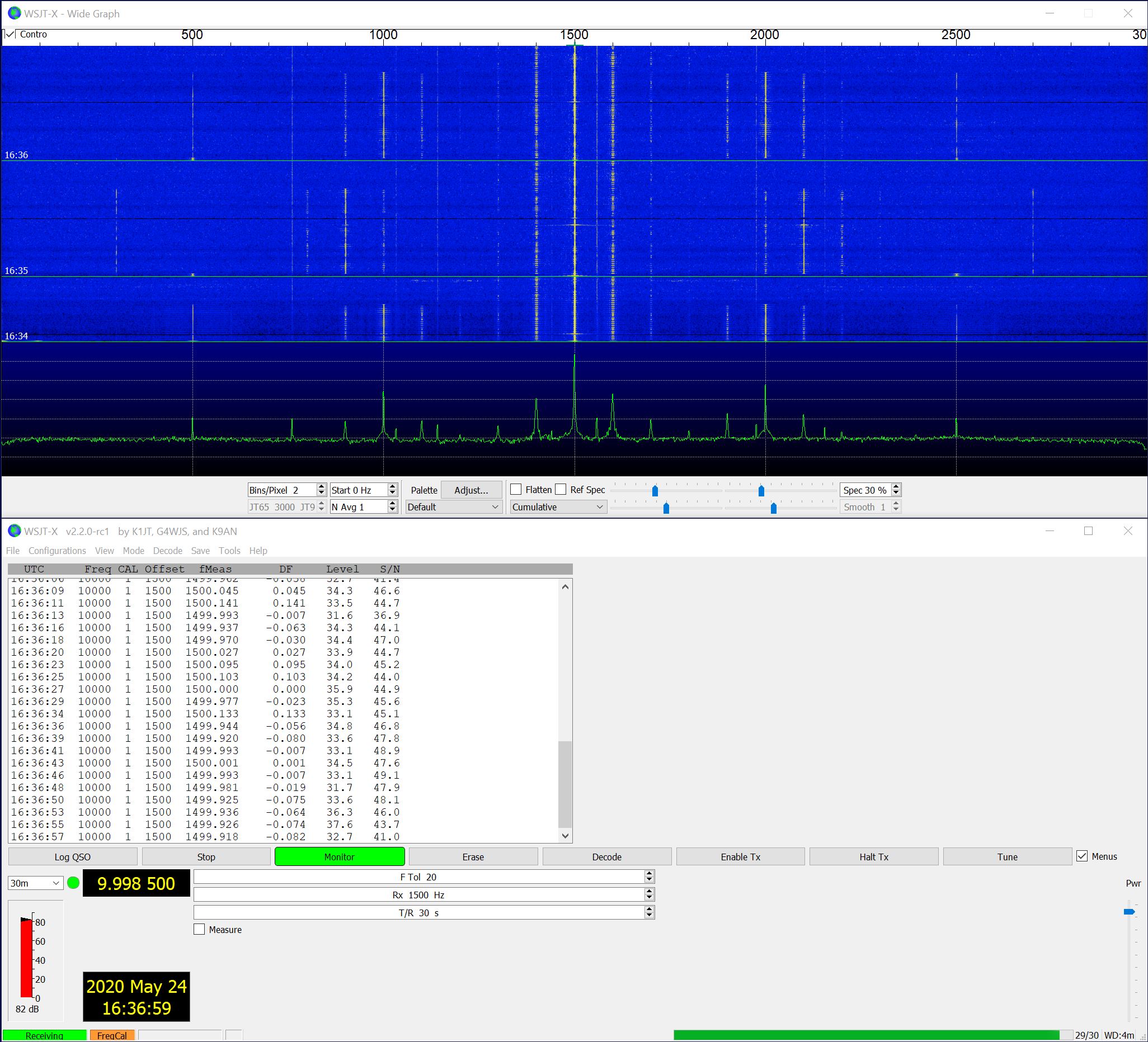

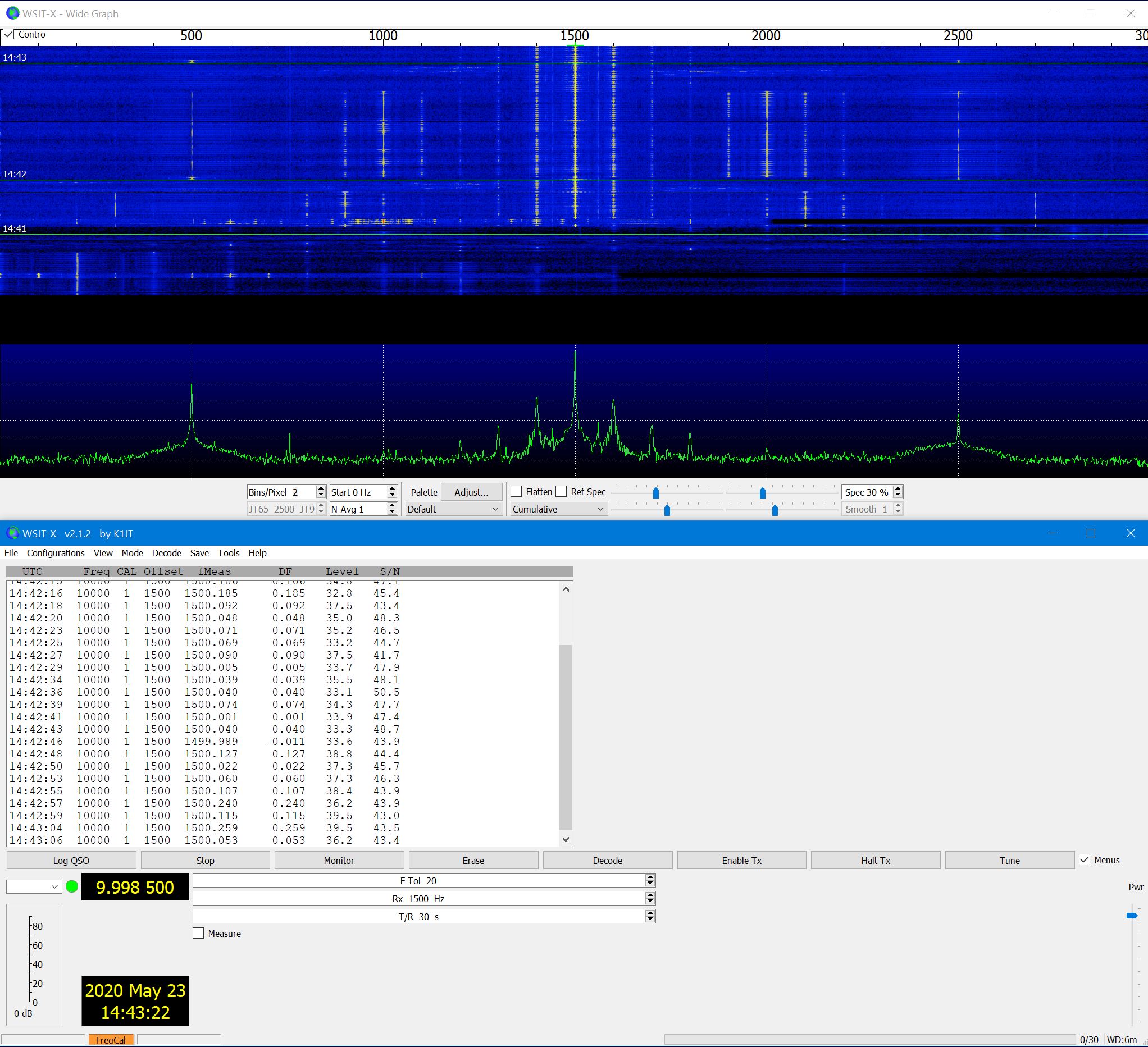

Not seeing this problem here. Running Thetis 2.7.0 (a3). I used WWV on 10MHz around 1030 local time in DIGU mode as the calibration signal. Resampler on or off, I saw some wobbulation (I love that term :D ) on the order of +/- 0.2Hz, and during any 15 second epoch (commensurate with FT8 transmission length) it was typically but not always much less than that.
I need to do this experiment over again with a signal generator so that I can remove ionospheric variability from the measurement.
If you are having trouble with the resampler and wish to use it try changing your VAC buffer size and/or ringbuffer settings.
Pay no attention to the WWV sidebands in the plots below, they changed like crazy depending on what was being modulated by WWV at the time. Only the carrier counts. Band conditions also changed quite a bit over the 20 minutes I played with this.
Resampler ON:
Resamp ON DIGU.JPG (569.34 KiB) Viewed 91316 times
Resampler OFF:
Resamp OFF DIGU.JPG (515.91 KiB) Viewed 91316 times

Posting my results, using latest versions of SW and FW on ANAN-8000DLE. One is re-samper-on ("Force" unchecked) and one is re-sampler off ("Force" checked). In a one-minute time period at 15 MHz (WWV), I get 0.297 Hz variation checked, 3.4 Hz unchecked - a factor of 11.4 difference in "wobbulation".
(BTW, notice on the right, I'd just earlier worked 3D2AG on 17m with re-sampling off. I'd been unable to get a reply with re-sampling on. Off took 2 calls.)

Chris,
How are you getting it to make any measurements in FT8 mode? I have to be in Freq Cal mode to get it work.
What happens when you put WSJT-X in Freq Cal mode and select DIGU on the radio?
I just did another test with 2.2.0RC1. No difference. It was a bit better, but I think that's because the ionosphere for this trial was less active.
I also plotted the frequency deltas versus time. No real pattern, which again suggested random, ionospheric induced propagation effects.
Resamp ON 2.2.0RC1.JPG (526.23 KiB) Viewed 91270 times
