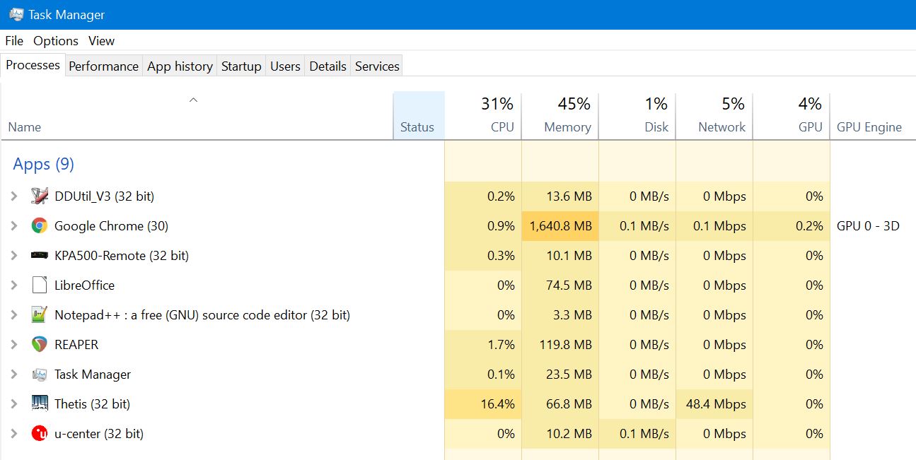

i have tryend already all the possible metods to avoid background processes ,even before anan.
this is Thesis on stadby mode. is more then 30%...
task manager.jpg (201.56 KiB) Viewed 16362 times
my CPu is I-7600U , but i found out that U versions are slower and for laptop to extend battery life. this one has only 2 cores. i guess this is one of the problems.
@Scott you say that Thesis need high graphic resources because is old software. can be that i need pc or laptop with dedicated card?
this laptop and the other desktop i have tried they both have intel integrated video card that really is working under the main cpu , so may be cpu is working more and for this have so high %.
can be the missing of a dedicated Video card the problem?
