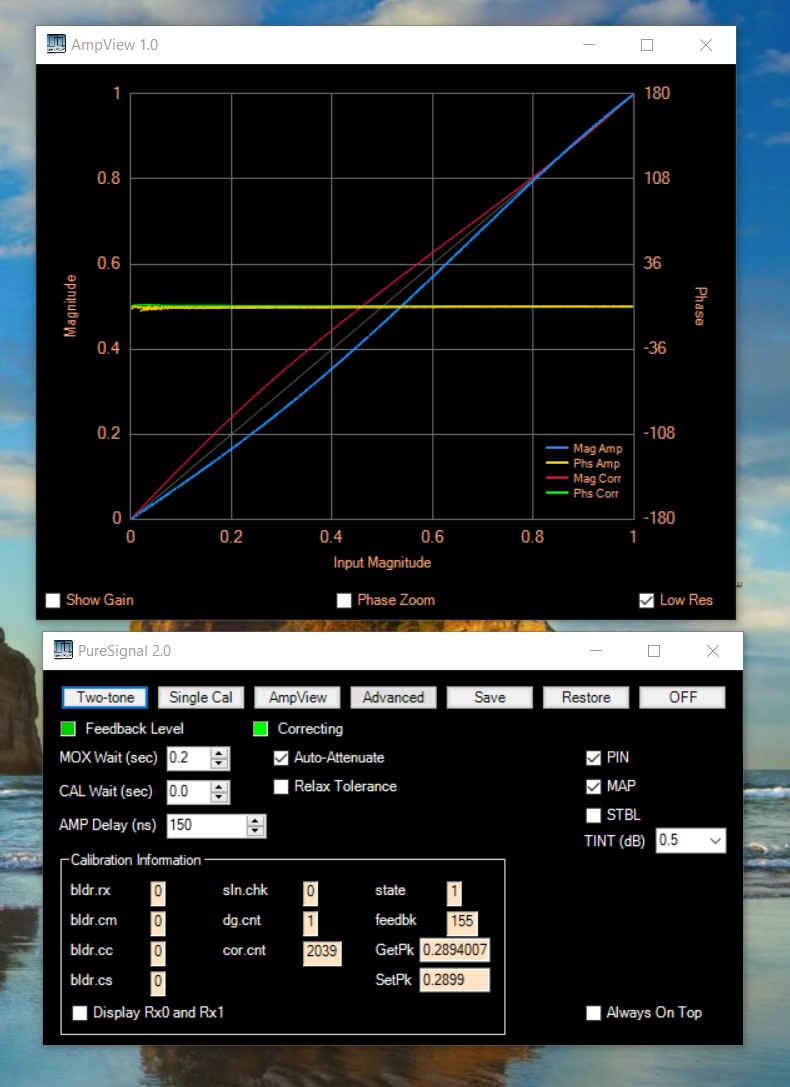

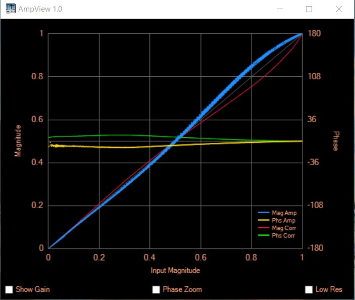

Hello
trying to set anan 7000dle with expert 1,3k and Xtronic XDC-1
i'm setting the xpert at low-mid level for now that shuld have 600 to 800kw outut power.
with input power of 5w. With 10w in will give more then 1kw. but for the moment i don't have an attenuator pad. so will not try for the moment
From my calculations the only Xtronic should be ok for this level for in power and output. But i think there is something wrong
Result are this:
5w only of anan - ATT is 5
test2 5in.jpg (129.71 KiB) Viewed 19115 times
5w in / LOW 600w out ATT 26 .
test 5in-800w.jpg (128.36 KiB) Viewed 19115 times
Re: Anan 7000dle and pure signal setting
Posted: Sat Jul 20, 2019 7:24 pm
by DL2XY

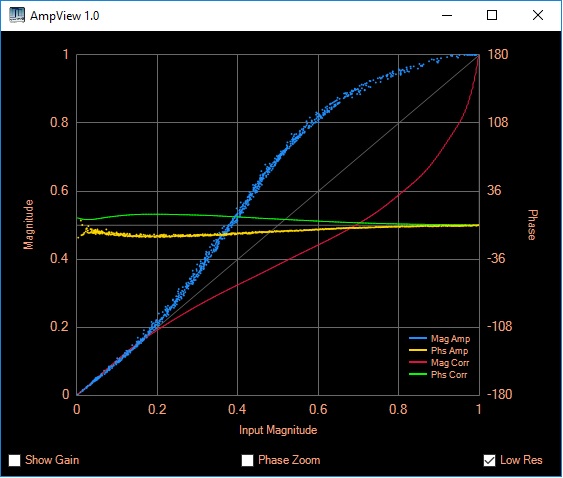

The amplifier is clearly overdriven (clipping), look at Mag AMP (blue Line). It touches 1 on Y axis at X=0.9.
In the higher part the blue line is widened, an indicator for a weak power supply.
I think you cannot expect 600W output in "LOW" setting at only 32V drain voltage.

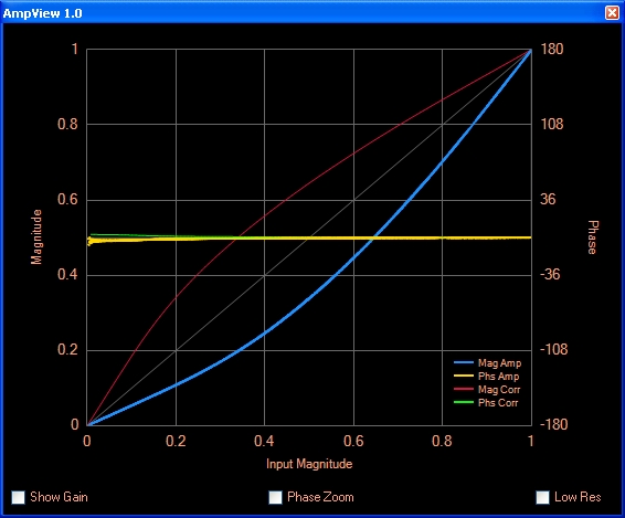

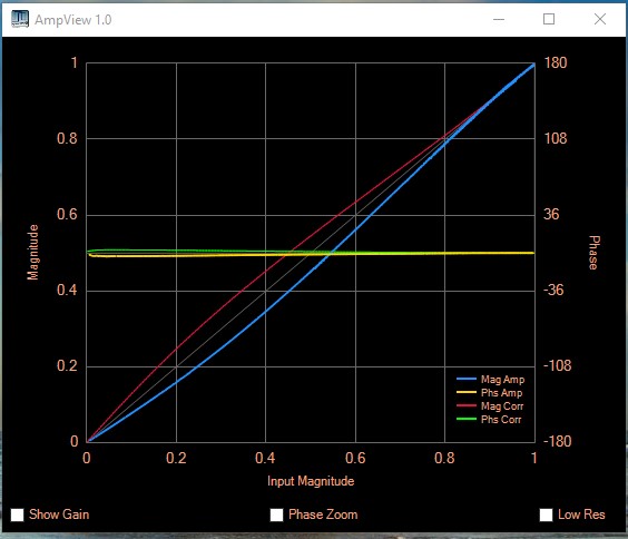

This is how it should look, 600W and 1000W output of an ACOM 1200S (50V Vd):
AV ACOM 600W.jpg (78.69 KiB) Viewed 19076 times
AV ACOM 1000W.jpg (78.45 KiB) Viewed 19076 times
73 Walter
Posted: Sun Jul 21, 2019 12:46 pm
by w3ub
The 1.3 is a good amplifier (I have one), but the top end characteristics are soft, what you are seeing is the way it is, you should probably back it off a bit, although the PS can do a good job of linearization, you gain nothing in terms of output power and are completely dependent on PS to keep things in check.

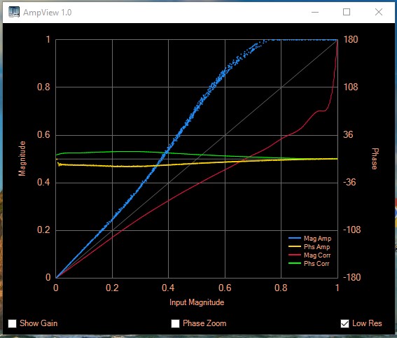

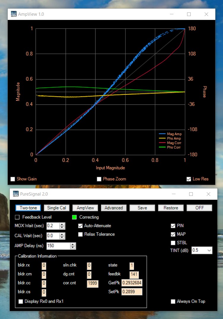

now i have all hardware set.
Xtronic XDC-4so
-20dbpad from Forward port to bypass port
TX with 10w
out 1200w
ATT now goes on 10
but wave form i think is still not correct
test 5in-1300w.jpg (49.2 KiB) Viewed 18963 times

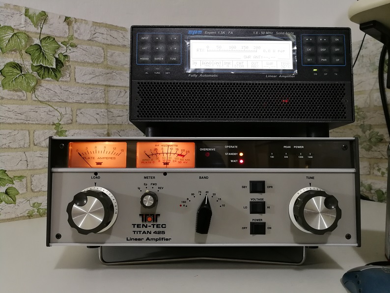

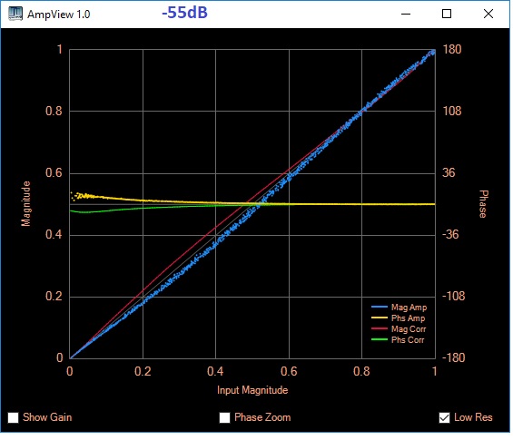

I am afraid Doug is pretty much right in what he is saying, I have experienced more or less the same behavior, to less extent on the latest 1.5K-FA MK2, which uses the 1K8 module, redesign output transformer and improved cooling system, see pick attached.
At the same rated power, I compared the Titan 425, as you can tell, the outcome is rather different
Posted: Sun Jul 28, 2019 12:04 pm
ik7ytt wrote:now i have all hardware set.
Xtronic XDC-4so
TX with 10w
out 1200w
ATT now goes on 10
Everything appears to be working correctly with the radio and coupler but you are VERY BADLY over-driving your amplifier, and there may be a problem with the amplifier input circuitry.
First, with the step attenuator at 10 that means you have a level of -1dB at the Bypass input connector (see this link for how that is calculated). That means +19 at the output of the coupler, and given a coupling factor of 44dB for that coupler, that means 63dBm at the amplifier output, or 2KW. That is much higher than the rated output of that amplifier and it clearly has to be in a fully saturated, badly compressed state.
Second, look at your AmpView results. The blue line is COMPLETELY flat (horizontal) at the top. Where it becomes flat is where the amplifier simply has no more power to deliver. Again, this shows the amplifier in a badly over-driven, completely saturated state. And you continue to drive the input level higher WELL BEYOND that point. You are absolutely hammering that poor thing. I've never seen anyone over-drive an amp that hard! :o Bad, bad, bad, and I can't believe the amplifier input over-drive protection circuits have not tripped the amp into a fault/standby condition.
There is no way that only 10W should drive the amplifier that hard unless the amplifier input attenuator has been removed, modified, or damaged. And the amplifier input protection circuitry should have tripped. This further implies that the amp is damaged in some way. And 1200W output is definitely wrong. The power meter that you are using (maybe it is the one in the amp) also has problems. The output is definitely higher than that.
You must reduce your maximum drive level into that amplifier, or get the amplifier repaired.

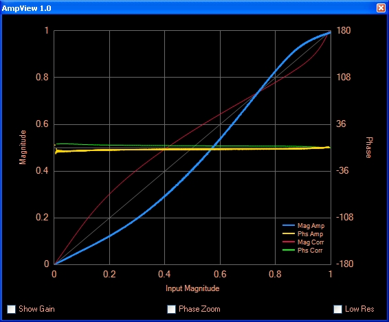

i remove the att and bypass cable and i use the software PS-A as in the beginning and have this results that i think are correct
software ps-a.jpg (45.13 KiB) Viewed 18866 times
with this setting i have
6w in 1kw out ATT=3
9/10W in 1,2 /1,3w out att=5
i can also increase power a bit wihtout any distortion from above setting.
then if i add the coupler we had the result like this with no distortion if i keep the power at 6w, with att still high.
if i increase the power as i usually was driving the amp at 10w we have the distortion as the previous picticure.
test new settings.jpg (53.5 KiB) Viewed 18866 times
