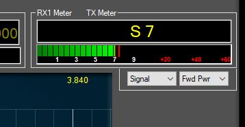

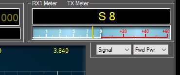

Anyway, after a couple of hours (more like days) I had made the following changes :
a) Added double click to stereo PAN sliders to recenter them
b) Attempted to improve redraw rate of the controls on main screen
c) Fill the space to the right for VFOB panel with auto resizing RX1 Meter
d) Updated ORIGINAL meter to use text scale from EDGE meter, and remove the string/text box solution
e) Centralised duplicate code for RX1/RX2 ORIGINAL meter code into one function called from both places (should really do this for Edge as well eventually)
- new_original.JPG (18.85 KiB) Viewed 31968 times
- resize_edge.JPG (18.61 KiB) Viewed 31968 times
b) is the most awkward. Using transparent controls doesnt help matters either, but does allow for nice looking interface. I may add an option to fill the backgrounds of all controls, which would then require a suitable skin. As far as I can tell, the main culprit for slow redraw is ResizeConsole(), but a quick two line addition to delay repaint until all controls have been moved has improved things slightly.

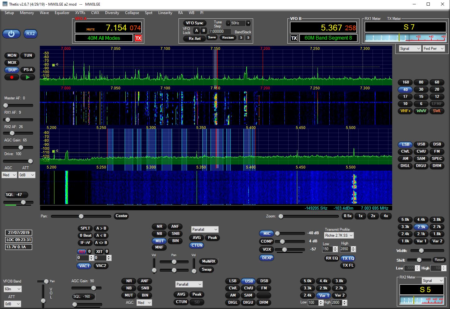

Posted: Sat Jul 27, 2019 8:38 am
ok, have been somewhat busy
- Managed to get dual parafall displays in. Quite a bit of work/changes to make that happen. First pass on this.
- Fixed a bunch of other things that have cropped up including band limits for the UK, and displaying band edges correctly outside the US.
- I have added colour/alpha fill option to the panadapter data.
- A new check box to disable picDisplay.png (you could manually rename picDisplay.png from skin folder). Having a stretched background image in the panadisplay has quite a big impact on refresh rates.
- RX2 now no longer increases window size unless necessary
- Progress bar flicker fixed
Next on the list is to work on the clickdragtune stuff on rx2 panafall, and look at getting the notch display stuff working.
There are so many changes now to the source that I might be an issue for me to work out the git hub changes, but I will do my best in a couple of days.
73 Richie - MW0LGE
- dualPanaFall.JPG (276.14 KiB) Viewed 31888 times
