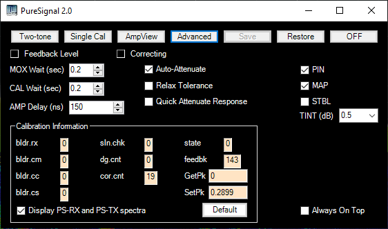

Hello Scott,
after the 2.8.11 release of Thetis, as far as I know, Richie made some more modifications to PureSignal 2. (As of today 21K9)
Can you add/explain these changes here in this thread?
For example:
"Quick Attenuate Response"
See attached screenshot
Alex DL1KD

See here:
https://apache-labs.com/community/viewt ... nse#p14610
Quick attenuate response option added in PS Advanced linearity window. When selected feedback level is sampled at 20ms instead of 100ms

I'm not going to attempt to explain them. My terminology is greatly lacking sufficient accuracy. I find it easier to understand a lot of the changes by breaking them out of the list and group them.
There is nothing wrong with the way he did it. If I had a memory like Scott and Richie have I'd be ecstatic. I'm creating my own lists of sorts. Here is the list I made from what I found in update 21K9b. There are a couple of others that had mention of PS. I did not find any value in those and did not list.
1. fix: PS 'Correcting' should show again on main ui if PS-A is toggled and PS is in correcting state
2. fix: PS client side state machine prevented from turning off autoCal when it needs to stay on. Fixes issue with PS not calibrating when PS-A button is cycled outside TX
3. add: quick attenuate option added to ps form. If PS auto-atten is on and this is enabled, ps feedback calculations will be made 5 times more often
4. add: quick attenuate response option added in PS Advanced linearity window. When selected feedback level is sampled at 20ms instead of 100ms
5. change: PS client loops do not run if power off
6. change: 31dB TX attenuation is now only applied when PS-A is off, and mode is CW when tx'ing
7. change: PS loop(s) are now in own thrfix: background colour fix for Advanced button in PS formead instead of a UI timer(s)
add: right click ps-a button opens linearity form
8. fix: PS enabled with DUP off will now show in correct position in spectral display

and one more....
add: PSpeak will be saved if you adjust it, default button to reset it (linearity form)
The PS peak value is related to firmware version, which in all actuality is chosen based on protocol in use. Some more info in this thread... https://apache-labs.com/community/viewt ... =20&t=4097
