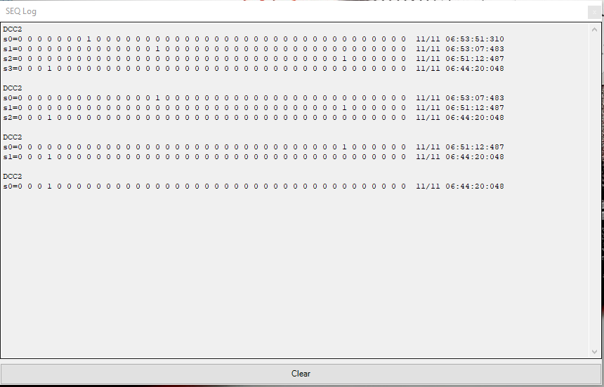

Heres a shot of my log from this morning. Same errors I got yesterday as well. At this time, i was running OBS and making a recording, streaming WebSDR, and had Thetis maximized to 1920x1027. Zero audio glitches, no drop outs, no freeze ups.
W3MMR

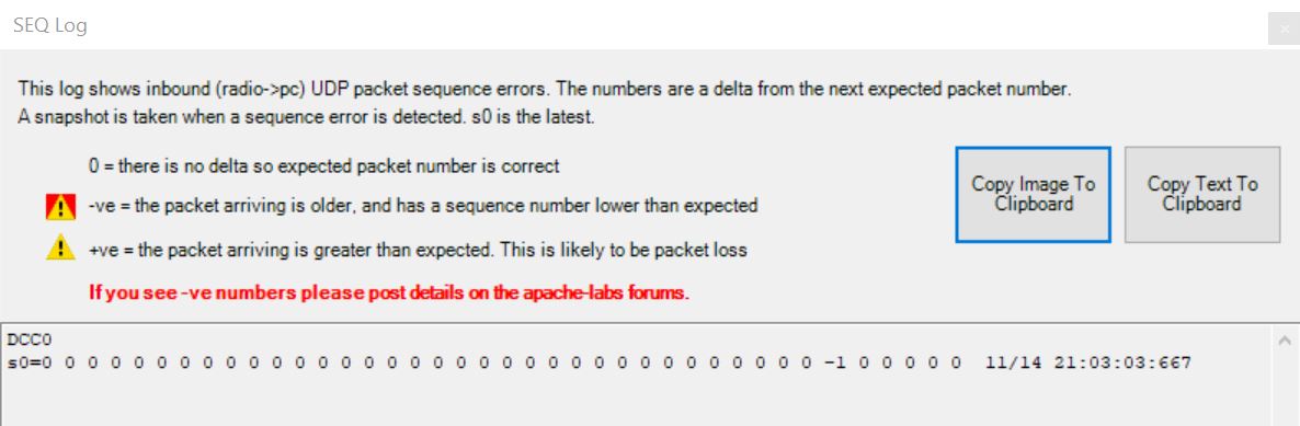

Posted: Fri Nov 15, 2019 2:08 am
And finally...
Re: Fun with SEQ Log :-)
Posted: Fri Nov 15, 2019 4:17 am
by w9mdb
Where is this seq log located?
Posted: Fri Nov 15, 2019 10:37 am
by W4WMT
w-u-2-o wrote:And finally...
The dreaded "repeated" packet, aka a "rewind" packet!
Any clue as to what kind of network hijinks can cause something like that Scott???

s7=0 0 0 0 0 0 0 0 0 0 0 0 0 0 0 0 0 0 0 0 0 0 0 0 517 0 0 0 0 0 0 0 0 0 0 0 0 0 0 0
s8=0 0 0 0 0 0 0 0 0 0 0 0 0 0 0 0 0 0 0 0 0 0 162 0 0 0 0 0 0 0 0 0 0 0 0 0 0 0 0 0
s9=0 0 0 0 0 0 0 0 0 0 0 0 0 0 0 0 0 0 0 0 0 0 0 0 0 0 0 0 0 0 0 0 0 0 0 0 0 0 0 59
s10=0 0 0 0 2 0 0 0 0 0 0 0 0 0 0 0 0 0 0 0 0 0 0 0 0 0 0 0 0 0 0 0 0 0 0 0 0 0 0 0
s11=0 0 0 0 3 0 0 0 0 0 0 0 0 0 0 0 0 0 0 0 0 0 0 0 0 0 0 0 0 0 0 0 0 0 0 0 0 0 0 0
s12=0 0 0 0 0 0 0 0 0 0 0 0 0 0 3 0 0 0 2 0 0 0 0 0 0 0 0 0 0 0 0 0 0 0 0 0 0 0 0 0
s13=0 0 0 0 0 0 0 0 0 0 0 0 0 0 3 0 0 0 0 0 0 0 0 0 0 0 0 0 0 0 0 0 0 0 0 0 0 0 0 0
s14=0 0 0 0 0 0 0 0 0 0 0 0 0 0 0 0 0 0 39 0 0 0 0 0 0 0 0 0 0 0 0 0 0 0 0 0 0 0 0 0
s15=0 0 0 91 0 0 0 0 0 0 0 0 0 0 0 0 0 0 0 0 0 0 0 0 0 0 0 0 0 0 0 0 0 0 0 0 0 0 0 0
s16=0 0 0 0 0 0 0 0 0 0 0 0 0 0 0 30 0 0 0 0 0 0 0 0 0 0 0 0 0 0 0 0 0 0 0 0 0 0 0 0
s17=0 0 23 0 0 0 0 0 0 0 0 0 0 0 0 0 0 0 0 0 0 0 0 0 0 0 0 0 0 0 0 0 0 0 0 0 0 0 0 0
s18=0 0 0 0 0 0 0 0 0 0 0 0 0 0 0 0 0 0 0 752 0 0 0 0 0 0 0 0 0 0 0 0 0 0 0 0 0 0 0 0
s19=0 0 0 0 0 0 0 0 0 0 0 0 0 0 63 0 0 0 0 0 0 0 0 0 0 0 0 0 0 0 0 0 0 0 0 0 0 0 0 0
Posted: Fri Nov 15, 2019 5:09 pm
w9mdb: they may be good or bad. If you have a torrent of these reports then it is bad, and indicative of a problem somewhere. The potential problem list is LONG.
If it's just a few now and again and you don't hear anything (pop, clicks, etc.) then it really doesn't matter too much and it's nothing to stress over.
Posted: Fri Nov 15, 2019 5:14 pm
by w9mdb
How does one know if it's a torrent? There's no time tag on these things.
Does the seq log just keep appending? That wouldn't seem like a good idea unless these sequence problems are very infrequent.
Posted: Fri Nov 15, 2019 5:24 pm
A couple of things.
a) you are using version without time stamps, so log is a bit pointless, the s0-s19 could be spread over hours, we cant tell
b) there are no -ve numbers
c) all +ve's signify packet loss, which can be 1e6+1 things
d) a new snapshot drops s19, adds s0, and everything moves down
s0 is the latest
s19 is the oldest
e) the packet delta (received sequence number vs expected) following your large number deltas are 0, which 100% implies that you have packet loss. After that loss everything resumed correctly, you didn't see any of those old packets coming in after the event (would be signified by -ve numbers)
See here : https://apache-labs.com/community/viewt ... t=90#p8975
