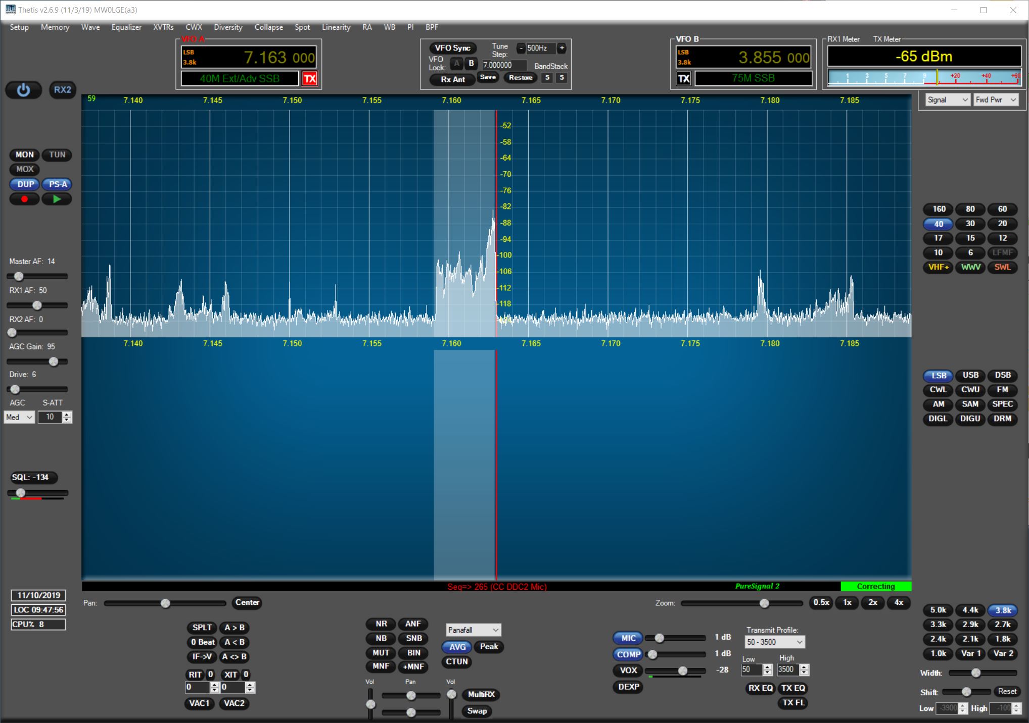

Loaded up pre4 last night. Ran fine last night and again this morning for 3.5 hrs, mostly listening, then was in QSO with some friends and had a lockup. Without resetting the radio or relaunching Thetis I hit the power button and worked for about ten seconds and locked up again. There were some error messages so I made a screen capture as follows...
Thx
Carl
NX5T

Carl: does it work better or worse than pre1 or pre2? Which is best for you? And are you using a 7000 or 8000?

I can't say one is any better than another. Once it reaches the point of failing all of them fail again repeatedly after a short amount of time (seconds). Did the error code have any significance to you? Is there something you'd like me to try?
I'm going to run it more to look for a pattern, but I honestly think it's a problem in my system, although quite capable, somewhere.
Carl
