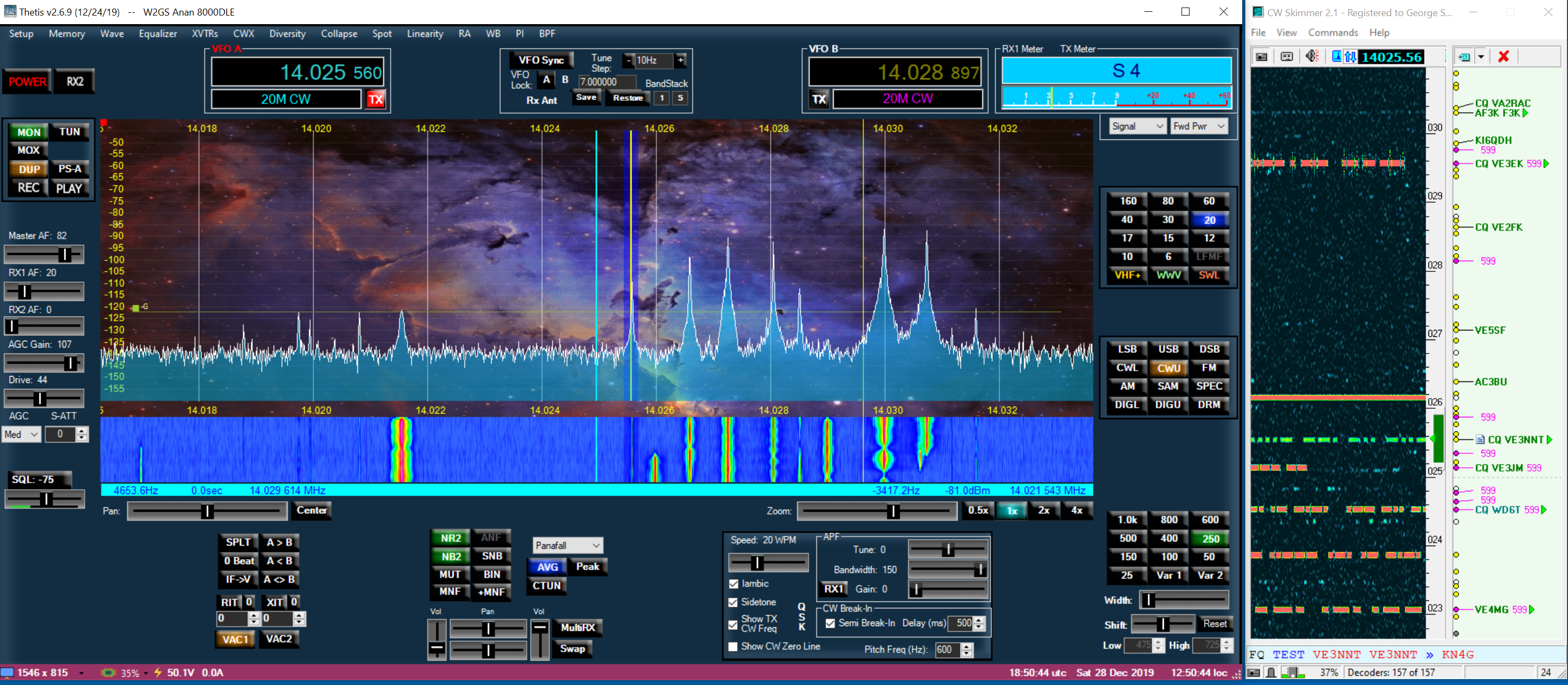

I will post this to the Apache forums. Here is an example of the Thetis/CWSkimmer issue.
1. All the sample rates have been set to 48K. I tried faster sample rates (results were no better) but to remove a lot of variables I used 48K for the rig, VAC and CWS.
2. In order for CWS to track the rig frequency the CWS audio IF has to be set to -600HZ. This is opposite to HPSDR where +600 HZ is used. All previous versions of HPSDR used +600Hz
3. Notice there is a solid line about 600HZ above the selected frequency of 14025.560 on the CWS waterfall. This doesn't appear in HPSDR when using Windows WDM-KS. This artifact will blot out any signal in this area.
4. Looking at both the panadapter and the CWS waterfall you can see that there are five strong signals from 14026KHz to 14030KHz but only one signal at 140295KHZ shows up on the CWS waterfall. This signal doesn't correspond to anything in the Thetis panadapter.
5. On the panadapter waterfall there is the remains of signal about 600Hz above 14025.560. This signal was blotted out by the artifact in CWS that appears at around 14026.2.
I am not sure what's going on here but I would not think there were many changes made in this area of the Thetis software since all this working properly under HPSDR, VAC and CWS. This may be a timing issue or a sample rate problem; I can only speculate. I would be happy to test any changes to the software to resolve the above problems. I know that there may be higher priority issues the developers are working on but sooner or later this should be addressed.
73, George

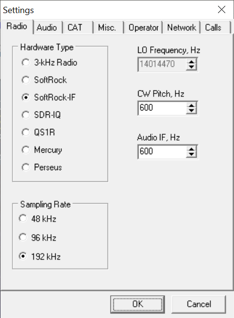

Re: Thetis and CW Skimmer

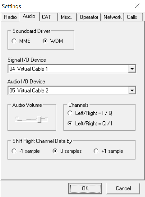

Attached are the Radio and Audio tab from CWSkimmer that are need to completely resolve the subject problem. See the previous post for VAC and Thetis settings.
73, George
W2GS
73, George
W2GS
- Thetis CWS Radio tab.PNG (38.66 KiB) Viewed 35440 times
- Thetis CWS Audio tab.PNG (40.09 KiB) Viewed 35440 times

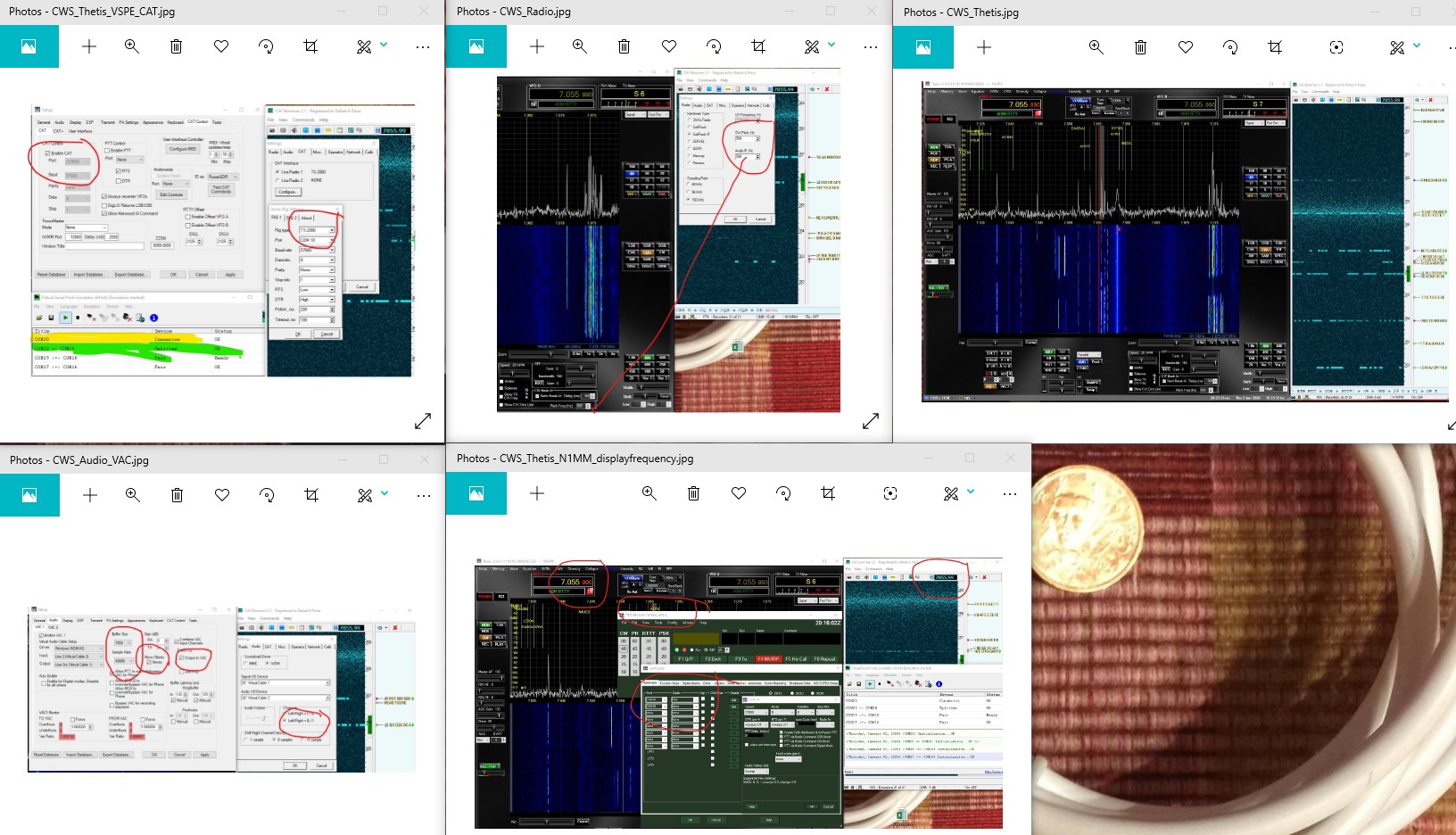

Hi, Gary and good morning all!
The system does not allow but only three (3) pics in one shot? So I took a snapshot of all of the snapshots and the penny and cable is part of the desktop...hihi.
I will try and see if I can post pics in several posts....or link to a Word document that I've created...stay tuned!
Rafael / NN3RP

As promise, here is a Word document with the main pics and notations:
or...here is a OneDrive link showing all of the snapshots taken in the production.
https://1drv.ms/u/s!Al_5NCnHQyKatBsSWk_ ... R?e=OryL47

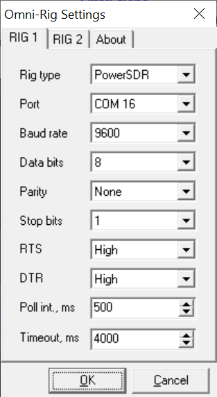

Here are my Omni Rig settings in CWSkimmer.
73, George
W2GS
73, George
W2GS
- Thetis CWS Omnirig.PNG (23.68 KiB) Viewed 35288 times
