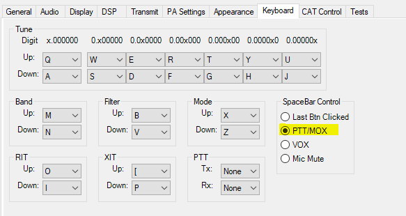

By the way, the PTT by space bar seems to not work now - yes, I enabled MOX by space bar - but that is no problem since the footswitch is available in any mode.

For spacebar PTT have a look at the pic.
Hi Sigi,
that is the solution. Thank you! :-) Enable shortcuts was not ticked.
Space bar working Norbert , thank you very much .
