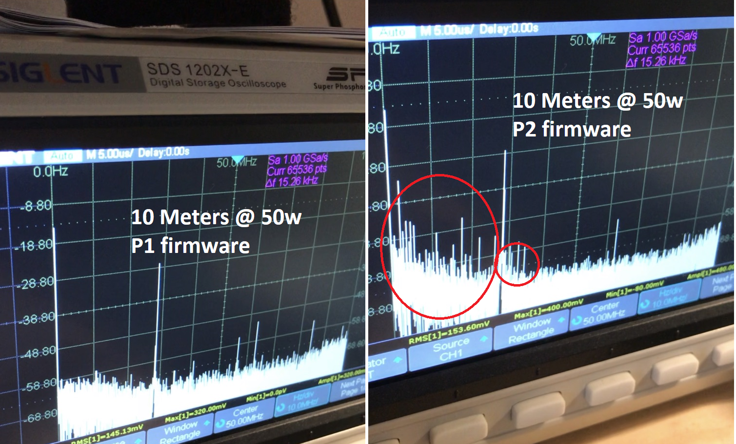

Thanks for the info. I scanned the source code and do not see anything wrong with the filtering code. I believe it is working correctly.
I did some more tests but this time with an FFT scope on the output, using the TUNE button at 50 watts into a dummy load. All processing disabled in DIGU mode.
My original belief that this was a 6M-only issue was wrong. It gets better as you move up in the bands but it's always there.
Attached are my 10M results side by side. 6M is worse.
Posts: 6109
Re: New 100D Angelia Protocol 2 Firmware Topic
Elevated noise floors are a symptom of the firmware not making timing on your hardware. Try a different version of the P2 firmware. The latest is not the best for everyone.

I tried every available firmware from 11.9 and up.
11.9 - Clean RF, glitchy audio
12.0 - No RX or TX
12.1 Pre1 5070 - Clean RF, clean audio
12.1 Pre1 5171 - Spurious RF, glitchy audio
12.1 Pre1 5670 - Clean RF, clean audio
12.1 Pre1 5770 - Clean RF, clean audio
12.1 Pre2 - Spurious RF, clean audio
12.1 Pre2 5550 - Spurious RF, clean audio
12.1 Pre4 - Spurious RF, clean audio
So guys/gals, even if your radio seems to be working fine and you're getting good signal reports, you might want to check on a external scope that you aren't emitting out of band RF spurs. Puresignal seems to work fine on the "clean RF, clean audio" releases I listed above, and does not work on the spurious RF versions. So if your PS isn't working, you may be emitting spurious RF....

Hi all, I am new to the world of Anan but have had fun over the last couple of week playing with a "new to me" 100de.
It came to me with Protocol 1 v5.8 firmware installed. I used if for a week with the last version of PowerSDR mRx to get a feel for the software and radio. No problems other than user errors caused by me not knowing my way around the software.
Wanting to try Thetis I upgraded to Protocol 2 with Firmware 12.1 pre1-5770, to my surprise everything seemed to work but I kept getting "seq=>2 (ddc0)" errors. So after looking around I was under the impression to try different firmware so I jumped up to the latest 12.1_pre4. This got rid of the seq errors but now I had "adc1 overload" all the time but only on 20m. I was also finding my Auto ATU was constantly returning on any band 20m and above. I thought it was an rf issue and spent some time going down that avenue. In the end I though I would go back to the initial protocol v1 and see if everything went away. It did, ATU stopped retuning every time I keyed up.
The new Thetis 2.8.7 has now been released so today have done more tests with this . Using Protocol 1 everything works fine so I thought I would try P2 again with 12.1_pre4. Same issue with constant ATU tuning but the "adc1 overload" didn't appear.
Having read a lot on this forum I decided to try P2 11.7_7-15-18 and everything appears to be fine. I am running 384000 sample rate and the only thing I can say is a had the "seq" error once while using FT8 via VAC.
Can anyone explain why my ATU behaved like it did on the other firmwares?
Also using Puresignal I see feedback in green but sometimes in red, never did in mRx. is this anything to worry about? where can I read more about the correcting and feedback warnings?
Tnx
Paul

If the other versions of firmware were not making timing closure on your hardware then it is possible that the RF waveform emitted during tuning could have been non-sinusoidal and thus confusing your tuner.
Before I answer the PureSignal question, are you using an external coupler with an external amplifier?

Thanks for getting back to me. No not using a coupler or amp with the radio. I did find a bit more info last night that explained the red feedback was due to not being enough drive for it to sense properly, but it didn't explain how to increase this.
As for the tuning issue, it did tune fine with the tune button. it was when transmitting on SSB it went nuts.
