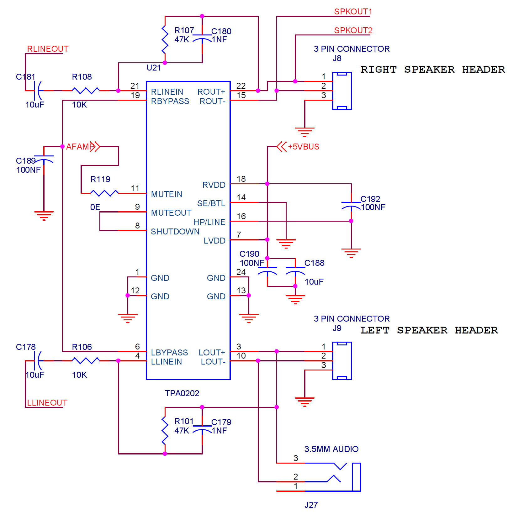

Re: Powered Speaker for my setup !!
Posted: Sat Apr 04, 2020 2:08 pm
N7CXI wrote:Is the audio amp power amp on a separate board from the Orion II? If so, perhaps I could make a "reversible" modification and bring a line-level signal out from the radio board. ?? I have the "manual", but it fails to provide much in the way of technical information.
At this time the 7K and 8K schematics are not publicly posted but are available upon request from the factory.
If by reversible you mean without cuts and jumpers on a board the answer is "no".
The amp chip is on the main Orion MKII board.
The easiest way to get line out levels would be to cut/jumper the breakout/connector board on the rear panel to re-purpose the DIG IN RCA connectors. Left and right line-out are available on the ribbon cable that comes from the Orion MKII.
Nevertheless, you really shouldn't be having problems with the output of the headphone jack. I wonder if there is some cracked solder on that jack that could be touched up.
N7CXI wrote:Actually I haven't tried the headphone jack yet, just the rear-panel jacks. I'll think about that. The impedance is all wrong, but as long as the audio amp doesn't care about that it might be worth trying.
I would not recommend that. Here is a snippet of the schematic. You can Google the data sheet on the TPA0202 amplifier IC for more information. The outputs are configured in bridge-tied mode. If you ground either side of a speaker output, or tie them together, your risk damaging the TPA0202.
