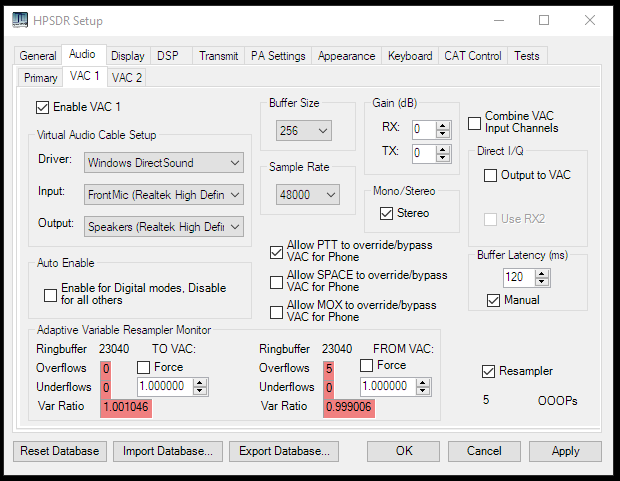

I have a problem with my ANAN7000 DLE Mk II when I select the MON function. There is a rapidly increasing howl round even though I am using a headset, so it is impossible for me to monitor my own transmit audio. I have attached my audio setup, so that maybe someone can tell me what to change. I have only had he rig a week or two, so am still finding my way round the numerous menus.

Is your headset connect to the rig or the computer?
You've got the computer mic/speakers as your input/output devices so when you click MON the rig audio comes out the speakers and feeds back into your computer mic and/or headset mic.
So select your headset instead of the speakers as your output device.
