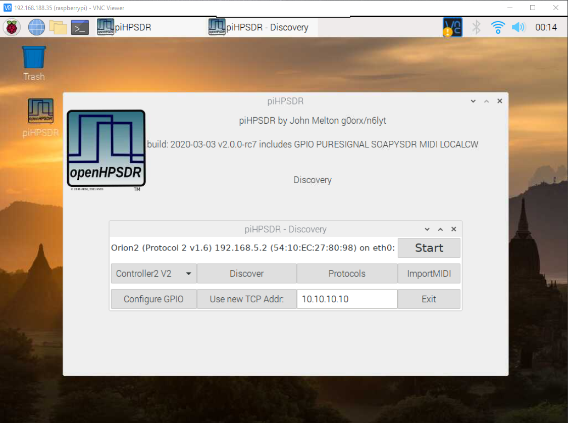

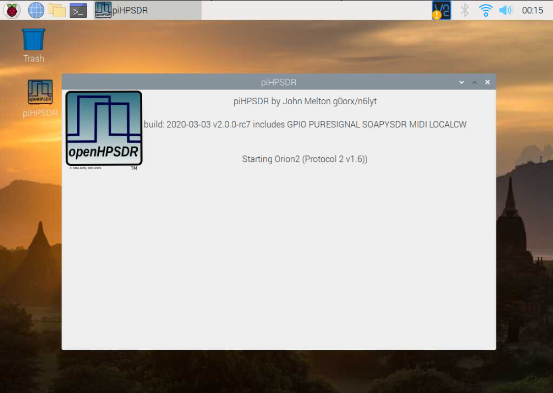

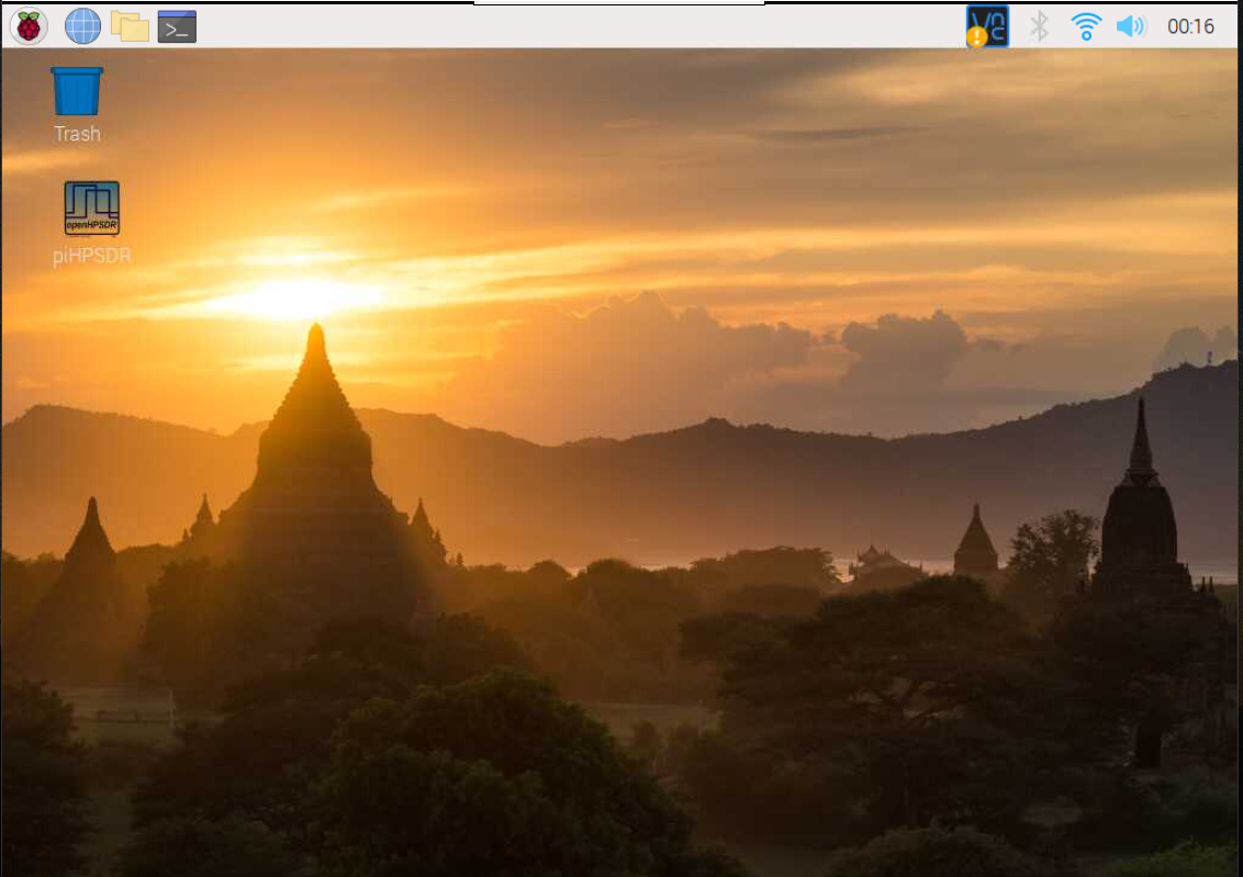

I am looking for any advice that can help me to fix the following issue:
I installed last piHPSDR version in my Raspberry Pi 3. Despite installation was successfully, and piHPSDR recognized the Anan, the piHPSDR does not show up, please see attached screenshot.
I am accessing the Raspberry PI via VNC, also I setup a static IP (Anan connected directly to Raspberry Pi using Ethernet port.
Thank you for any advice,
Al

i had a similar problem a month ago. Set Controller V2 to none. then it should work.
73, Michael. DC0ZO
