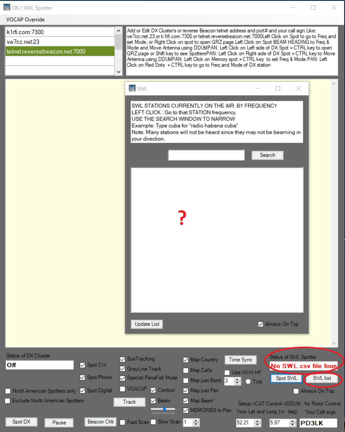

Hi Scott, there must be some kind of association cos Thetis can't find that file. (see pict)
This file is also mentioned in the PowerSDR manual but it doesn't tell in wich map it belongs.
- SWL csv path.jpg (288.45 KiB) Viewed 8448 times

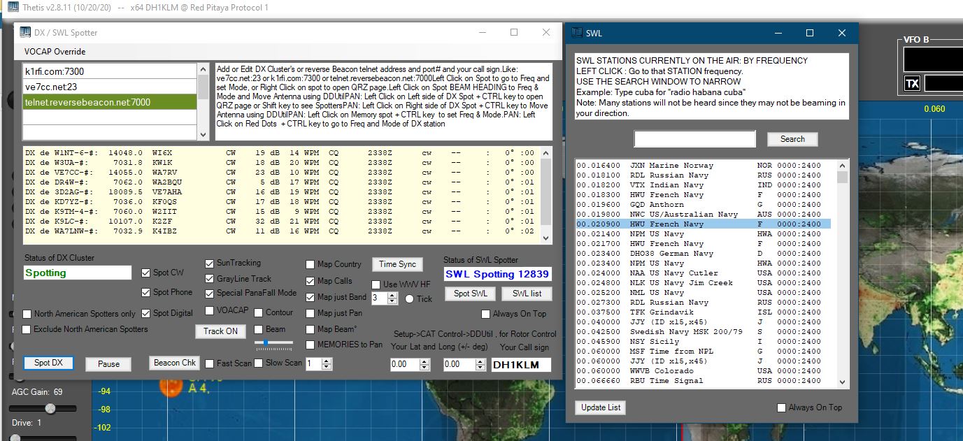

ok, here you go
1. download the csv from http://eibispace.de/
2. after the download rename it to SWL.CSV
3. move this file to C:\Users\YOURNAME\AppData\Roaming\OpenHPSDR\Thetis (or \Thetis-x64, depending on which version you are using)
4. start Thetis and open Spot (at the top)
5. click on the button Spot SWL. Status of SWL Spotter should say in BLUE text: SWL Spotting xxxx (xxx is the number of active SWL entries in the file)
6. if not successful go back to 1 and try again ...
7. click on the button "SWL list", click always on top (if you wish)
8. close the parent window (DX/SWL Spotter)
9. done
Note: this list shows only the ACTIVE stations, based on the time frame in the 4th column.
So you have to refresh the list regularly (button: Update List)
The list works one way: list => Thetis. So it doesn't follow you visibly when you do the tuning yourself.
(unfortunately) The spots don't show up on the FFT or WF.
