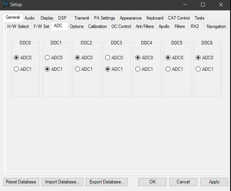

When running PowerSDR on my 200D, I had the ADC tab set this way:
What would be the corresponding setting in Thetis? Thanks.

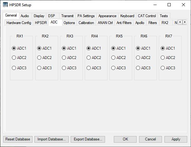

Actually, I think it would be all ADC0 across the board.
This assumes you want RX1 and RX2 to be assigned to the same ADC, of course, which is what you had in PowerSDR.

Come to think of it, I cannot remember what the DDC assignments are in P2/Thetis and a quick forum search did not turn up much. Is that documented anywhere?

All ADC0 is correct for my case. Thanks, wu2o.
