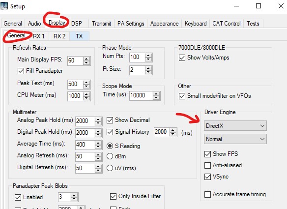

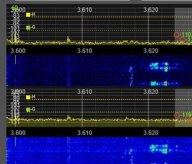

There is an issue where H & G lines are not drawn on RX2 when using GDI+ render engine. Change over to DirectX render engine and it should be there, and also be a much better experience.
