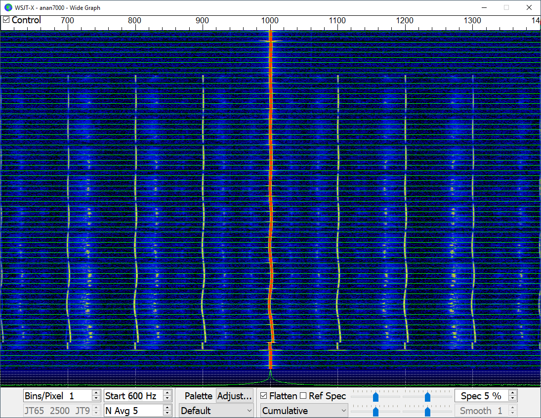

I am running an ANAN-7000DLE with PowerSDR mRX 3.4.9 and WSJT-X 2.1.0 using Virtual Audio Cable under Windows 10. Recently I am plagued with spurious images of any moderately strong signal on FT8 (say, 0 dB or better) where I get "ghost" signals and decodes spaced +/- 100 Hz from the main signal. Depending on the strength of the real signal, there can be two to four of these spurs on either side. This is when operating on 6M; I don't have antennas available right now to check on other bands so I don't know whether it's specific to that band or not (my guess is not).
I've messed around with audio level settings, turning the rational resampler on and off, and pretty much everything I can think of but nothing seems to make a difference.

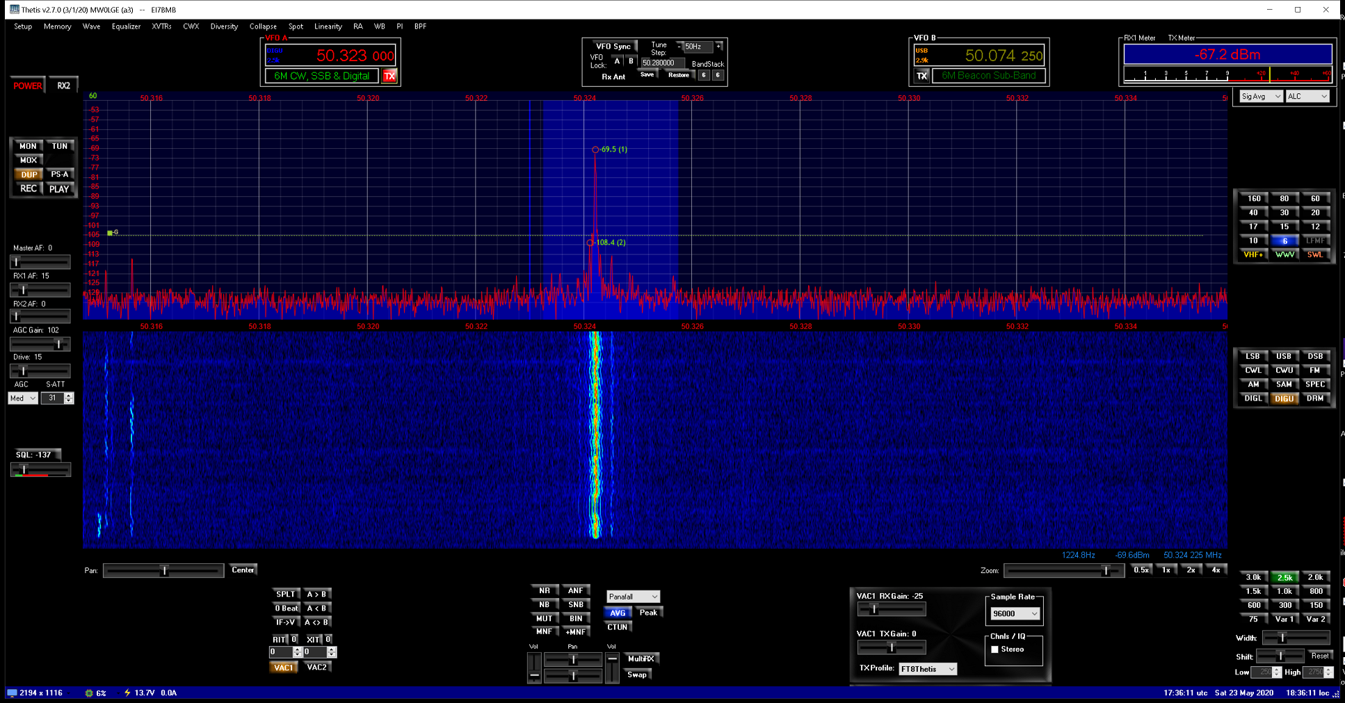

Heres one , although its very strong this also happens on some weaker signals
Re: WSJT-X FT8 signal images
If you are talking about that tiny spur within 100Hz of the signal that is not an "image". That is a close-in spur. Given that it is -38dBc, it is probably an intermodulation product ("intermod") that is part of the transmitted signal. Intermod's from the average, un-linearized, amateur radio transmitter are typically in the -40dBc range. They can become visible when the signal exceeds the noise floor by more that 40dB.
Perhaps that pic is not a great example Scott but the images I speak of are 100 hz apart usually. On the transmission in the pic you can see this on the jtdx waterfall which I'll post next time i see a clear example.

Wow, I didn't realize my post would generate this many comments! I think I resolved the problem, though I'm not certain just what did it.
The ghosts i saw were *not* in the PowerSDR panadapter window, but in the WSJT-X window, and were basically duplicates of the strong signal spaced at 100 Hz intervals above and below, the more distant ones becoming weaker.
In the end, I wiped out all the audio settings in both PowerSDR and WSJT-X and things cleared up. I suspect the culprit might have been using a Windows sound interface other than MME; when I reset it was set to WDM-KS (for reasons I don't recall).
Anyway, after that reset, and using the MME driver, I haven't seen the problem recur.

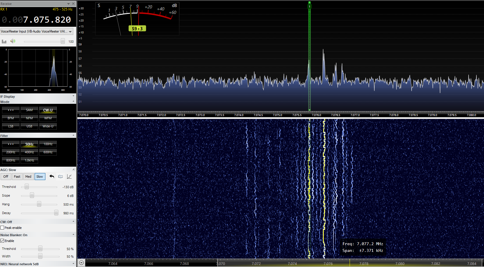

I think the following picture illustrates the phenomenon quite nicely (recorded with SDR Console on 40m).
There are two strong signals visible. The left one has pronounced intermodulation, at least two or three lines in parallel on either side. The right one, even though much louder, has much less pronounced intermodulation copies.

I am pretty sure this is *not* what some people are seeing in their PowerSDR panadapter windows. I do not see obvious signs of spurs there when my problem is occurring (though I have certainly seen bad transmitted signals there!).
What I am reporting is visible in the WSTJ-X waterfall display and always results in multiple decodes in the WSJT "band activity" text window.
Further use indicates that the problem is probably on the WSJT-X side as restarting that program will normally resolve the problem for a while, but if left running for several hours, the ghosts may reappear.

Nigel, what you described is definitely part of what I was seeing. This afternoon I was able to nail down what's going on, though perhaps not quite why. The spurs, as well as a frequency wobble, are caused by the rational resampler. See the attached shot which shows a stable, unmodulated carrier at about S9 injected into the receiver. At the bottom is the start with the rational resampler turned off. Then I turned it on and you can immediately see:
(a) frequency wobble over 10 or so minutes while the resampler finds the mark and settles down; and
(b) strong 100 Hz sidebands that stop when the resampler stabilizes.
The little noise burst at the top is when I turned the resampler back off.
So I am virtually certain that the "ghost" decodes I am seeing are the result of these spurs caused by the resampler. When things stabilize they go away, but I am guessing that temperature changes, CPU load, or other things could cause the sample rates to intermittently drift, causing a new stabilization cycle and ghosts while that happens.
I haven't messed with the resampler settings but I think my rates are close enough that simply leaving the resampler off might be my best solution.
