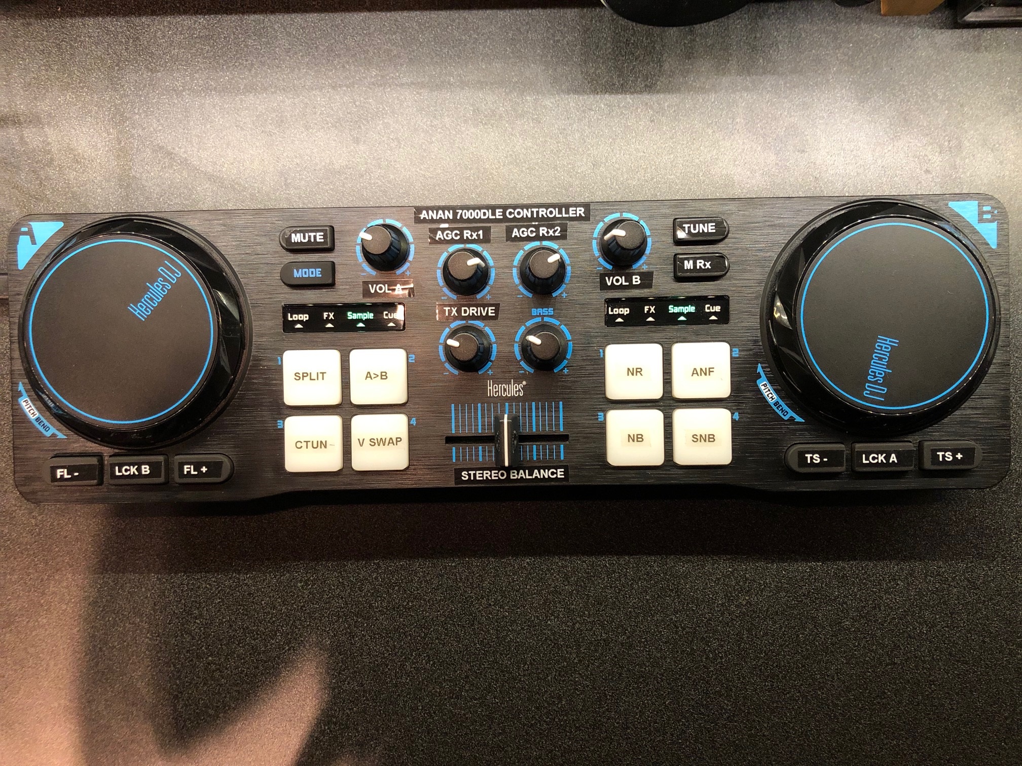

Here's mine with more knobs and sliders

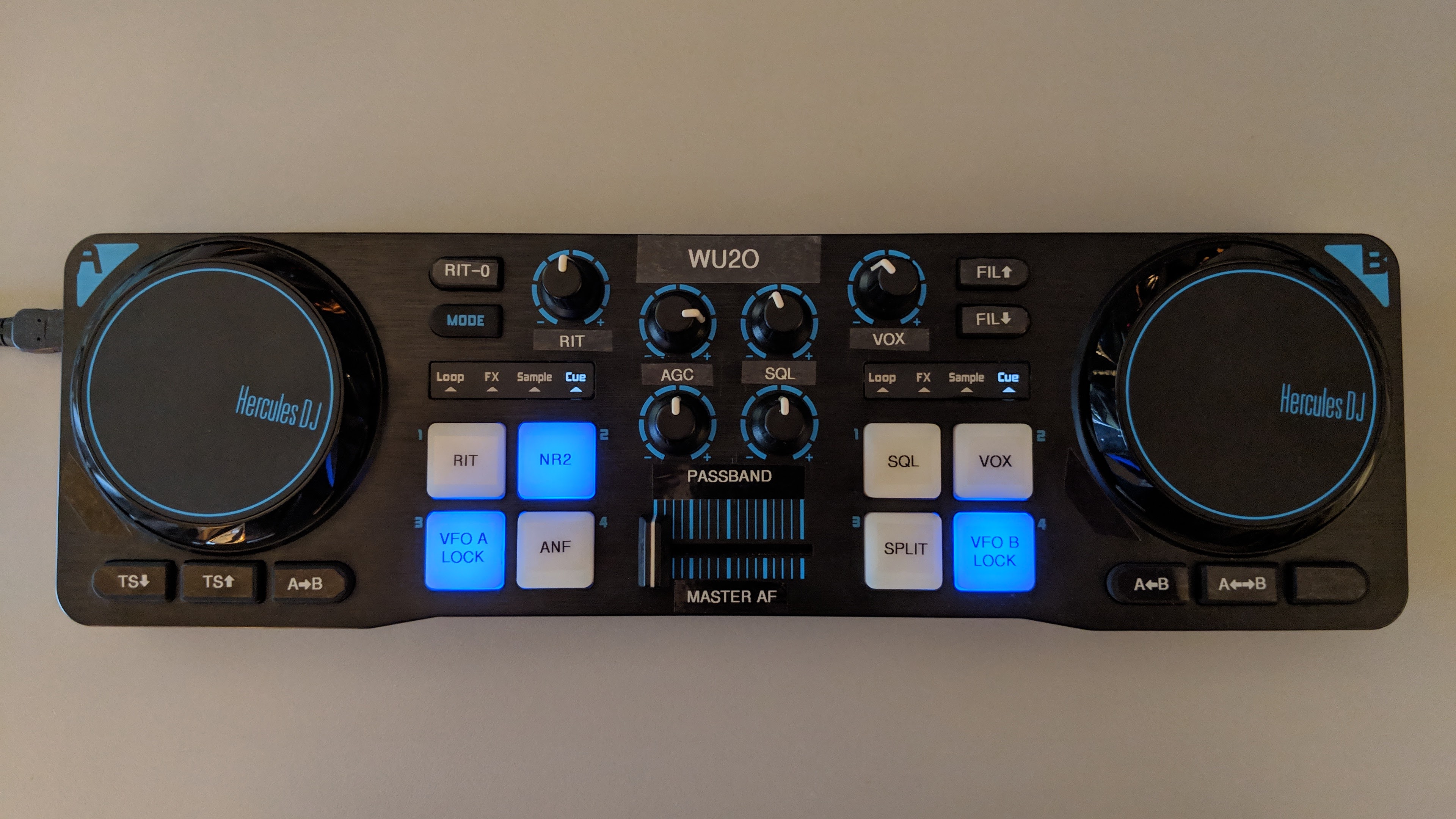

The DJControl Compact has a very interesting feature that I have not yet exploited, mostly because I'm happy with the buttons I have. On this controller you can actually assign 4 different functions to each of the white buttons, except for right-hand button #1 which, as you pointed out Paul, is limited to 3 functions.
The way you can access the other button modes is to hold the MODE button down and press white button 1, 2, 3 or 4. The indicators over the white buttons will show Loop, FX, Sample or Cue, as appropriate. This works separately for each of the left and right bank of white buttons.
I had thought about making labels split into four quadrants for the white buttons, but ultimately decided I didn't need more functions than I already had.
One way to use this capability would be to have different sets of buttons for SSB, CW, etc. Another possible use would have you setting the right bank into MODE 2 (FX) so you get all four buttons.
Once you get it relatively stable, it would be interesting if you would post a photo of your button assignments, Paul.

My current setup with the DJControl Compact controller, but subject to change with use. VFO A right wheel, VFO B left. Filter step below left wheel, Tuning step below right wheel. VFO Lock center below each wheel.
As of this posting, the DJControl Compact is USD $59.99 from several on-line vendors.

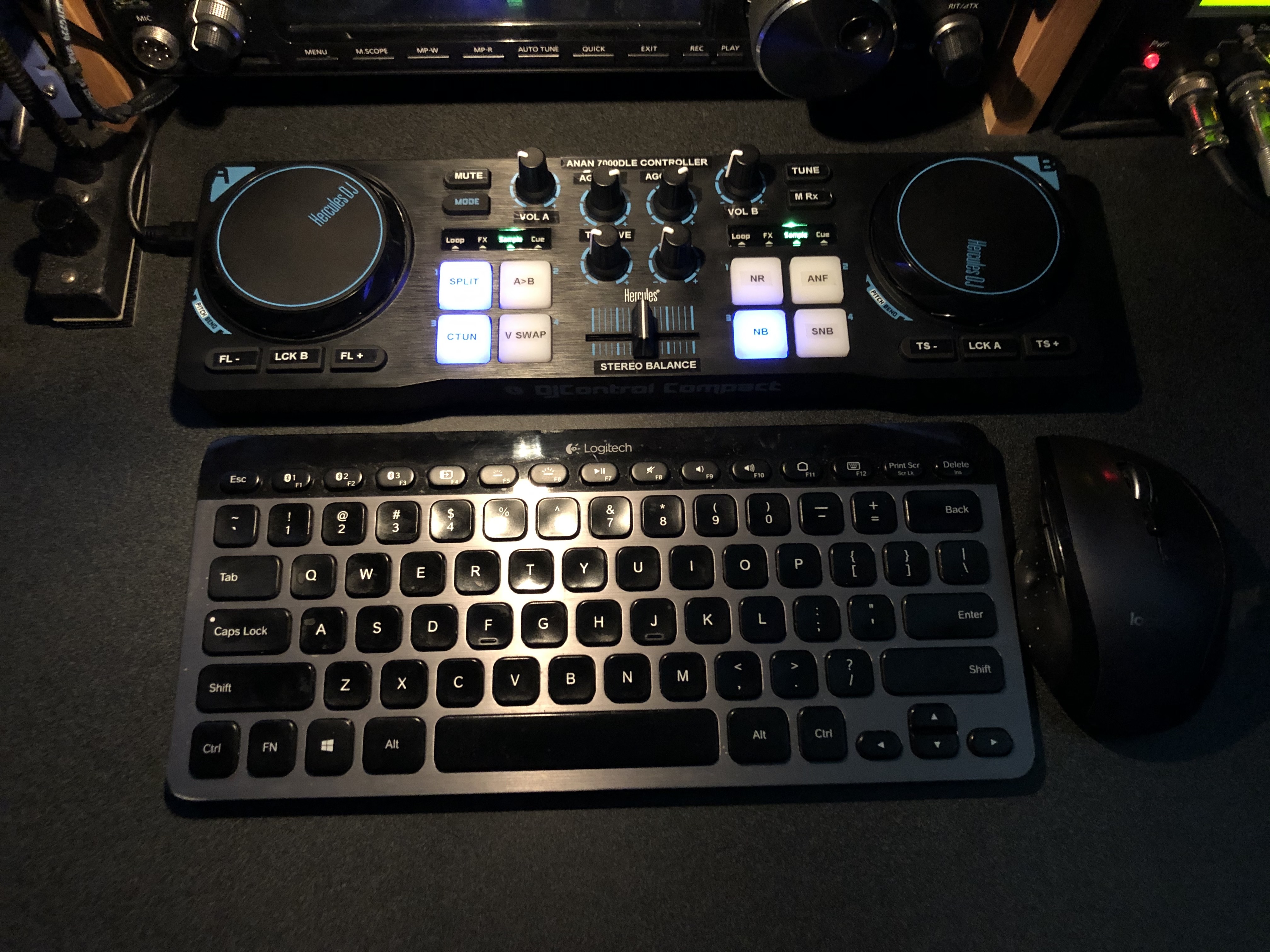

Operating position in back of Logitech Bluetooth keyboard. Pay no attention to the IC-7610.

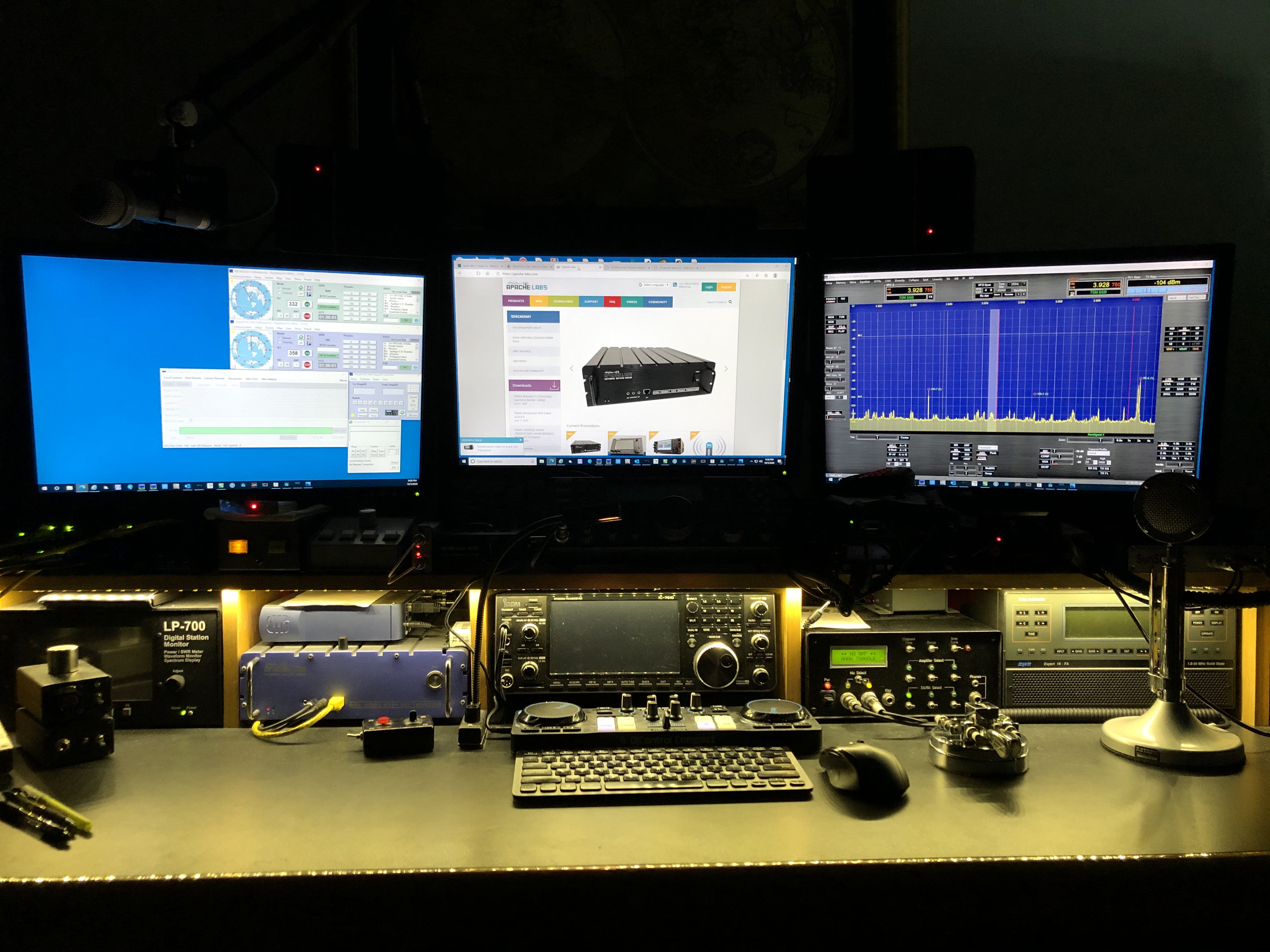

Widescreen view of the operating position. Adjustable-intensity LED lighting under the riser. Studio mic can be seen above left monitor. Old faithful D104 still used on the desktop. Custom designed ultra hi-fi mic preamps in front of the LP-700 wattmeter.
