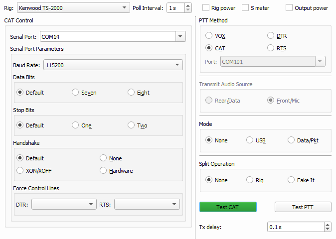

In JTDX under setup -> radio, the 'Test CAT' function turns green when pressed but the "PTT" function won't and returns an error "Hamlib error: Command rejected by the rig while setting current VFO mode"

Thanks again for your help. Am using the TS-2000 entry. When I try controlling the rig directly using rig-ctrl.jdx as you described above, it works properly. Some further tests :
1. Did a clean install of JTDX rc152.
2. Set up a new unique rig name for this test.
3. Under "settings -> radio tab, entered TS-2000, appropriate com port for Cat control / PTT
4. Press "Test Cat" -> turns green, Press "PTT" -> works properly
5. Hit 'OK' to close the settings dialog box.
6. Immediately re-opened the "settings dialog box -> radio tab, Press "Test Cat" -> turns green, Press "PTT" -> get the Ham lib error, doesn't work now.

It works fine using the method you described! My settings are the same as you've got listed except for:
- different com port
- serial data set a 8 bits, one stop bit
- mode is set to data / packet.
Tested it again putting all the settings exactly the same as you've got above w/ the exception of the com port- same behavior; PTT doesn't work.

I tried setting Thetis setup -> CAT -> "ID as" from TS-2000 to PowerSDR, and selected FlexRadio PowerSDR in JTDX rc152's radio setup; and PTT now works properly (as far as I can tell).
