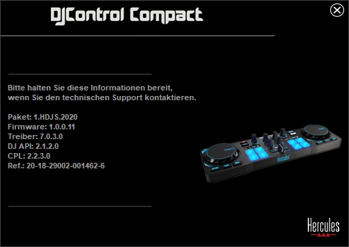

I have to control drivers at this point.
Have you installed the Hercules suite of DJ controller or only the USB driver that is automatically installed by Windows when you plug in the first time the controller USB cable?
Re: Slowing Wheel Tuning Speed
Posted: Mon Jul 05, 2021 9:40 am
by oe3ide
I have also installed the Hercules software.
Image 4.jpg (57.16 KiB) Viewed 10793 times
