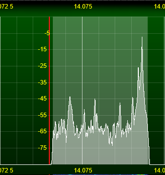

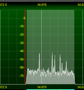

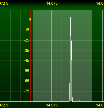

I also see a noise burst at the start of a transmission, in this case it is FT8. The noise looks like it is coming from the receiver just prior to the input from WSJT-X.
Since it is around 50db below the transmit level of 0dBm it is not a problem but I would rather it was not there. I wonder if there is a delay setting that can resolve this. Not sure if this is similar to what you are seeing.
- post noise burst
- 2021-03-27 09_14_33-Window.png (9.58 KiB) Viewed 21389 times

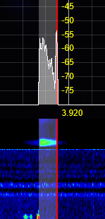

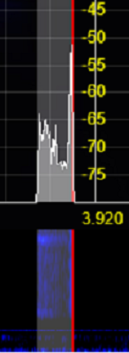

Yes Rob, Those settings didn't really make a difference. Here is what the burst looks like on the screen. It is the bottom capture. Above it is the same time frame with squelch enabled. From the responses it seems that others are having a similar issue. I'll keep looking and if I find the resolution, I will be sure to post the results.
- Burstpng2.png (29.91 KiB) Viewed 21363 times
- Burstpng.png (28.55 KiB) Viewed 21363 times

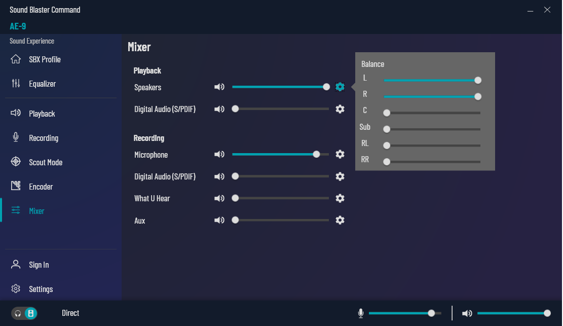

In the Sound Blaster Command app there is a setting that is called direct mode. It is supposed to bypass all settings and give the purest sound. All other settings are locked and cannot be changed when in this mode.w-u-2-o wrote:OK...so this is related to VAC use. I have used a wide variety of VAC configurations, some quite complex, and have never observed this problem. It is unlikely to be associated with the delay settings. I use 0, 0, 2 and 0, so even less delay than most. No problem.

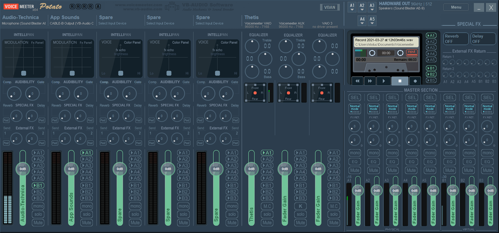

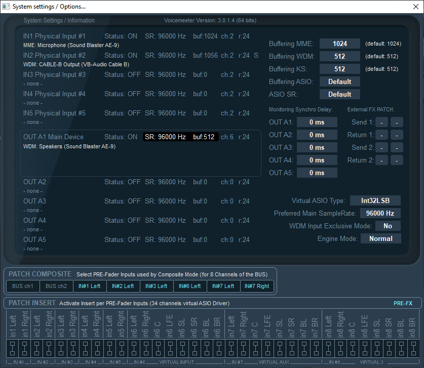

The Voicemeeter settings automatically followed the changes I made in the Windows 10 sound configuration. I have not tried adjusting anything there. I am open to any suggestions. Thank you for the help and information.
Edit: I have spent many weeks (if not months) investigating this issue. I get in no hurry. Solving these sorts of things is part of the fun I have in the hobby. I try to find solutions without troubling anyone else. I learn more when I solve issues myself. I love this hobby.
- SBSettings.png (73.78 KiB) Viewed 21353 times
- VMPSettings.png (89.31 KiB) Viewed 21353 times
- VM.png (175.53 KiB) Viewed 21353 times

Second, you need to match your sample rate on the Soundblaster to everything else. In Voicemeeter and Thetis you are using 96KHz. Set your Soundblaster to 96KHz. If you can't do that, then set everything else back to 48KHz to match the Soundblaster card.

Fourth, and perhaps most important, your settings in Voicemeeter don't make any sense.
- The channel you have labeled as "Sys Sound" is the one your are using for Thetis per your Thetis VAC screen shot above. So label it properly.
- I have no idea what you are using the B2 channel for, but it can't be Thetis. Label it properly.
- Is the B3 channel really assigned to and used by SDR Console? If not, label it properly.
- You want your Virtual ASIO Type to be Float32LSB.
- This is probably the problem right here: anything with a B1 Send assigned is going to send TX audio to Thetis. The ONLY channel that should have the B1 Send turned on is A1, the microphone input. Turn off all other B1 Sends!
- Anything with an A1 send is going to send audio to your Soundblaster speaker output. Turn off any A1 Sends that are not in use or that you don't want to send audio to your speakers.

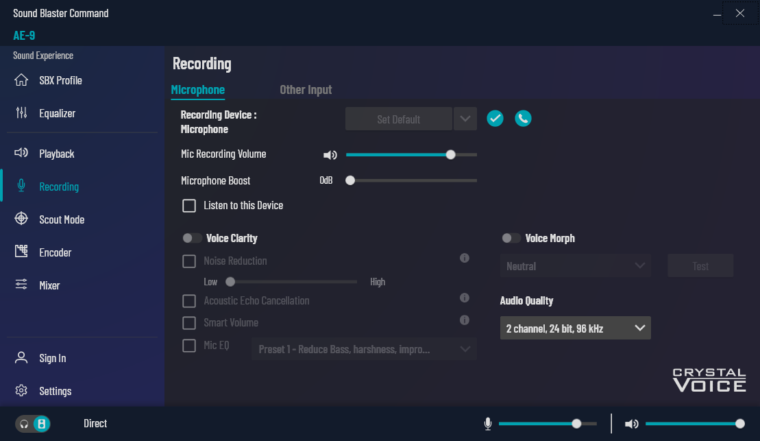

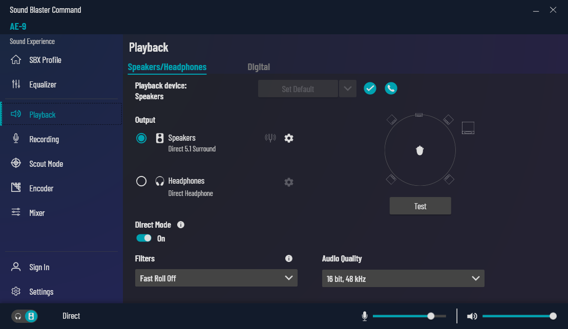

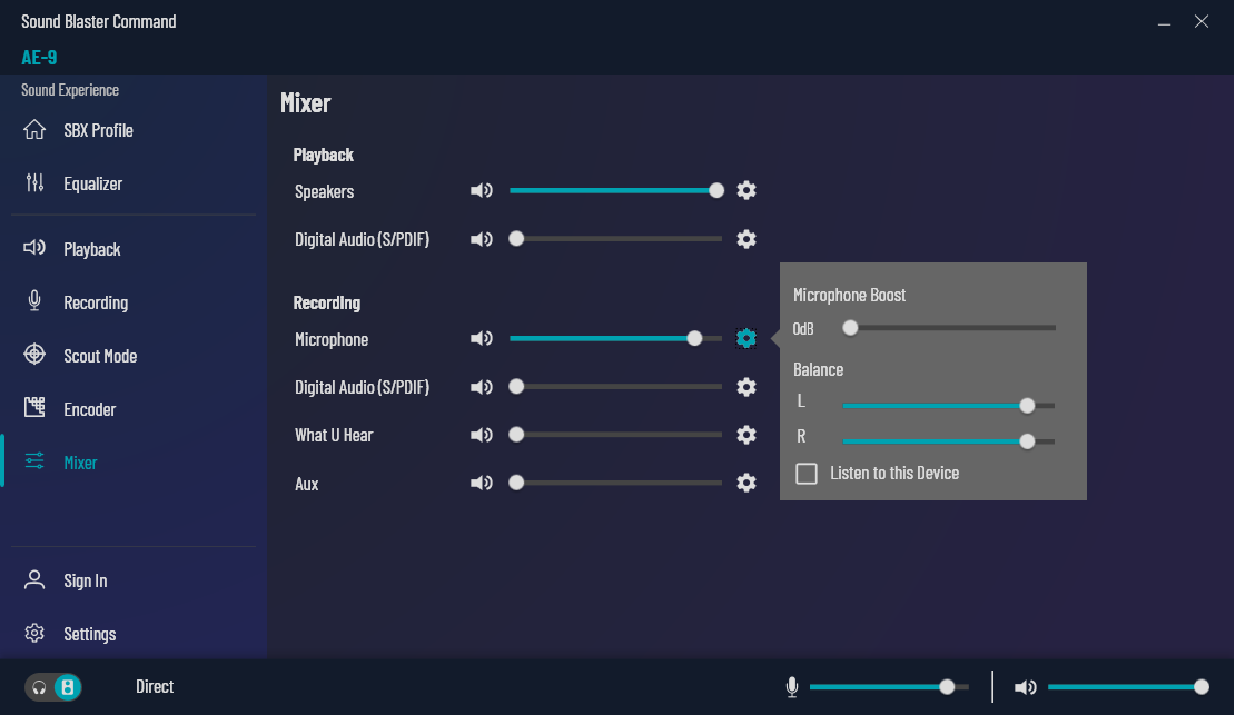

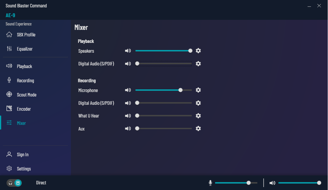

Sound Blaster Command is set to 96k 24 bit on both recording and playback settings. I set the Microphone boost to 0db on the recording settings screen. I read somewhere that the "microphone boost" should be set to 0db. Is this correct?w-u-2-o wrote: Second, you need to match your sample rate on the Soundblaster to everything else. In Voicemeeter and Thetis you are using 96KHz. Set your Soundblaster to 96KHz. If you can't do that, then set everything else back to 48KHz to match the Soundblaster card.
Screen capture is listed below. Where should Microphone Recording Volume be set?w-u-2-o wrote:Third, we need to see the recording settings on the Soundblaster.

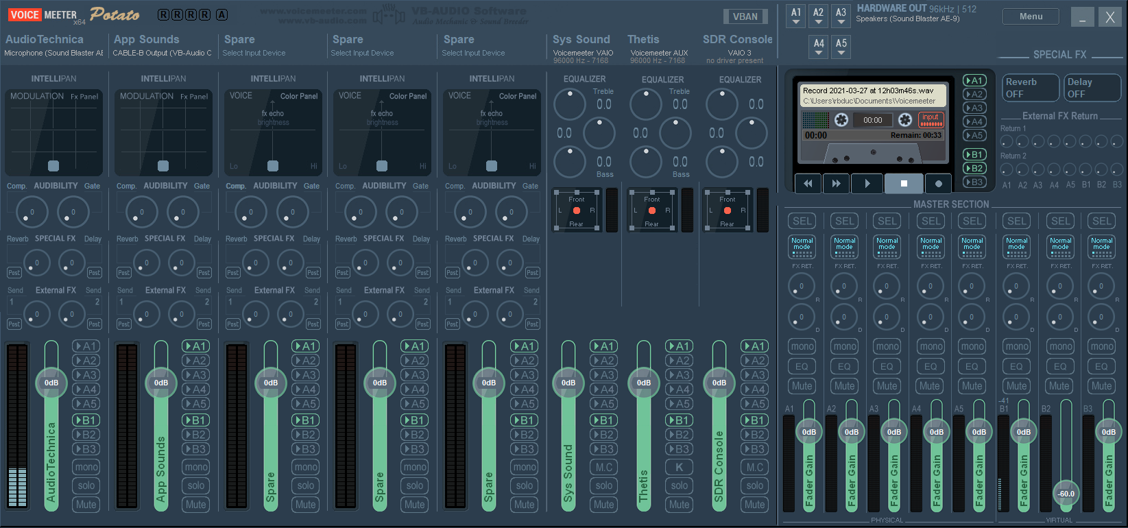

w-u-2-o wrote: Fourth, and perhaps most important, your settings in Voicemeeter don't make any sense.
I changed that all so it is correct.
It is still configured so I can use SDR-console, but it has been a long time since I have opened SDR-Console. I'll remove it. I can alwaysw-u-2-o wrote:- I have no idea what you are using the B2 channel for, but it can't be Thetis. Label it properly.
put it back later. Audio-Technica is set to B1. All others disabled.
Changed Virtual ASIO type to Float32LSBw-u-2-o wrote:- You want your Virtual ASIO Type to be Float32LSB.
The Audio-Technica channel is set to B1. All others are off.w-u-2-o wrote:- This is probably the problem right here: anything with a B1 Send assigned is going to send TX audio to Thetis. The ONLY channel that should have the B1 Send turned on is A1, the microphone input. Turn off all other B1 Sends!

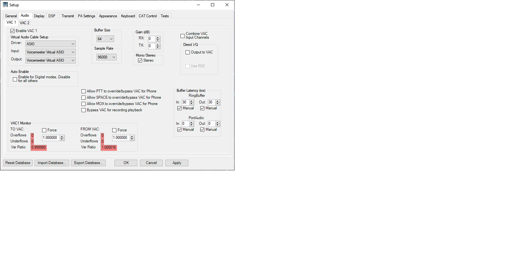

I have it all changed. I have verified that Pure Signal works correctly. The noise burst is still there. (drat)w-u-2-o wrote:Sort all that out and see what you have. But the very, very first thing I'd do is turn off all B1 Sends except for the B1 Send on channel A1.
So to summarize, I have set everything to 96k 24 bit including Sound Blaster Command. On the SB Command playback page the filter is set to "fast rolloff" and "96k 24bit"
One other question. In the Voice Meeter setup screen, Should "Buffering ASIO" and "ASIO SR" be set to "default?"
- SBRecordingSettings.png (81.64 KiB) Viewed 21301 times

One thing I noticed. If I disconnect the microphone or reduce the microphone level (Audio-Technica) the burst of noise disappears. So the noise is getting in through the microphone before the receive is muted on transmit. I need to locate a setting that kills the receive faster or delays the sound from the microphone. I'm thinking out loud here. I have something to look for now.
Re: Noise Burst on initial transmit
This is exactly as I posted above. But I'm still thinking there is an overt feedback path.rbduck wrote:One thing I noticed. If I disconnect the microphone or reduce the microphone level (Audio-Technica) the burst of noise disappears. So the noise is getting in through the microphone before the receive is muted on transmit.
I don't think there is a setting like this, and if there was it would create an unacceptable delay.I need to locate a setting that kills the receive faster or delays the sound from the microphone. I'm thinking out loud here. I have something to look for now.
Mic boost in your Soundblaster control panel is nothing to worry about. It is mic dependent. Generally you don't need it.
ASIO settings in Voicemeeter should be at "default".
I had hoped that you were getting feedback because of the settings in Voicemeeter. But it may be because of settings in the Soundblaster Mixer controls. I don't have a Soundblaster card but it was easy enough to download the manual. Zero out all recording mixer controls EXCEPT microphone.
Please post updated screen shots of the following:
1. Voicemeeter main UI.
2. Soundblaster Mixer Settings.
Here are the captures you requested. It was really early this morning (2am) when I went through and made changes. I went through again to make sure ai didn't miss anything. I've looked at the Sound Blaster manual and nothing jumped out at me. I went trough and reduced levels on all the mixer settings except Microphone and Speakers. I wet into the Speakers sub-mixer settings and reduced all but L and R. I posted those. Also on the Playback page I went into the settings menu next to the tuning fork. I changed the speaker configuration from 5.1 to Stereo.
After all those changes I tested it. The noise is still there. I tried something else. The output of the sound card is fed into an integrated stereo amplifier. We I turned the volume on the amp down the sound disappeared completely. Turned it up and it's there. Wit the sound off on the stereo amp, I increased the sound output via RX1 on the Thetis UI. The noise is completely gone. The intensity of the sound burst is directly proportional to the volume on the amp. (during the test) The louder the noise feeding into the microphone the more intense the burst.
I will continue to look for something in the chain that ma be inserting noise into the signal. I assume that is what you were suggesting?
Edit: The sound at this point doesn't seem to be nearly as pronounced as it has been. I need to speak with someone that originally pointed it out and see if they still hear it. If I can find an SDR station on line where I can make a decent recording, I will try that also.

- SBMainUI.png (171.71 KiB) Viewed 21270 times
- SBMixer.png (68.66 KiB) Viewed 21270 times
- SBMixer2.png (73.36 KiB) Viewed 21270 times
- SBMixer3.png (72.76 KiB) Viewed 21270 times
So when the amp volume is decreased and the RX1 AF gain is increased, can you hear the radio normally and at the same time not experience this problem?rbduck wrote:The output of the sound card is fed into an integrated stereo amplifier. We I turned the volume on the amp down the sound disappeared completely. Turned it up and it's there. Wit the sound off on the stereo amp, I increased the sound output via RX1 on the Thetis UI. The noise is completely gone. The intensity of the sound burst is directly proportional to the volume on the amp. (during the test).
In Voicemeeter, on channel A2, "App Sounds", what is that being used for? What happens if you disable the A1 send on that channel?
Just a thought - if your receive audio is coming out of your speakers then disable your speakers and test for the burst again. If the burst is gone then the problem is that your mic is picking up audio that's still coming out of your speakers after the PTT is pushed. If that's the case then you need to either 1) reduce the latency of the audio emanating from your speakers, or 2) increase the RF Delay in the General Options tab.
The channel labeled "App Sounds" is where I send all other sound from the computer. Youtube, Any sounds from the browser or from any other application. I send it to that channel through "Cable B." This is configured in Windows 10 "Settings>System>Sound." I had already disabled that. It made no difference.w-u-2-o wrote:So when the amp volume is decreased and the RX1 AF gain is increased, can you hear the radio normally and at the same time not experience this problem?rbduck wrote:The output of the sound card is fed into an integrated stereo amplifier. We I turned the volume on the amp down the sound disappeared completely. Turned it up and it's there. Wit the sound off on the stereo amp, I increased the sound output via RX1 on the Thetis UI. The noise is completely gone. The intensity of the sound burst is directly proportional to the volume on the amp. (during the test).
O the last question I may describe it better by saying "The intensity of the sound burst is directly proportional to the sound level emanating from the speakers." With squelch disabled, if I decrease the amp volume and increase RX1 to normal sound level the intensity of the burst is the same.

Switching to AM and pressing PTT, the power level increases to about 33 watts and settles back to 27 watts. This is through a Bird wattmeter.
On LSB the power jumps to about 4 watts settling back to zero. With no background noise and power levels set to maximum, there is no jump of the initial power level. I surmise this would be correct with power levels reacting to an initial noise being transmitted. I'm performing these test's on 80 meters. The noise level is very low today compared to most days.
My head is spinning
I hope I described that clearly. I have yet to speak with anyone to see if they still hear a noise. My granddaughter is here (age 6) and I keep getting interrupted. I sincerely thank you for all the help and information you are providing. I'll be back.

Yesw-u-2-o wrote:Does the problem occur if you are running into a dummy load at normal RF output power levels?
Yes, you are absolutely correct. That is exactly what it is. My question for you is, when you put 90 in the RF Delay on the General>Options tab, do you still see the burst on the screen? If it is still on the screen I assume it is not being transmitted?K1LSB wrote:To repeat, it sounds like your mic is picking up the audio coming from your speakers. Mute your speakers and test for burst again. If the burst goes away then the problem is as I have described.
I say that because I have the same problem. I mitigated mine by putting a value of 90 in the RF Delay in General Options tab.
I ask those questions because I have put 90 and I still saw the burst on the screen. I then put 200 in the sale place. The burst was still there. It was just not as intense. I have posted the shots below. As you can see there is not much difference in the tree conditions. My level from the speakers is at a level of what I normally hear. Hence, Yes that sound from the speakers and entering the microphone is what is being transmitted.
Edit: I did get the burst to completely go away. I had to put 300ms in the General>Options> RF Delay section. 250ms is where it begins to show back up.
- AGC and RX1 Settings into Dummy Load
- Volume.png (11.37 KiB) Viewed 21190 times
- 0 in the General>Options> RF Delay Dummy Load
- Burst.png (4.09 KiB) Viewed 21190 times
- 90 in the General>Options> RF Delay Dummy Load
- 90.png (6.47 KiB) Viewed 21190 times
- 200 in the General>Options> RF Delay Dummy Load
- 200.png (5.75 KiB) Viewed 21190 times
