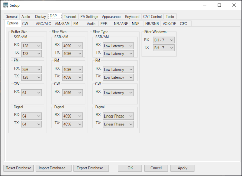

Here's a screen shot of the DSP->Options screen when I don't hear it.
I've noticed this whether feeding audio via VAC or via the "analog" path through the line input. This is a 7000DLE MKII with Thetis and 2.0.0b firmware I believe but has been something I've noticed with multiple combinations of software and firmware.
A "jangling" artifact on TX and RX audio, related to filter size?

Thanks Scott, I was kind of grabbing params until I didn’t hear it anymore. I’ll check tomorrow by putting the buffer size back to 64.
I was initially at buffer 64 , size 8192, low latency and the 7 filter when someone pointed it out on my TX audio...and I had been noticing it in my recordings while setting my audio up.
I basically changed the size as shown in the screen shot and it either went away or lowered enough so as not to be very prominent. I’ll see if the buffer size makes any audible effect I can notice.

Yup, just tested it this morning. NR2 has no effect. Buffer size didn't change it either. The filter size is where it was with the combo of the low-latency option. At 4096 it's so minimized, nearly gone, 8192 it becomes more prevalent again. So easy enough just run it at 4096 for me and it works well enough.
