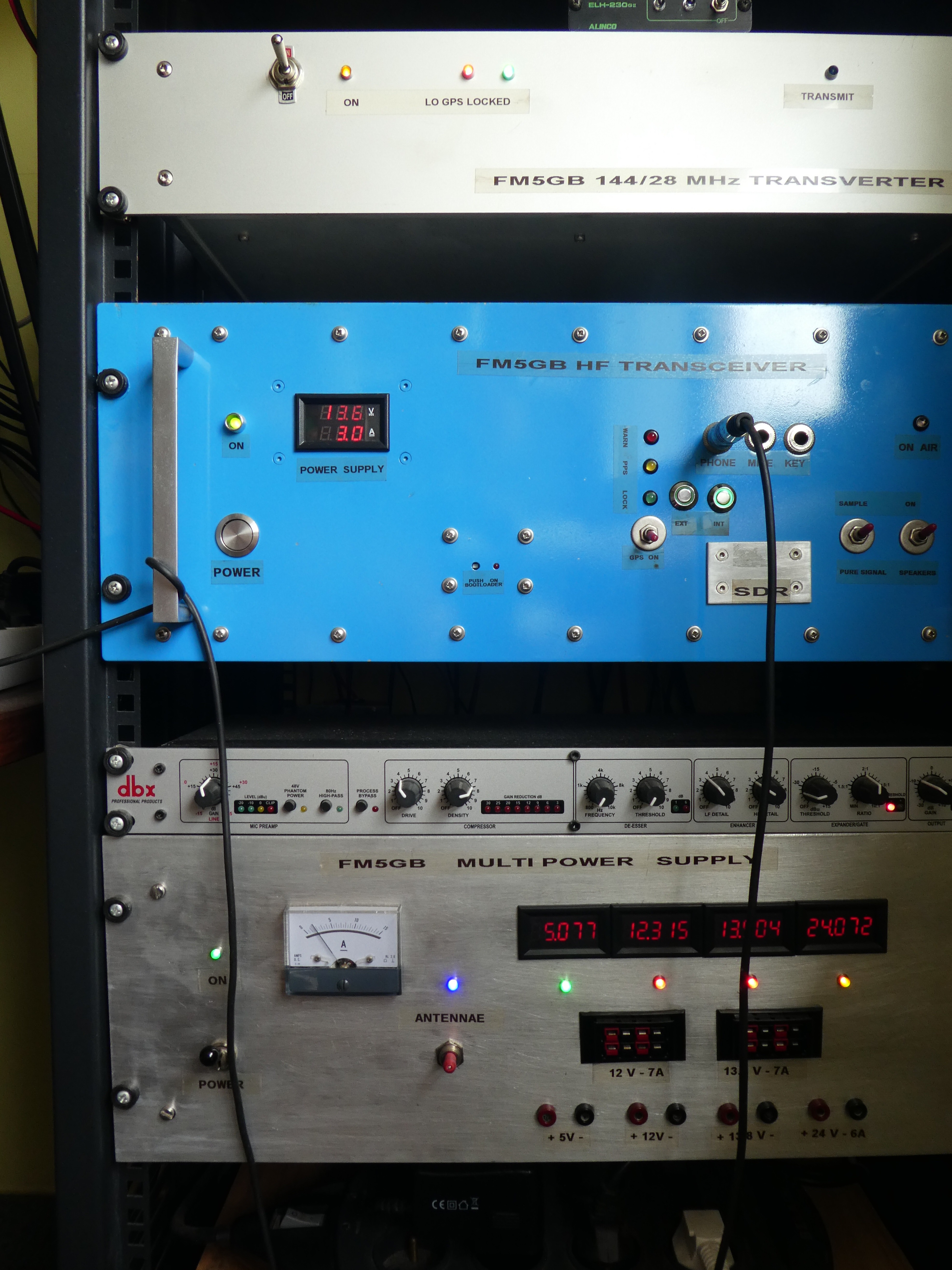

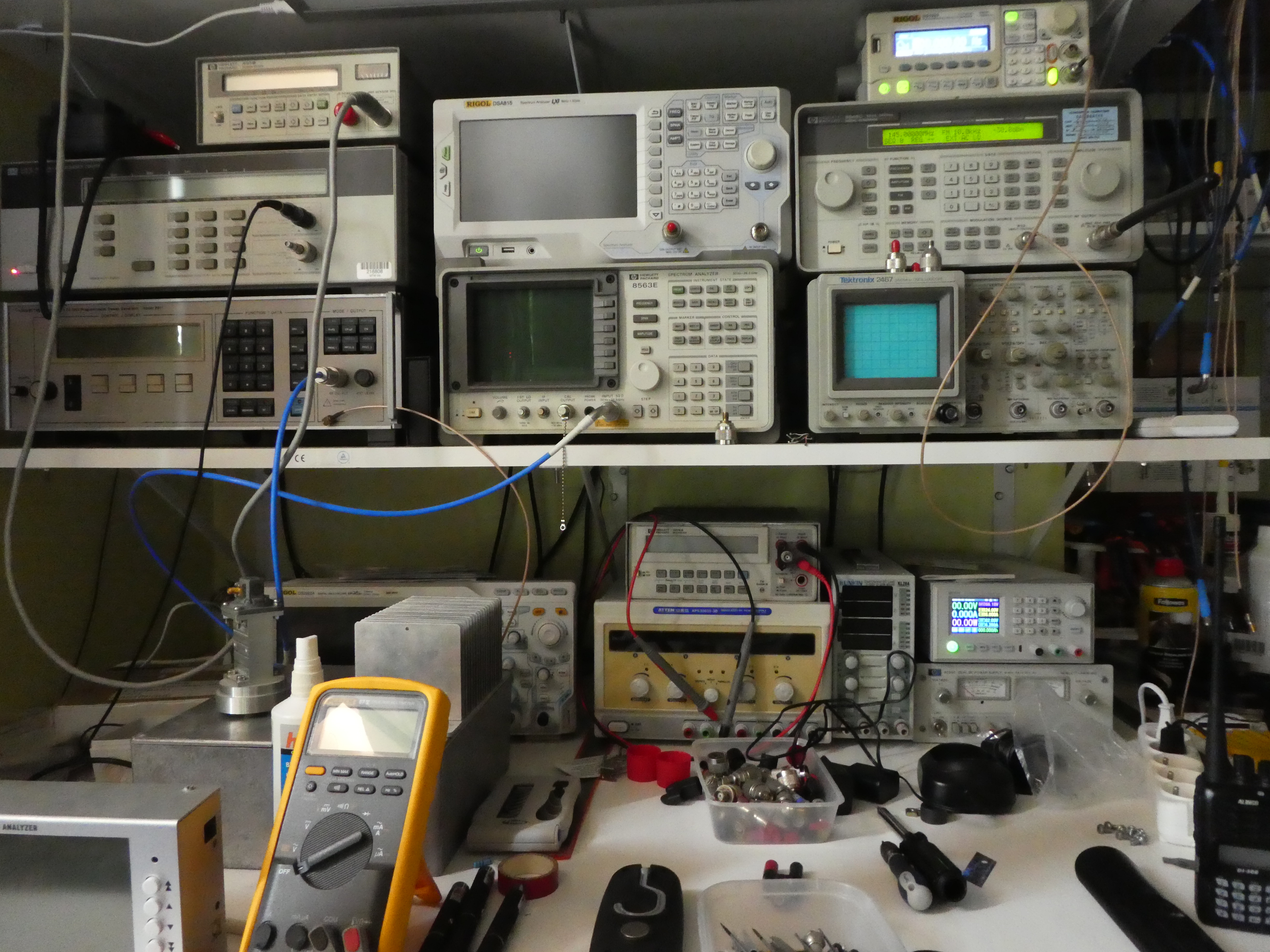

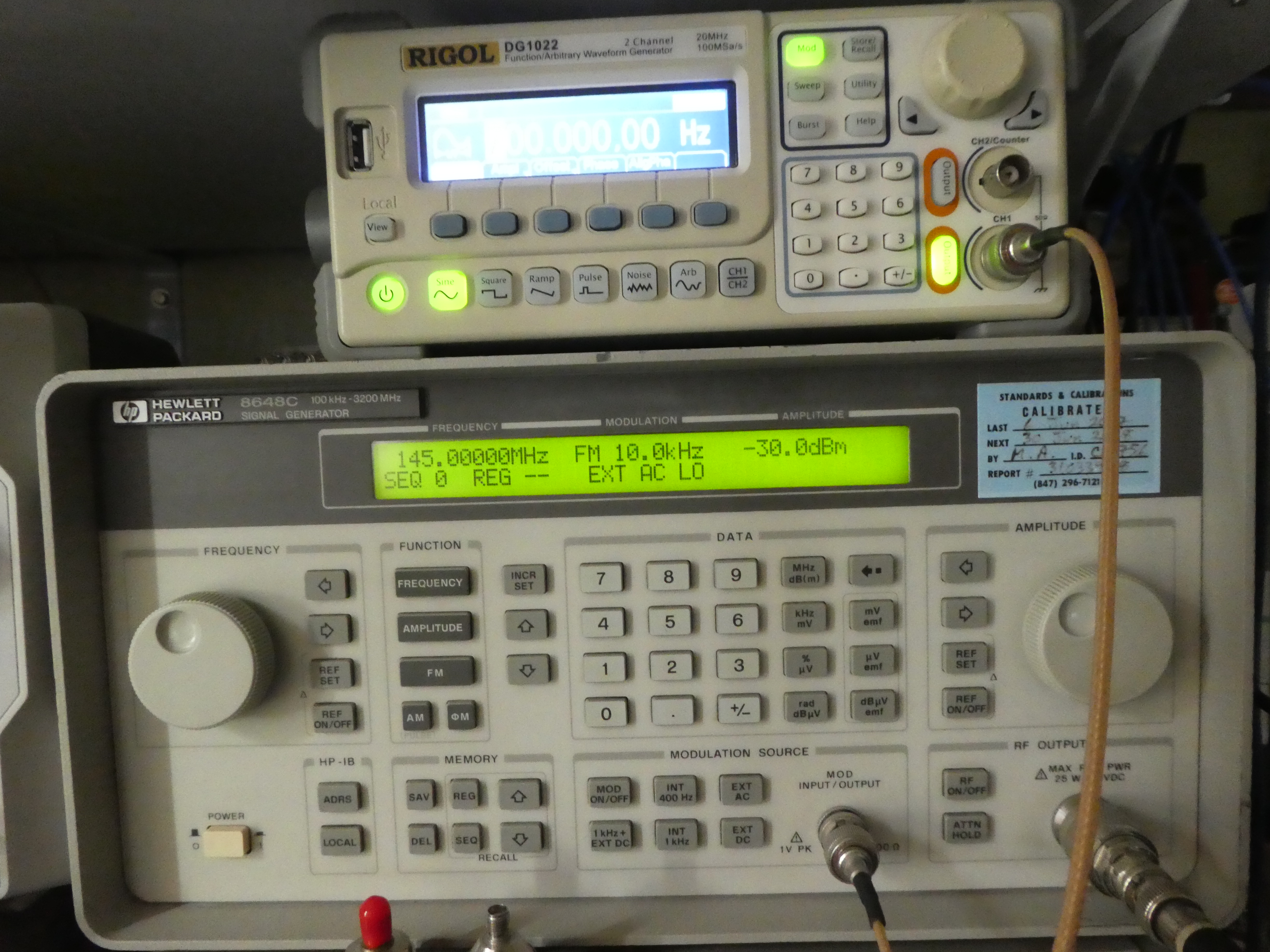

See my test setup below.
73s Phil FM5GB
73s Phil FM5GB

Re: Audio popping on strong SSB signal
Very nice lab setup, Phil.
Did you try adjusting the Ethernet advanced settings? I'm still thinking it's a network issue stemming either from the NIC/driver and its settings, or a Win10 issue other than those registry settings. Did the situation get worse after the Win10 20H2 update? Several people saw a dramatic worsening at that point.
As you noted, it's strange that your CPU usage goes higher on FM by a factor of 2. I don't see this happening in my setup. I also don't see a doubling of processor load when RX2 is on, although I've heard from others that dropouts increase when they are present.
Just a shot in the dark question: What do you have selected for Process Priority in the General-Options tab in Thetis Setup? Mine is set to "Above Normal"
Sorry but I'm at a loss to explain the problem you're having, Phil. Hopefully others might chime in here to offer suggestions. Maybe someone using a transverter (I don't have one to try), although I don't know why using a one would matter.

When I decrease Sample Rate to 192000 or lower all trouble is gone. I had noted that long before. Then I increase SR gradually up to 1536000 while monitoring an FM modulated signal on 145.000 MHz (audio 700 Hz in 1 second pulses FM déviation 10 kHz). I also watch closely the frame drop red light.
Why FM, why 145 MHz , why 1536000 SR ? Because I use my home built transverter to monitor the 2 m FM band. FM is also the mode which produces most processor load (50% that's 1.5 times compared to SSB & CW).
Troubles show up at 758000 SR with some frame drop and very little audio cracks when opening an internet page or lauching a third party software (HRD with Log, KiCad etc). At 758000 SR these dropouts cause little trouble but on max SR and panafall width things become annoying. On SSB and CW there is practically no trouble. and on these mode I don't need the wide band monitoring.
I reduced somewhat (significantly) the trouble by putting the buffer Size in FM to the maximum of 1024 in Setup DSP Options.
I'm reluctant to go back to protocol 1 and PowerSDR as this combination does not meet my needs.
Thanks for your patience and 73s Phil
