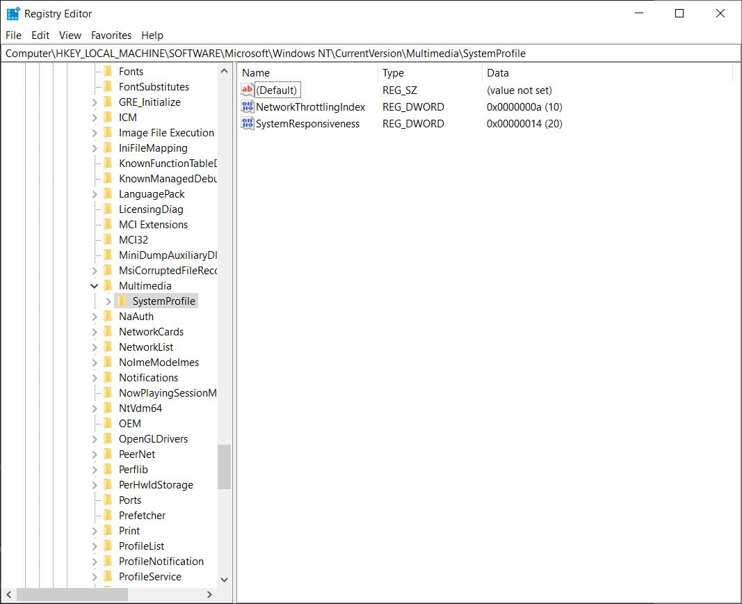

I'm not using VAC but analog audio instead. Will these registry tweaks still help?
Also, here is what I see in the registry where you said to go. As you can see in SystemProfile I see REG_DWORD, not DWORD 32. The DATA value is showing 0x0000000a (10). What should I change it to? I'm not real comfortable in the registry so detailed help would be appreciated.
Thx
Carl

cLicari wrote:I'm not using VAC but analog audio instead. Will these registry tweaks still help?
Thx
Carl
NX5T
[img]DWORD.JPG[/img]
The registry tweak dissables bandwith throttling so it can help you if your problem is due to bandwith issues. In my system the issue appeared after W10 2004 or 20H2 updates.
Forget about DWORD 32, it is just the type you should choose when creating the registry if it is not present.
In your case:
1) Make a Windows restoration point
2) Just "double click" in "NetworkThrottilingIndex" and change its value to ffffffff
3) Reboot and test
If it doesn't help, proceed with step #2 and so on...
If none helps, reset the values to the previous ones or just use your restoration point to go back.

Post by W4WT »
After doing some research on the Network Throttling Index I think it might be good if you were to create a "sticky" either under Thetis or Protocol 2 suggesting that the "Network Throttling Index" should be changed to "FFFFFFFF" from its default IF you are running Thetis with Protocol 2 firmware. The reason for this is due to the stated intention by Microsoft of the network throttling index which is:
"By default, Windows implements a network throttling mechanism to restrict the processing of non-multimedia network traffic to 10 packets per millisecond ( a bit over 100 Mbits/second)."
Obviously throttling non-multimedia traffic over 100 Mbits/second directly affects Thetis running on Protocol 2 since this runs at 1 gigabit. Thetis running on Protocol 1 shouldn't be affected nor would OpenHPSDR running on Protocol 1 as they both run at 100 Mbits/second.
I don't know how Microsoft detects "Multimedia" traffic vs. non-Multimedia traffic. Perhaps its possible to designate our UDP traffic as Multimedia traffic and get around the throttling that way. This would probably be the best action, if possible, so registry modification isn't necessary. Perhaps someone more experienced in network traffic than I am will know how Microsoft determines this. I assume it would need to be in the packet payload.
Joe W4WT
W2PA
Posts: 178
Location: LaGrangeville, NY
Re: How to solve latency problems and VAC under/overflows in Windows 10
Post by W2PA »
I have to echo your observation and suggestion, Joe.
After I made that one single change (step 1 in the referenced procedure by EA3AQR about the NetworkThrottlingIndex registry entry) not only did sequence errors magically disappear but so did all the data drop-outs I was occasionally getting, both upstream and downstream. This applies across the board whether you're using VAC or not (in my case, not, except for digital mode).
Chris, W2PA
Posts: 6135
Joe-W4WT wrote:Scott,
I'll probably do that, since this change has helped several people. However, it is by no means a definitive fix for everyone. I suspect that the specific NIC and NIC driver may make a difference as well. For instance, this change has made zero difference in the performance I see on my PC, which was already good without it.
This is demonstrably false. Without making this change you can easily demonstrate rates well in excess of 100Mbit/s for file transfer, speed testing, using tools like iPerf, etc. I'm hardwired to my both my NAS and my router. I see rates well over 500Mbit/s to my NAS, and with 300Mbit/s internet service, well over 100Mbit/s for internet downloads.
I Google searched this statement and only found it repeated endlessly in a series of gamer forums with no attribution to any Microsoft references.
It's also worth mentioning that with RX1 and RX2 both activated and both running 768KHz, total network utilization is below 100Mbit/s as reported by the Windows ResMon tool.

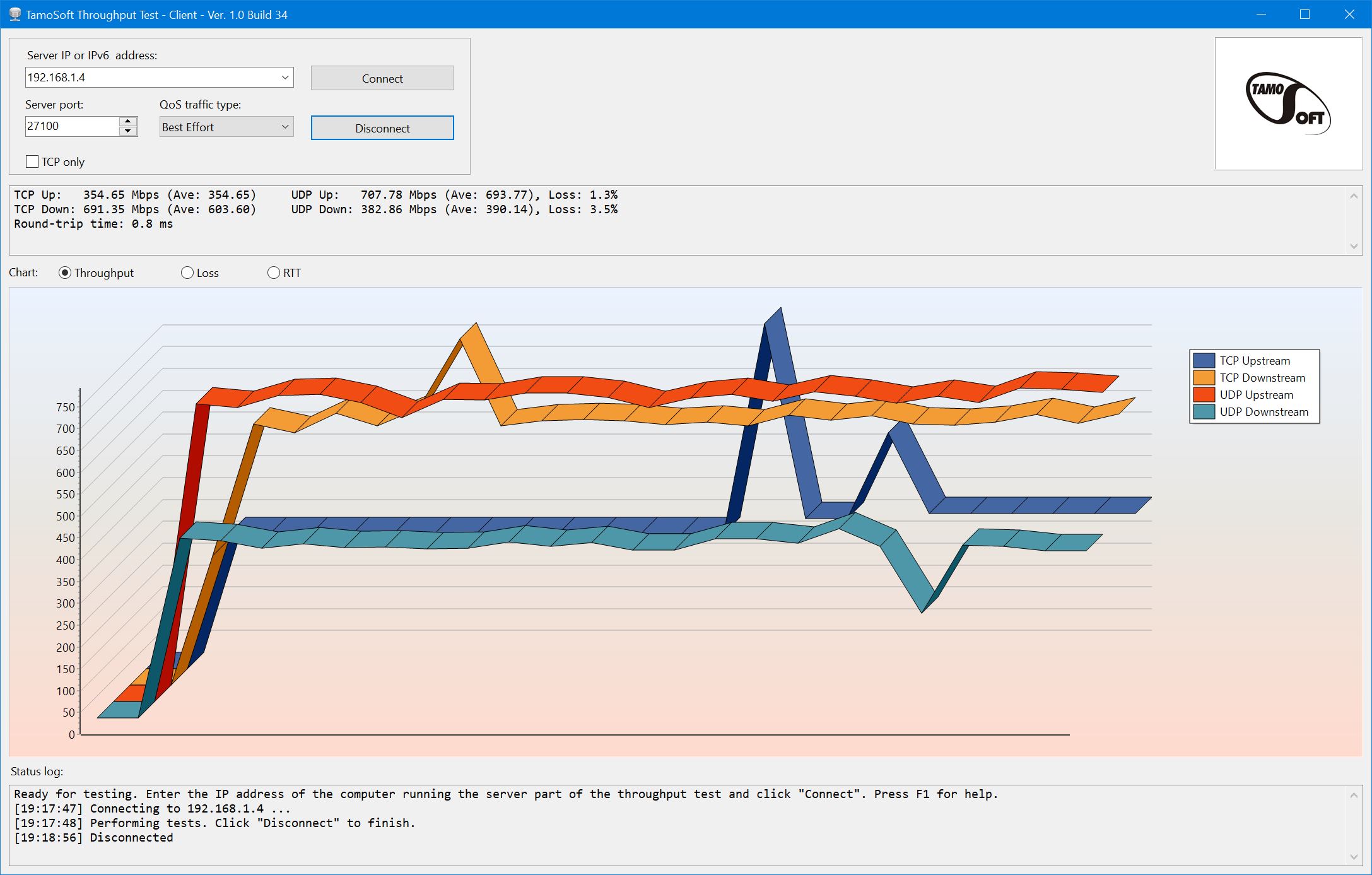

Posts: 6135
I'm sorry, Joe, but it's still demonstrably false that any traffic, UDP or TCP, is limited to 100Mbit/s. Here are two tests I just performed. The first is with network throttling set to FFFFFFFF, which happens to be where I last left it. Then I set the network throttling back to 0000000a and rebooted and performed the second test pictured. The Tamosoft server was on my not-particularly-fast laptop that was hardwired to the network. The connection was through my Ethernet switch. I suspect the laptop server was the limiting factor. It also is running the default, Windows 10 Pro network throttling setting.
I also played with the various QoS traffic type settings in the Tamosoft tool but did not see any performance changes that were significantly different. I sincerely doubt that either Thetis or the firmware does any QoS marking of the UDP traffic, but again no matter what type of traffic I selected in the Tamosoft tool it made little practical difference.
I only ran these tests for a about a minute, the stat's will really settle down if you run a longer test. But the point that network throttling in any way restricts average data rates is clearly false. That said, data rates did seem smoother and less variable with FFFFFFFF. So maybe there is something to be said for that. It needs a more careful study. But on my machine it can clearly keep up, well above the 50 to 100Mbit/s required by Thetis, even with a crappy old laptop as a server, so perhaps that's why I'm not noticing a difference.
If you have another PC you can use as the Tamosoft server I'd encourage you to try these experiments yourself.
Test #1--Network Throttling FFFFFFFF
Throughput Test Network Throttling FFFFFFFF.JPG (287.82 KiB) Viewed 32018 times
Test #2--Network Throttling 0000000a
Througput Test Network Throttlling 0000000a.JPG (290.36 KiB) Viewed 32018 times
