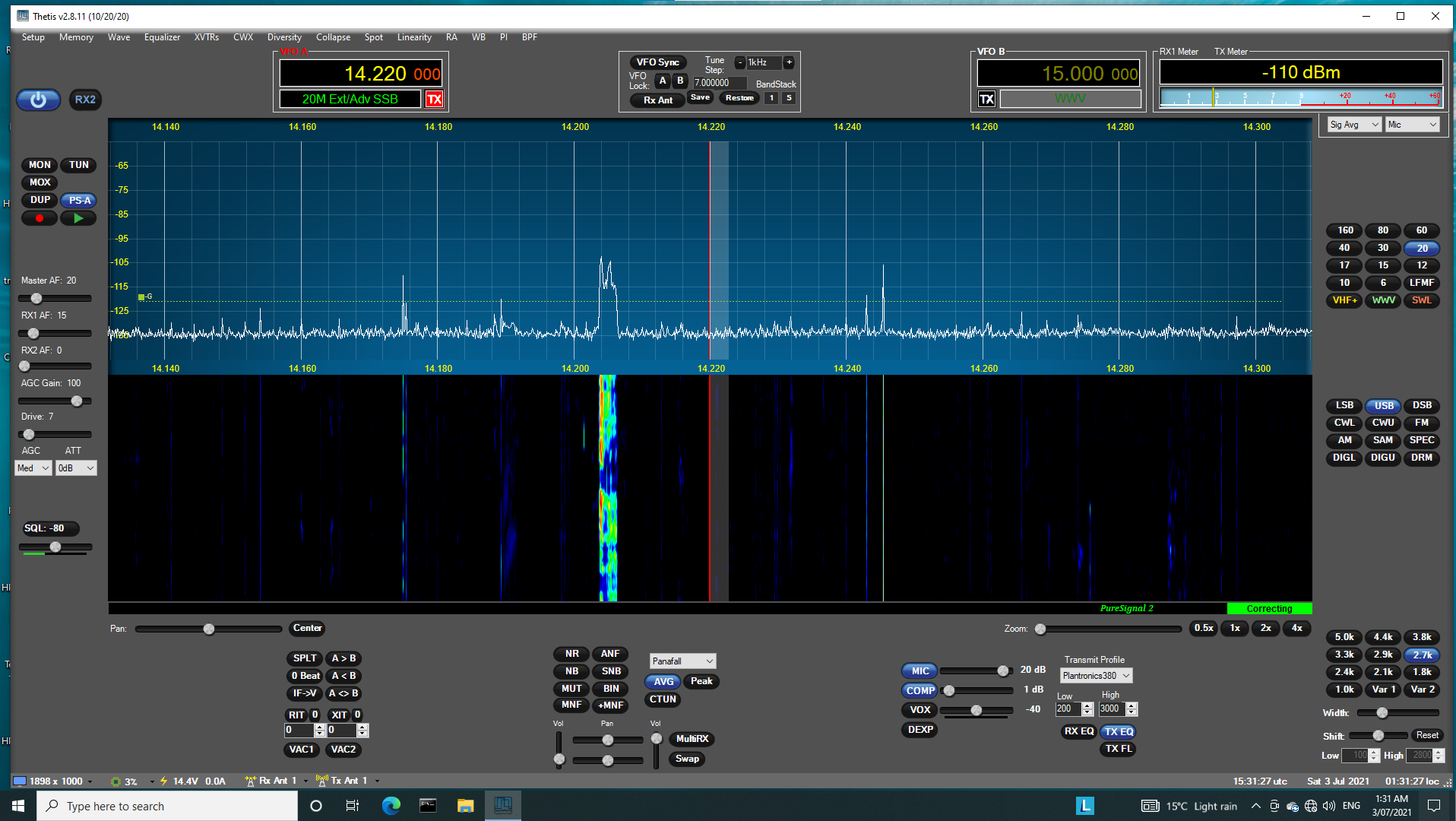

Attached are screen shots showing the difference between the LCD and LED monitors tried so far.
In addition to the HP and Dell monitors mentioned I tried friends LG29UM67-P and Samsung SE790C , these are similar or verse than the Dell shown in the screen shot.
Clamp on ferrite's have not helped.
Andrew

AndrewK wrote:Ruben, thanks for the model number.
Andrew
Hello Andrew,
Wow big difference between the top and bottom monitor. Were these shots made close together? I pick up a good bit of noise on 20 meters also. That is the only band I see these lines on. I have seen shots of others on 20 meters and all of them contain those noise lines on 20 meters. The on you have there is the first I have seen without them.

Hi Ruben, screen shots were taken close together, 20m and 10m seem to be the most affected.
So far between my self and a friend have tried 6 LED monitors all have the problem on 20m, this is why I ask for specific models that are clean otherwise buying anything is pure pot luck and most likely will be disappointed.
