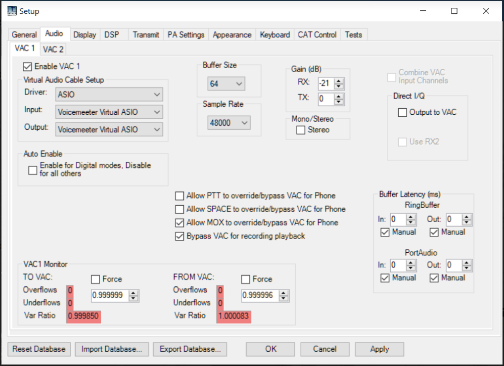

WU1T wrote:Delivery of my 7000DLE MKII is imminent. I have a Motu M4 USB audio interface and a Warm Audio condenser mic. The PC I will be using already has a paid version of Virtual Audio Cable (NOT the VB-Audio virtual audio cable). Does anyone know if Potato will work with Eugene Muzychenko's Virtual Audio Cable?
Thetis itself doesn't need any external VAC to connect with Potato. Thetis can directly access Potato's Virtual ASIO channel.
I'm also using a MOTU M4, here's my Audio VAC1 screen in Thetis:
WU1T
Posts: 32
Joined: Mon May 10, 2021 7:01 pm
Location: Massachusetts
Re: Compatibility of versions of Thetis and Radios
Post by WU1T »
Thanks Mark, that screenshot will come in handy for me.
