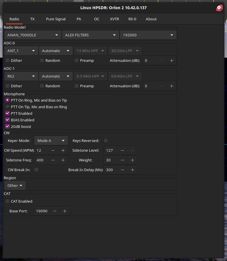

Running Linhpsdr v0.7-beta). Radio is an ANan 7000DLE Mk2.
I can only get about 65-66 watts output on my peak reading meter. I've tried maxing out Mic level and Mic gain, no change. I get full output with Thetis on Win10.
Mic settings are:
When driving my amplifier it's ok but if I want to run barefoot ......
Any ideas?
David KO1C

The first thing I noticed is that you have both 20dB boost AND bias enabled. This is probably wrong. Condenser (electret) mic's require bias but not boost. Dynamic mic's require boost but not bias. You should almost certainly not be using both at the same time unless you've got a very strange microphone. What microphone are you using?

The mic is a Heil PR781G (Dynamic). I unchecked the bias.
