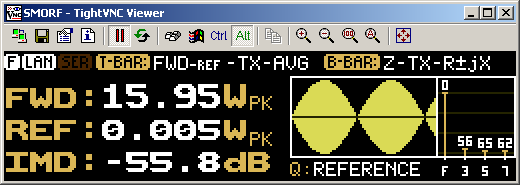

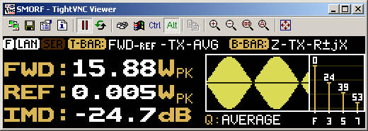

No LP-500 but a Microham SMORF.
It can measure IMD quite good, along with many other things.
Smorf PS On.png (6.77 KiB) Viewed 4768 times
Smorf PS Off.png (6.79 KiB) Viewed 4768 times
73 Walter
