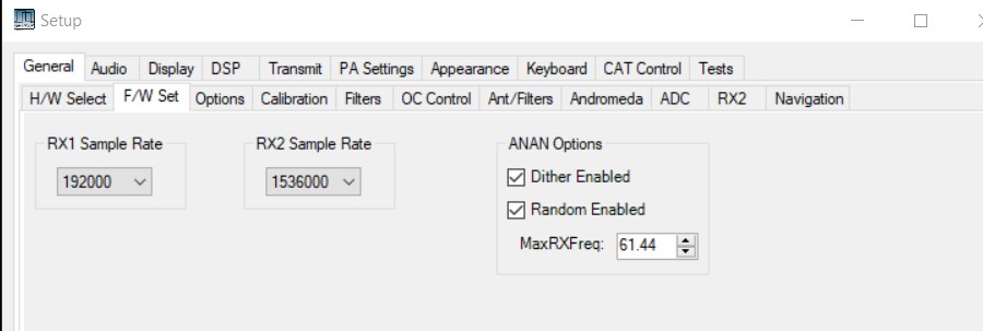

Just curious, do you have Dither enabled?
Screenshot 2021-10-19 073332.PNG.jpg (36.66 KiB) Viewed 23505 times

Hi Gary,
Neither "Dither" or "Random" is enabled.

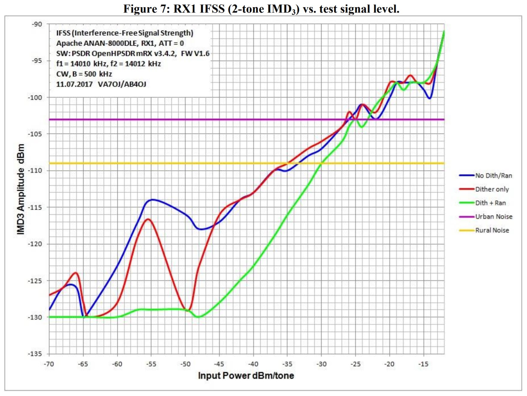

Posted: Tue Oct 19, 2021 2:13 pm
You always want dither and random turned on. Those are the defaults for a fresh Thetis installation. Here's more information on why this is so:
https://apache-labs.com/community/viewt ... 736&p=5026

w-u-2-o wrote:You always want dither and random turned on. Those are the defaults for a fresh Thetis installation.
FYI Scott, I did a complete fresh install the other day for the fun of it. Dither and Random were off by default when I did my install.

by HB9LFQ
yes dither and random are turned on as with the older Thetis/Firmware.

Thanks Gary (and Scott)! Will do some reading.
I enabled both "Dither" and "Random" today. We'll see.

I2NOY wrote:From Sherwood's opinion, on SDR radios ADC dither and random ON make difference only on a lab measure and it is better to leave them normally OFF on the field (better sensitivity).
The chart in Scott's link suggests otherwise..
Re: ADC1 overload when monitoring on ANAN 7000 DLE MKII
Posted: Thu Oct 21, 2021 12:17 pm
Yes, just as Mark writes, take a look at the link both Gary and I posted almost simultaneously (but he did beat me by a few minutes :D )
First and foremost, the Orion MK II SDR board in the 7000 and 8000 series hardware was specifically designed to avoid any degradation in noise floor or sensitivity with dither and random activated. Indeed, if you look at the famous (infamous to some!) Sherwood receiver test data tabulation, you'll see no difference in sensitivity on the 7000 Rob tested. So this is a non-issue on most of our radios, and degradation is very small, maybe 2dB on the older ANAN designs.
I have not seen where Rob mentioned his preference for having dither and random turned off. As far as I know there's no option for this on Flex radios. Perhaps his comments stem from the degradation seen in the ICOM direct sampling radios (7300, 7610) when the IP+ function is activated. IP+ is a fancy marketing term for dither and random in those radios.
Nevertheless, as the link Gary, Mark and I are all referencing discusses, for all but the quietest environments the difference in sensitivity is going to be unnoticeable. Looking at the degradation on the Icom radios that Rob measured, unless you are truly (and we know Icom S meters are anything but "true") seeing an S3 or lower noise floor, you'll never notice the loss of sensitivity.
At any rate, it is a user controllable setting. If you are on an uncrowded, unnoisy band and you are looking for that 2dB on your 200D, or the 6dB on your 7300, by all means turn those settings off. If you are in a busy FT8 band, or in a contest, you might want it on! And if you are using Orion MKII based hardware, there's no need to do anything but leave it on.

by I4LEC
For the sake of clarification, is worth recall also Phil's (VK6PH) words on the subject,
QUOTE
The need to apply dither or not is one that is new to all of us as we transition from conventional, mixer based, analogue radios to Direct Digital Conversion techniques.
With an analogue radio we understood that we needed to prevent large numbers of strong signals for reaching the mixers. With DDC, as long as the sum of the signals does not overload the ADC, then the ADC can actually perform better than in the absence of such signals.
In theory enabling dither should not increase the noise floor. In practice it can and there are a number of factors, including PCB layout, that causes this. We have learnt some of these techniques over the years and the latest Orion MkII board represents the best we have been able to achieve.
For lab testing, where you are using one or more signal generators, then applying dither does have a positive effect. In real life, with antenna noise at least 10dB above the no antenna noise and other signals on or adjacent to where you are operating then you are not going to see any improvements.
I actually did a demonstration to one of our well know reviewers where in the lab the 6m IMD3 at low signal levels was rather poor. By adding my HF antenna and summing in all the signals from MW to 10m the IMD3 was world class.
If you are fortunate enough to live in a quiet location and very little antenna noise then dither can have a positive effect, for most of us it will never be required.
UNQUOTE
Given the above, the presentl OFF default of both dither & random noise seems appropriate to me.
