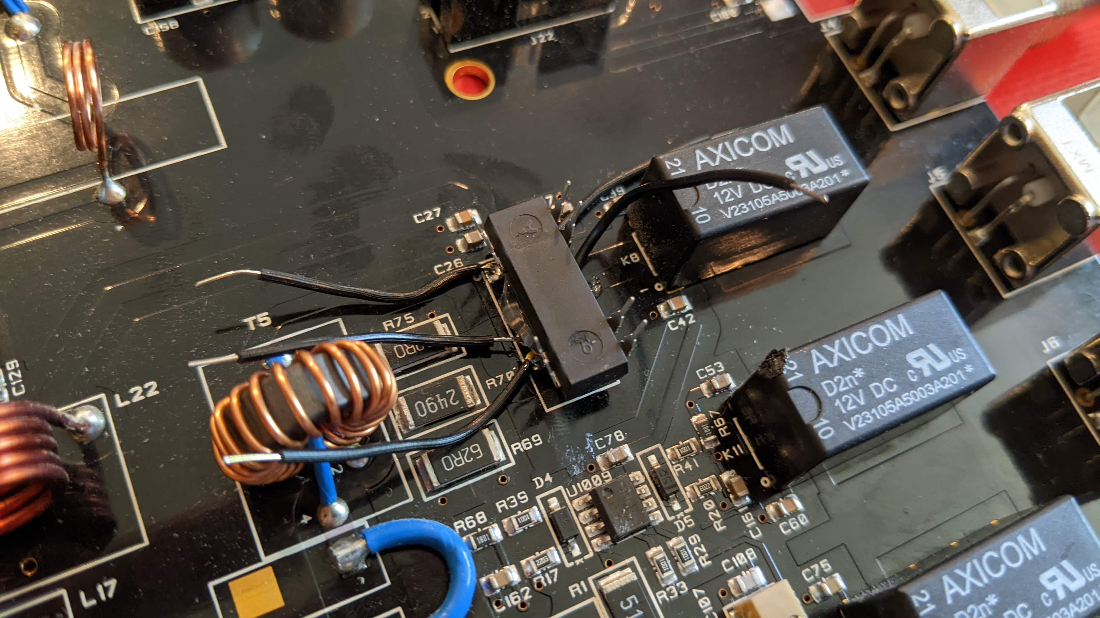

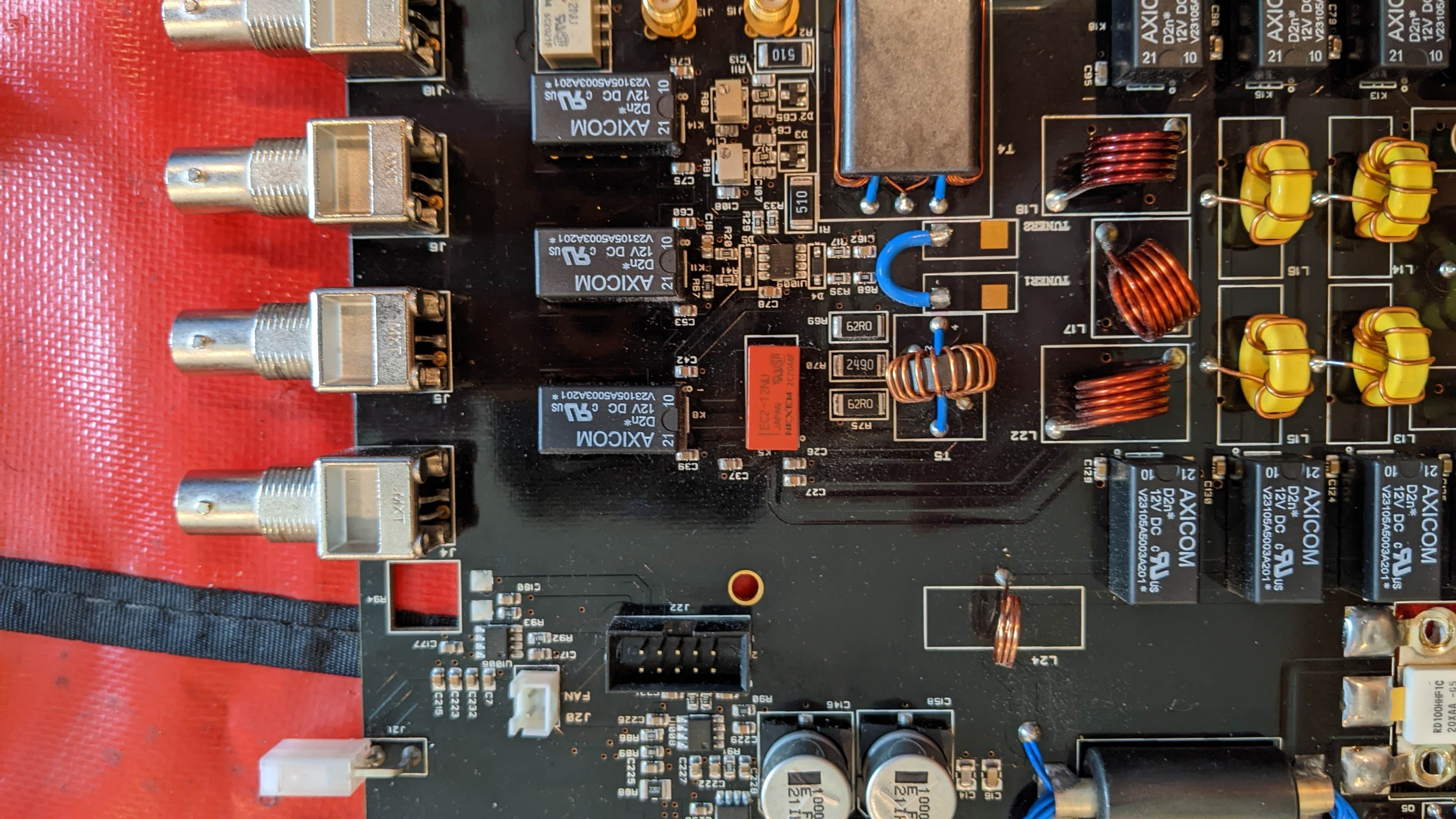

I successfully implemented the W9AC modification for QSK on my 7000DLE MKII which involves replacing K5 on the PA Board with a reed relay and installing a circuit board that opens up the relay coil lines to RL17 and RL19. It appears the relay suggested by W9AC is out of production or not in stock so I used an alternate - AXICOM V23100V4312C000.
I decided to cut the trace from pin1 on both RL17 and RL19 to their bypass capacitors and solder lines from the W9AC circuit to the pads on each side of the cut trace.
QSK CW operation is now totally silent. The only way I can tell if I'm transmitting is to look at the power output on my wattmeter. I've made several QSOs and the rig is a pleasure to use on CW.

I've got photos of the 7000 disassembly but then I forgot to take pics of the installed board and the new relay.
Re: Thetis QSK Delayed Sidetone
Posted: Tue Jul 05, 2022 11:47 am
by W4ATL
I went back and looked at my pics and I did take a picture of the new relay. It is mounted upside down with some silicone RTV. Wires run from the pads of the old relay to the pins of the new reed relay.
Old relay (Orange).
New Reed Relay mounted upside down and before I soldered them to the pins.

W4ATL wrote:I went back and looked at my pics and I did take a picture of the new relay. It is mounted upside down with some silicone RTV. Wires run from the pads of the old relay to the pins of the new reed relay.
Well done. As W4ATL described, there's zero mechanical relay noise after the mod; it's as quiet as PIN diode switching. I have several QSK amplifiers including Alpha 87A and 89 models, but what gets used most is an SPE 1K-FA model with a PIN diode modification. All Thetis keying delays are set to zero with no hot-switching.
Future Apache Labs products should isolate the T/R relay coil from all others. By current design, the T/R coil is shared with the PureSignal function, thus unnecessarily activating PureSignal relays when transmitting in CW mode. Moreover, the T/R relay could easily be shock-mounted in production. Ten Tec did with the Omni 7, so could Apache Labs.
Posted: Tue Jul 05, 2022 8:56 pm
by dl4zbg
Thanks for the fotos. With these kind of relays I managed to switch 5 watts on 144MHz. I would not dare to use them for 100 watts. What do you think how long they will survive?
