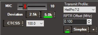

just change mode to FM and then you see the options where you can configure repeater offset etc.
The config you see is for the HB9HD repeater on 29650, no ctcss, -100 kHz offset. You can program this in a memory as well.

Thanks a lot for the answer that turned out to be a sign of my being lazy :lol: . I should have just changed the mode to FM. I suppose I was thinking about how to set the deviation and so forth, but I assume that this, too, will be “self-evident” once I have the common-sense of switching into FM mode :lol: .
