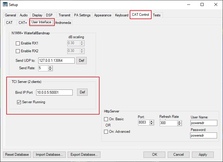

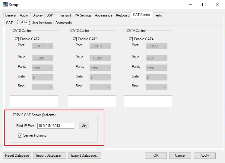

2. I can not get TunerReminder to connect but I can get Log4OM to work, but not using the TCI, it will not work. But if I setup the HamLib tab as a "Network connected radio" and RIG as OpenHPSDR it connects fine via the Thetis TCP/IP server. Anyone get TunerReminder to work?
TCPIP/CAT is configured via Setup > CAT Control > CAT+ (bottom section)
TCI is configured via Setup > CAT Control > User Interface (bottom left section)

But for TCI for TunerReminder, Log4OM, etc.. you need this:w9mdb wrote:I don't see any TCP CAT control setup in CAT+
Just CAT2 CAT3 CAT4.
If you run Thetis and Log4OM/TunerReminder on the same machine, please use 127.0.0.1 as ip-address, otherwise, some firewalls may also be in the game.
https://www.oe3ide.com

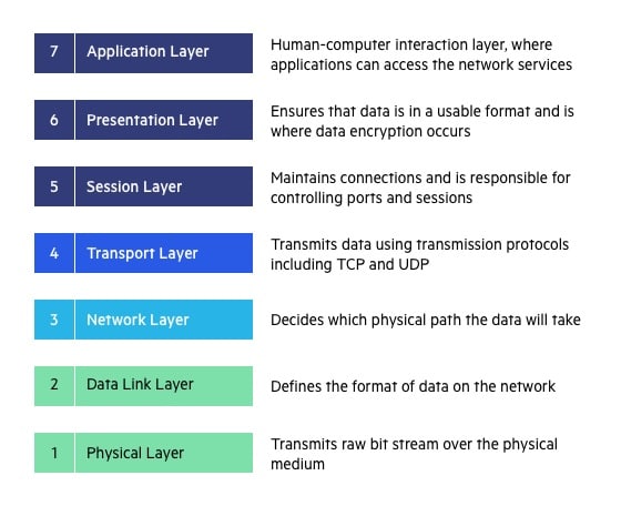

As more people check into this particular topic, perhaps the following will be helpful
It is very easy to conflate all of this TCP/IP/CAT/TCI stuff. To help sort it out, be mindful of the OSI Layer Model for communications:
Layers 1 through 5 correspond to either serial communications or TCP/IP.
Layers 6 through 7 correspond to either CAT or TCI.
Some of these lines do blur a little in Layers 4 and 5, but let's not confuse ourselves with that minutia.
Currently CAT is available over both serial and TCP/IP. CAT works the same regardless of how the messages are carried, i.e. carrier pigeon (serial) or jet fighter (TCP/IP)
