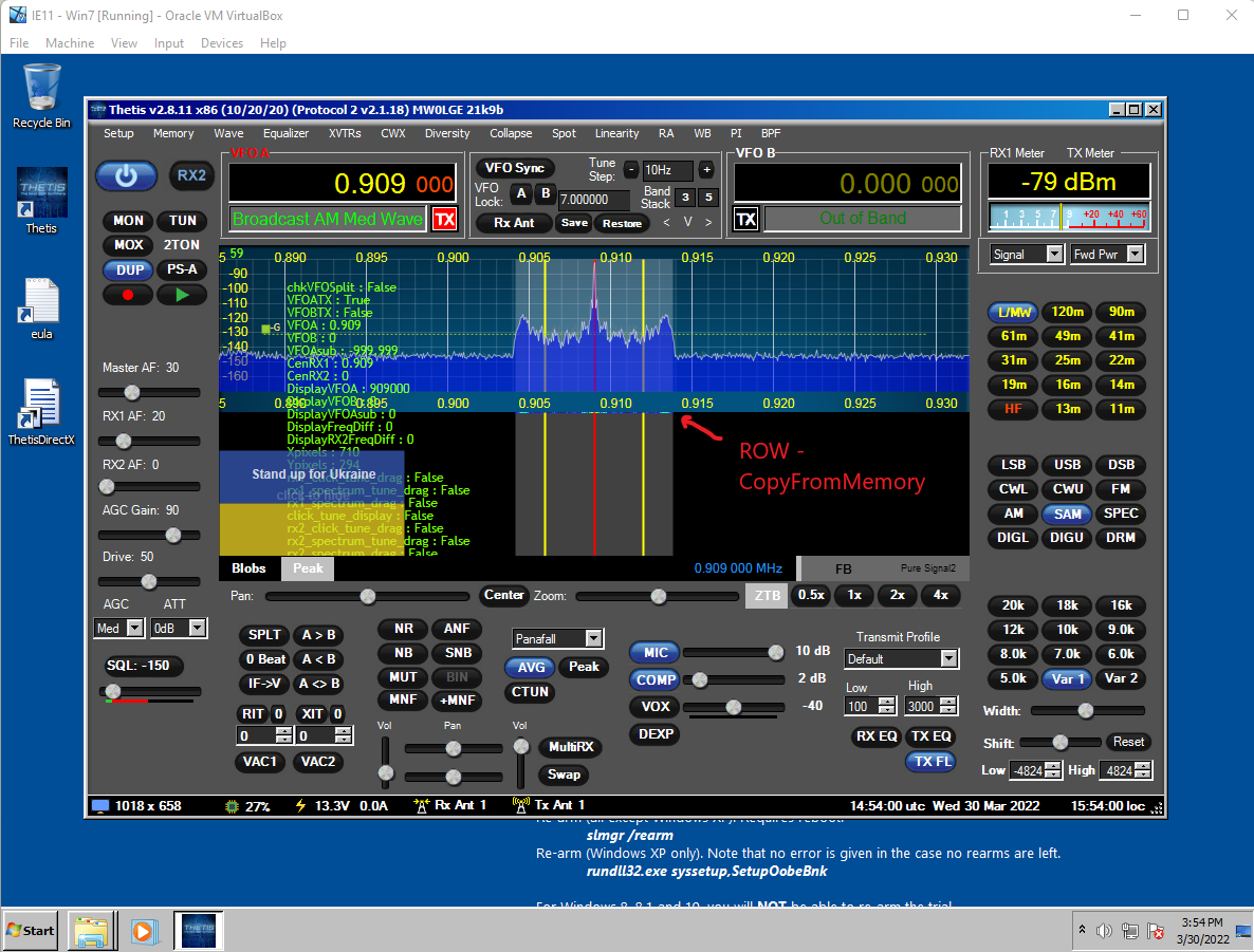

I have done some testing, and the vitrualbox 3d driver (which is experimental) is ok with the vector/line stuff, but is failing with the bitmap creation used for the waterfall. It might be because I use a premultiplied alpha, not sure. Another issue is that using the directX debug flags also cause the virtualbox driver to to error possibly because they have not implemented it yet, who knows.
Re: No Panadapter Display after 21k9 Update
Posted: Wed Mar 30, 2022 3:04 pm
Thanks for your reply. Yes, Guest Additions are enabled, using Safe Mode and the 3D extensions are installed. Many things in Virtualbox are labelled "experimental" but work just fine.
That said, the primary difference between the Virtualbox VM dxdiag output is: AGP Texture Acceleration: Not Available
It looks like the experimental part of this, is non working experimental :D The lack of AGP Texture Acceleration will not matter.
After many hours of looking into this, it seems that DirectX function ID2D1Bitmap::CopyFromBitmap is either not supported or is broken in the VirtualBox video driver. CopyFromMemory works which is used for the new row in the waterfall as can be seen in the image.
In other words, this is not going to work until they get around to fixing/completing their graphics driver.

yes, but that profiler makes no use of the CopyFromBitmap function. I too have run it here which is why I posted 'is ok with the vector/line stuff' previously. VBox directX support It is just far to experimental it seems and not being able to use the debug flag is :shock:
