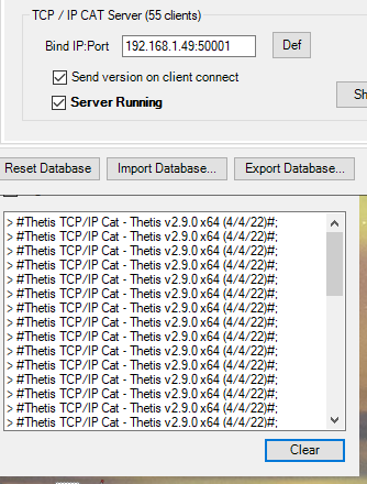

Ernie wrote: 127.0.0.1:13013 and server running.
Just curious, 13013 is the default IP port for TCP/IP (set on CAT tab) and the default port for TCI is 50001 (set on User Interface tab). I originally had this confused when I was setting up, so just wondering if you re using TCP/IP CAT vs TCI CAT?
Posted: Wed Apr 06, 2022 11:50 am
yes good spot Gary.
TCI defaults are 127.0.0.1:50001
TCP/IP CAT defaults are 127.0.0.1:13013
but the TCI bind IP will still need changing to his PC ip, so something like 192.168.0.26:50001, or whatever the RF-Kit is set to

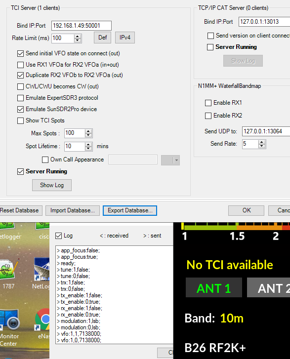

Some slow progress.
Got TCI to bind to PC address, now I get the following;
Amp says "No TCI Available."

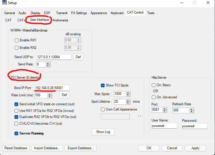

Ernie, that is not TCI, that is TCP/IP-Cat....
You will find the settings on "Setup - CAT Control - User Interface".
tcpip-cat is not tci.jpg (182.57 KiB) Viewed 43454 times

I guess I should have said that UNIV seems to be the default selection. TCI is always shown as 'No TCI available' on amp front panel. I thought the log data was promising as it did shows commands being sent from Thetis.
But, when I change the status in the AMP to TCI, Thetis reacted to this by sending those commands that are shown in the log. So on some level there seems to be communication between the two. If the amp wasn't working at all then changing the amp to TCI should have no effect on what Thetis saw from the amp. So, I'm still not sure where the issue might be, this is all above my head.
Dave

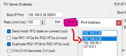

In a future release I will add a button to list all local IPv4 addresses that can be selected from.

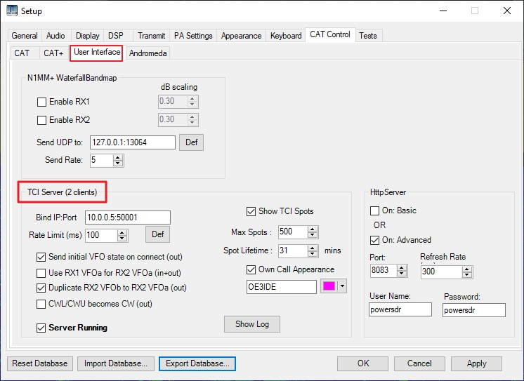

I have both Thetis & RF2K-S amp set to my PC ip and port is 50001. It is configured like Ernest's example picture's.
When cycling thru the CAT setup screen I never get TCI to appear in upper right hand corner of amp as shown in Ernest's amp front panel picture. The message is always 'no TCI available' just above the ANT 1 message.
My Thetis screen looks like Ramdor's example; except I don't have TCI spots checked. And my ip is different.
I did notice something else, the number of clients on my Thetis screen shows 2. One is Log4om & the other is JTDX. When I scroll through the CAT options on the amp when I get to 'no TCI available'; in Thetis the client change's to 3. The 3rd one is the RF2K-s amp. When I scroll past 'no TCI available' the client's change back to 2.
I have no idea why the amp doesn't change to TCI. It always shows UNIV.
It seems Thetis is working, it recognizes the amp by the clients changing to 3. Also the TCI log generates messages when scrolling through the TCI cat setting on the amp.
I'm using my PC ip & port 50001 in both Log4OM & JTDX and they work fine with those settings's. Most of this info has been given to Reinhard on the amp forum, except the client number changing. I just noticed that.

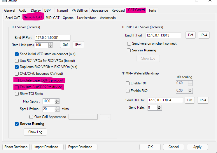

Ernst (oe3ide) tells me he does not have the amp, but included images he found in a manual.
However, there is a pre-release on my gihub which adds options to emulate expert electronics radios. It may help and resolve the issue depending if the amp firmware looks for a specific radio/protocol. Please read the notes there.
https://github.com/ramdor/Thetis-2.9.0/ ... .9.0.4-pre
Note, cat tab has been re-structured in this early release.
