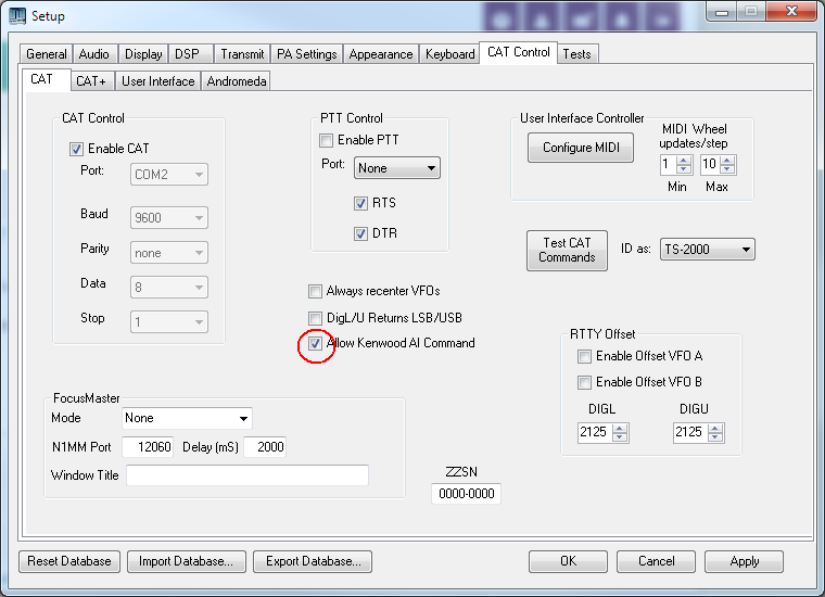

Does this latest version of Thetis have the ability to send out the frequency, perhaps by USB or perhaps by TCP, any time the frequency is changed? If so, what is the format of that?
I want to try to capture it to send to my Elecraft ATU so that it will follow the frequency the Anan is tuned to. I apologize in advance if this has already been answered somewhere.

Yes,
just enable AI.

Excellent. Thank you. Danke.
